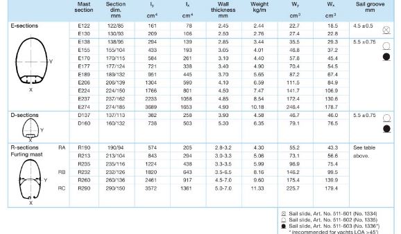

Good point about variability - I guess I either have to make an exploratory hole as suggested or see if Selden has the info - I'll try their site.

Andy,
Rarely are masts free of holes or fixtures. By all means contact Selden.
Perhaps you can remove a fixture on your mast and get an idea with out having to drill another hole.

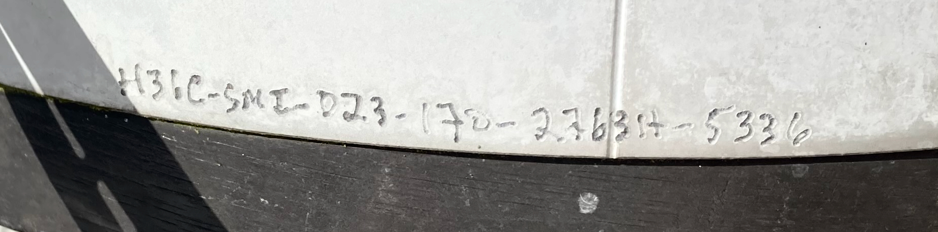

AndyL
Jun 23, 2020
151
Hunter 36 Rock Hall
Thanks. I do have that number but the formatting is not the same and I'm having trouble figuring which is the mast section.
