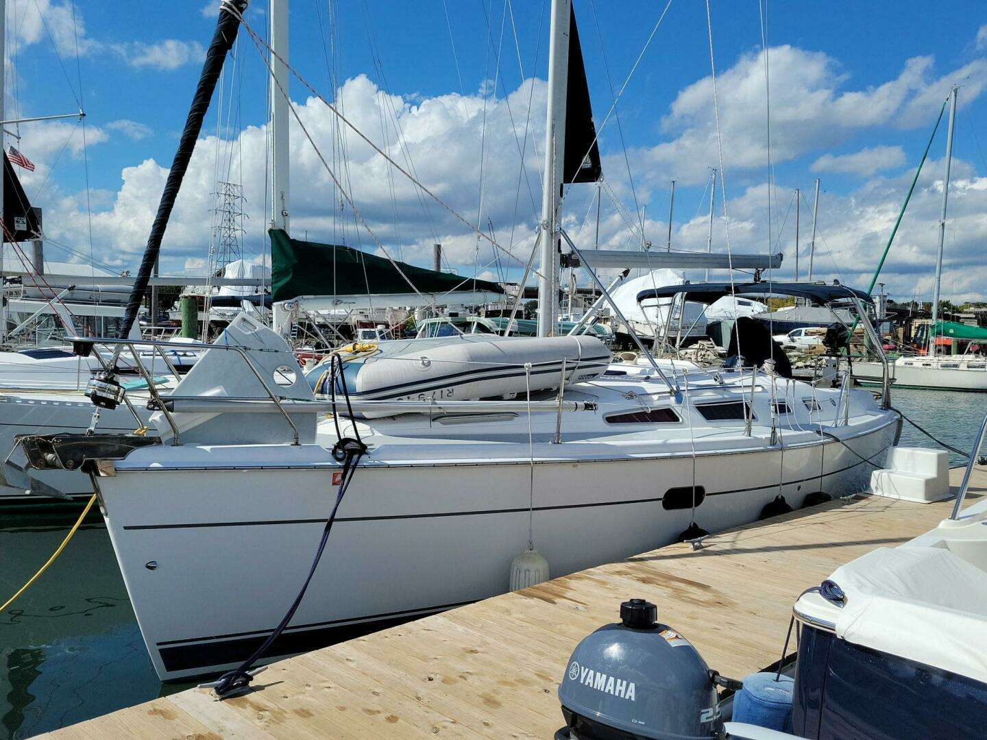

Not sure that would help or even show the problem, but I'll try later. The image below is not our boat but it shows the two metal supports that make a triangle with the mast - one of ours is now got a curve to it.
