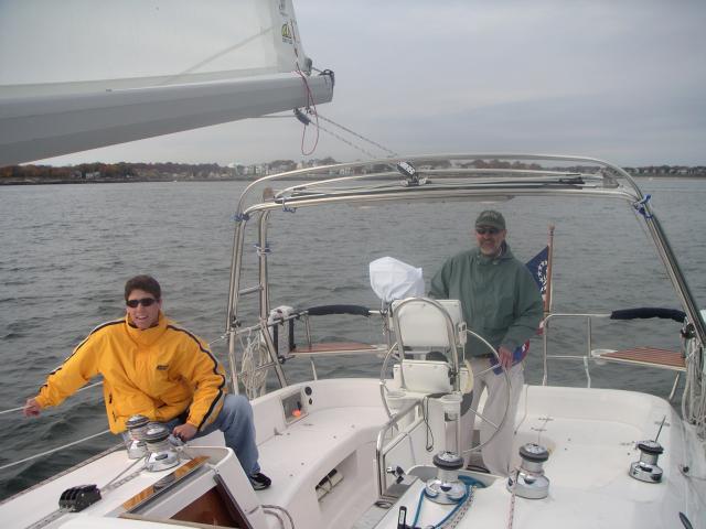

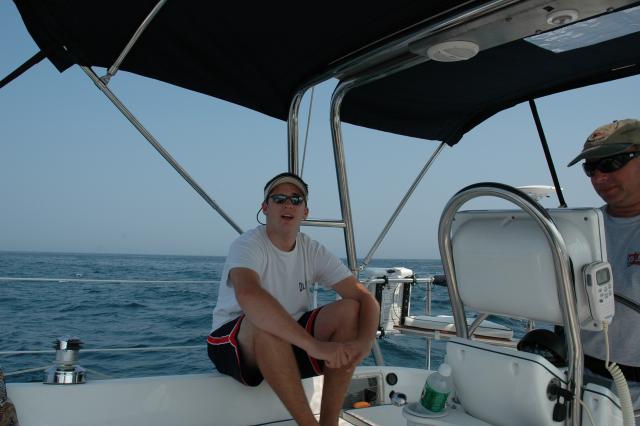

chuckwayne, where and how did you install the spinnaker winches. I do not believe there is a pad already for them. any pics?

Hi Shippy, there isn't a molded pad like on the later boats but the glass is thick and you can easily get to the underside to install bolts with heavy washers or a backing plate. A lewmar st40 fits fine. pictures attached
