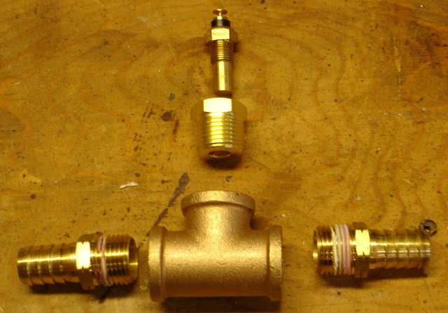

Had the same problem and found this to be the best solution. I will be away for the next month but PM me if you need more info.
http://forums.hunter.sailboatowners.com/showthread.php?p=1179176&highlight=flow switch
http://forums.hunter.sailboatowners.com/showthread.php?p=569977&highlight=flow switch
Thanks this looks perfect!! I need to research this a little. Make sure I buy the right flow detector and gauge. But looks a like a real simple solution. Better then a any temp gauge you know right away there is an issue with this solution.
