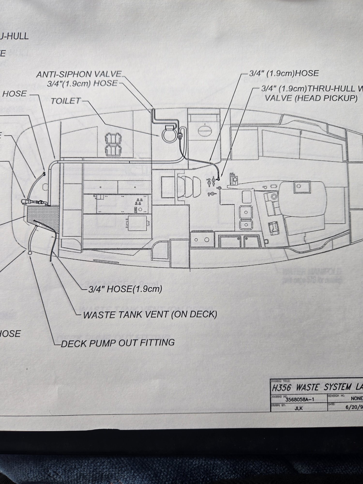

the supply hose goes under the pan into the wet locker , up to a vacuum break then down under the pan to the seacock in the bilge. they are all loose. so you can use a double nipple coupler to pull a new hose thru.

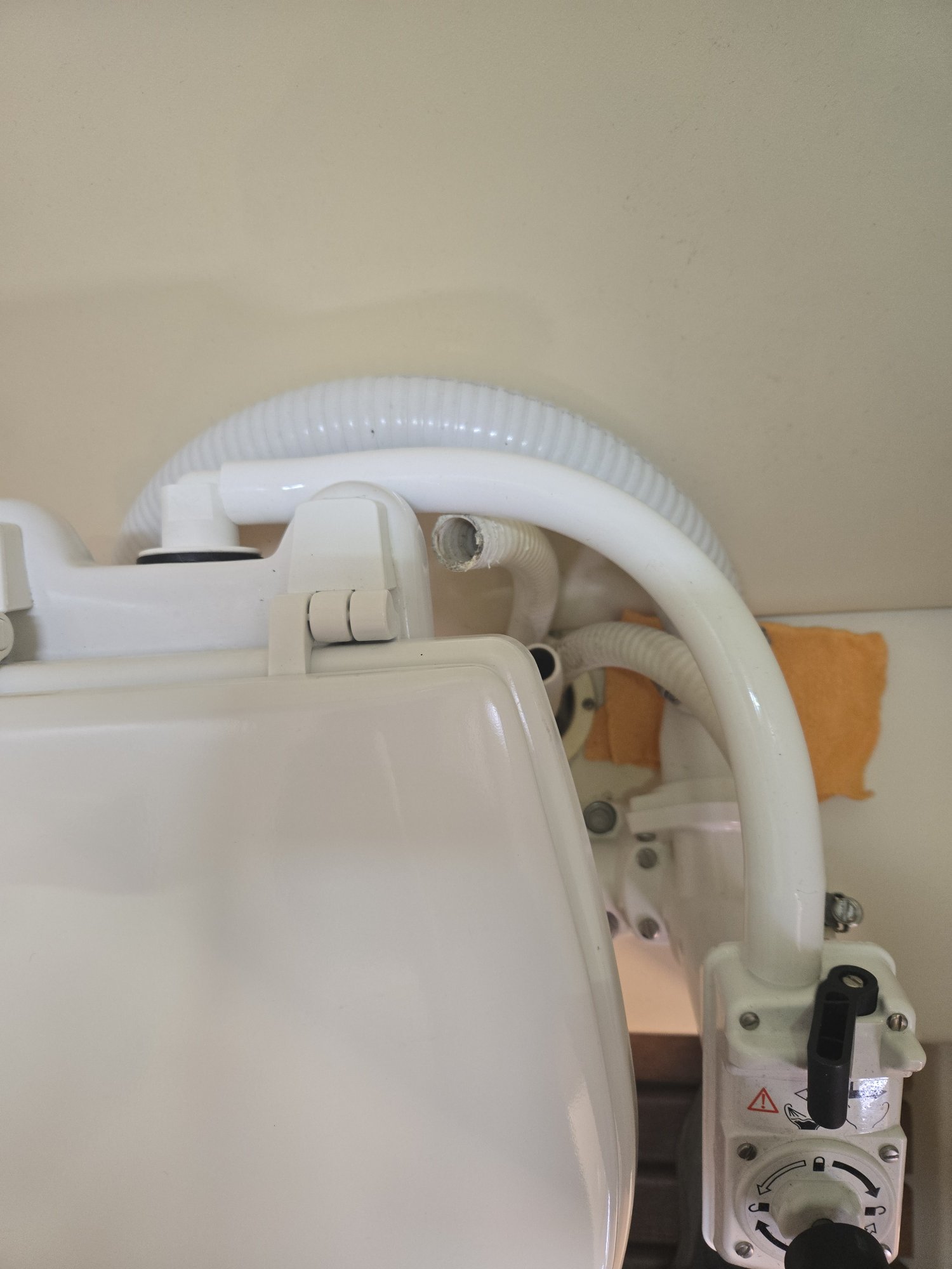

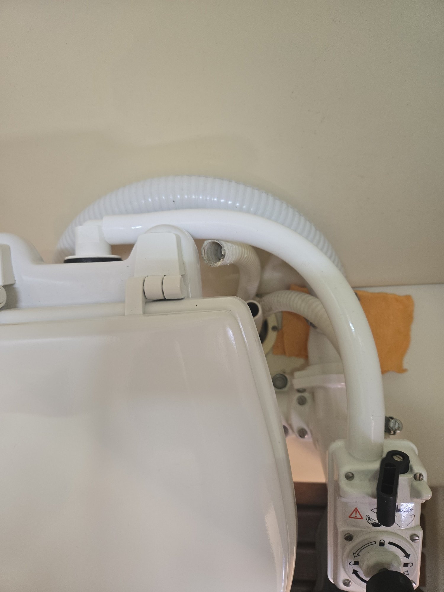

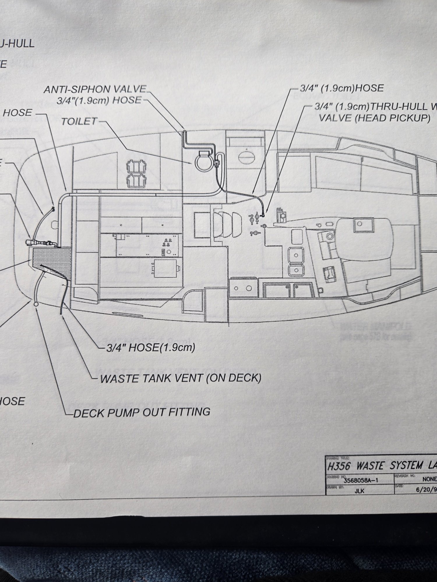

I see the kludge the previous owner made. He cut out the anti siphon valve and direct piped it to the toilet.
View the prints and see the 2 open lines at the toilet. Those open lines go to the anti-siphon loop. (In land-world a "studor valve"). He ran this in the Mississippi River. It probably became clogged by mud.
I see the logic and I'll correct it now.

Assuming that by "supply line" you're referring to the flush water intake line, the vented loop doesn't go into the line from the intake thru-hull to the pump, it belongs between the pump and the bowl, and and needs to be at least 6-8" above the waterline AT MAX HEEL, not just when the boat is at rest..which on most sailboats puts it 2-3 FEET above the bowl, making it necessary to replace short piece of line the toilet mfr used to connect them lines long enough mount it that high . Discharge vented loops, which are only needed in a line that connects to a below-waterline thru-hull, also need to be that high. Boat builders, who are the worst sanitation plumbers on the planet, will sometimes put vented loops under a vanity, which makes them useless. Any vented loop in the anchor locker will also be useless.
Most toilet installation instructions include drawings showing correct vented loop locations. You'd need to remove them before replacing hoses.

Thanks for clarifying, Peggy! I just logged in to clarify! that's where the one Hunter installed connects. the wet locker is in the shower/head part of the head, next to the companionway.

This is my after action report.
The fished lines i had to the toilet -existing- were two unattached lines that went to the loop in the wet locker. The third, supply size line, came from the thru-hull to the fresh water input on the toilet pump. That third line was the one that was weeping and squirting my shoe when using the toilet pump.
Fixing the system was fairly simple if you have enough 3/4" (20.9mm) id hose. On the replacing everything, I used about 21'. That was important because it took me 3 trips to get enough material. If done again I would have ordered it on line and had a bit left over from the box.
Early on someone bright (jssailem) suggested double ended connector to stick the new and old together for pulling in the new line. No clamping needed, friction connection of the 2 tubes was enough to connect the tubes for the journey. Plastic connector was fine here.
I did figure out the slash marks on the old tubing. It comes from moving the ss clamps along the outside wall of the plastic pipe. Don't treat those clamps too ruggedly.
Last tidbit was using ss clamps that have a hex head nut. Taking a driver socket and tightening the ss clamps was never easier.

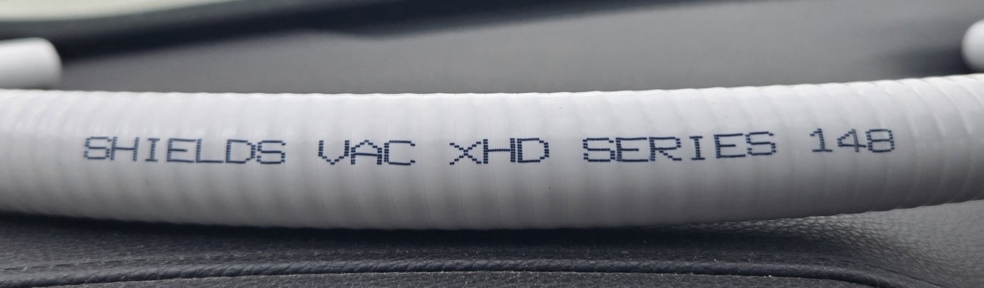

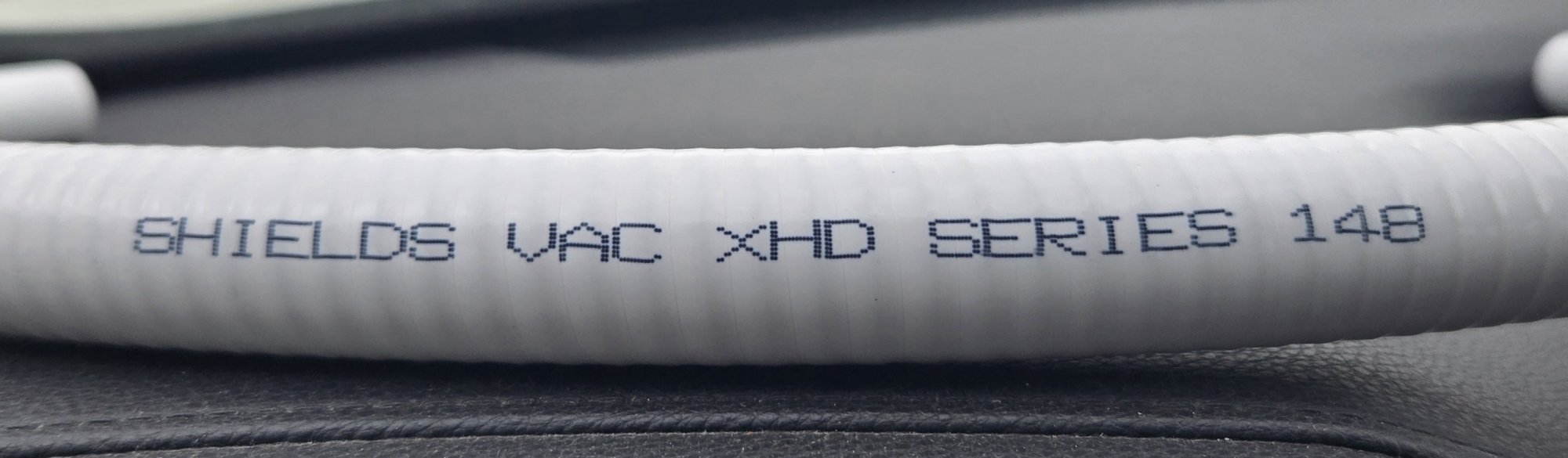

I poured thru the West marine site and found this description of the product.
Series 148 Multi-Purpose Vinyl Hose, Sold Per Foot. ~ $8.00 a foot depending on market.
It is reinforced and matched the original tubing that ran to the air loop. When handled responsibly it will hold up IMO.

Do not use clear vinyl hose...it'll grow mold and algae. Flexible PVC (cheapest sanitation hose) is good for toilet intake lines (3/4") and 5/8" vent lines. However this would be a good time to upgrade your vent line to 1" and replace the "vent" thru-hull (designed to keep sea water out of fuel and water tanks, NOT to allow a holding tank to "breathe") with an open bulkhead fitting and use 1" Sani-Flex. This will not only allow your tank to breathe, it'll let you prevent vent blockages by putting a hose nozzle against to back flush it regularly...anything trying to set up housekeeping in it will get a water slide ride into the tank. And the vent line won't permeate for at least a decade.
