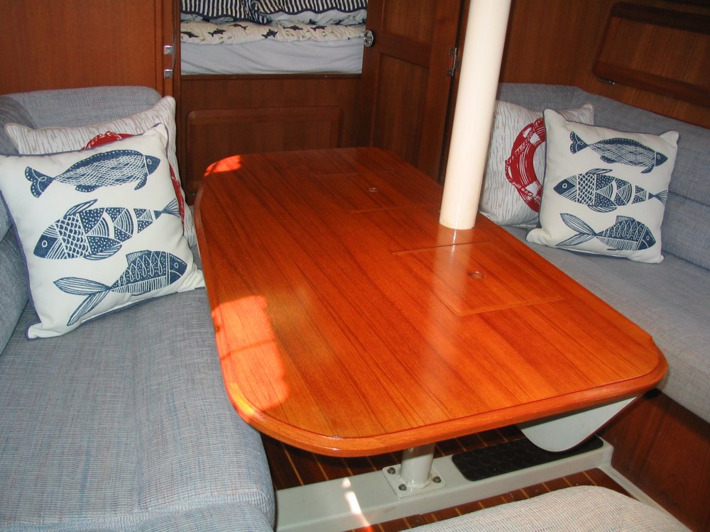

I used Daly's teak oil on the companionway and was very impressed with the results...Does anyone know what the table top finish might be?...is it Daly's or maybe varnish?..thanks in advance
Jun 13, 2010
70
Hunter 1994 Hunter 35.5 Legend walker, mn

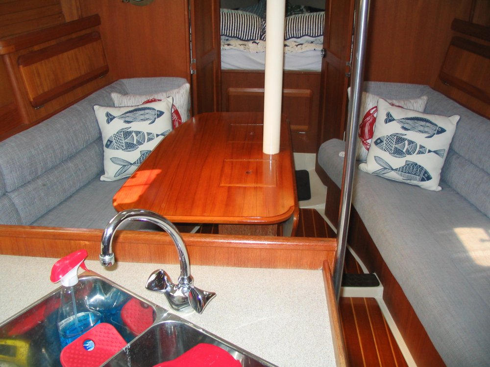

I decided to go ahead and refinish the table in the main salon....Mine wasn't in bad shape but had a couple of stains I wanted to get rid of ...I used 150 grit on the the main table as a couple of the stains were alittle more elbow grease to get rid of.you can work your way up to 400..One thing of note, I think the top of the table is laminate and VERY thin so you need to be mineful of this and not sand too much off.....on the small leaf because there was no damage I just went over it with the 150 with no pressure....I used Daly's SeaFin teak oil....I would recommend you read the instructions. It says to apply and wet sand with 400 so that's what I did.....The table extension only needed 3 coats as the surface was very consistant and I never sanded very aggressively....the table top was a different story....there were areas where I sanded more than others and did not have a consistant sanded table top..I applied Daly's with a dish rag that was lint free....the product goes on easily...you can wipe on a coat in about one minute....depending on humidity and air temp will determine how long it takes to dry.I put on a coat at 7am and another at 6pm.....I put a fan on low to help this process....because of the inconsistencies in my sanded table top, after each of the first few coats there were a lot of flat spots where the oil penetrated...this went on for about five coats....right now I am on coat 6 or 7 and I am about 95% done with a consistent finish on the entire surface...If you sand a fair amount plan on applying many coats to get you back to a consistent finish...and be careful because if the surface really is a laminate that's about 1/64 inch thick or less....The Daly's product does leave a darker finish than a bleached out surface that's been sitting there for 25 yrs....that's my take on refinishing the main salon table of a 1994 hunter legend 35.5....I was alittle concerned after the first couple of coats as it looked like crap....but I am happy today....

Excellent write-up.
-Will (Dragonfly)
23,390
Oooooooo. Ahhhhhhh. Very Nice.
