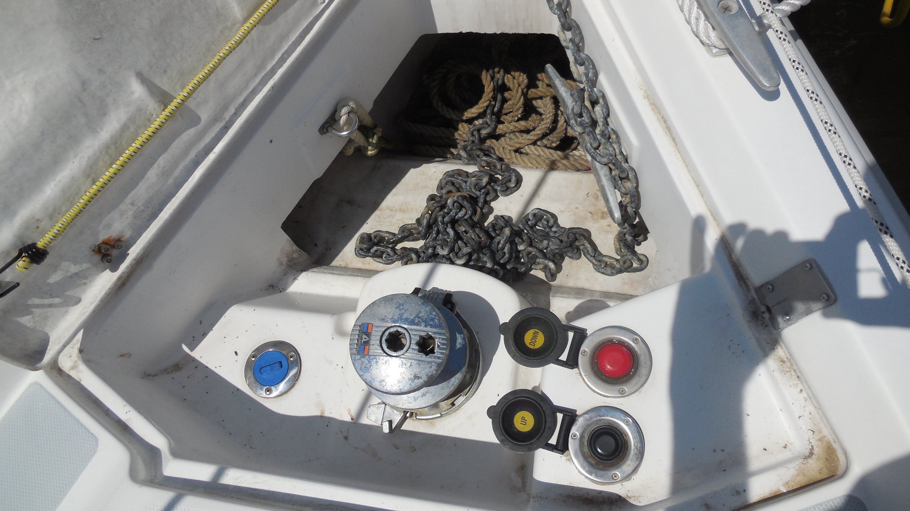

The factory installed anchor Windlass on my 2000 H340 is a Simpson/Lawrence Sprint 1000 vertical windlass. The chain spills down from the shelf and into the locker.

Thanks for the info and pic. The direct Lewmar replacement is a V1. It seems the newer models are all designed so the chain exits beneath the windlass directly into the locker. The chain on your windlass appears to exit forward into the locker. I found this picture that shows the windlass mounted forward so the chain coming out the bottom of the windlass drops downward into the locker. Mounting this way would expose the lower part of the winch to the elements. I'm not sure if this is the answer to mounting newer windlasses or if there is another option. Are there any other solutions out there?
