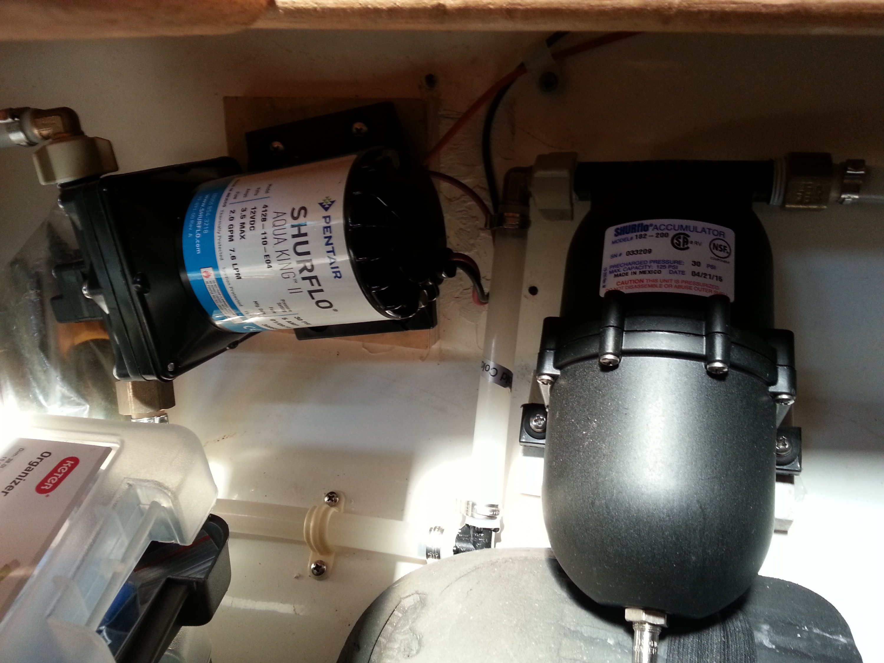

On my 2000 H340 the domestic water pump was mounted to a fiberglass panel the made up the base of the port side settee. When the pump ran, it would vibrate the panel and act as a sounding board to amplify and "broadcast" the sound throughout the boat. On this and on my previous boats, I have unbolted the pump from the bulkhead so it would lie more horizontal and let it rest on a cushion of various density foam blocks. This reduces and dampens the pump sounds considerably. The attached water lines hold the pump in place and it has not moved in over 10 years.

No brand was mentioned, but with our Flojet water pump, if the water supply becomes restricted or the tank empties, the pump tends to run at a higher pitch than normal, due to the absence of load. Our pump has four mount points each with a rubber pad to cushion vibration and noise. Periodically, the forward tank bib feed becomes clogged with a clarified material, which restricts water flow. I can always tell because the pump runs at a higher pitch due to insufficient water supply. Once I clean it out, the pump returns to normal operation.

I lie my pump on the bulkhead rather than screw it into the side of the settee also. It sits on the four rubber mounts and a thick rubber pad. The noise is much less noticeable in this position. It's a more solid base for the pump.

the problem is undoubtedly due to the vibration of the motor, which is normal in itself, and some noise will be normal and a good thing incase a waterline should begin leaking, so that you can hear the pump cycle when it should not be
if the pump is mounted to fiberglass or a thin plywood, the noise can get unreasonably loud, but it can be dampened.
if you were to remove the pump from its mounting spot and then cut a piece of 3/4 plywood as big as possible that you can fit into the space, and then mount it solidly at its corners, then remount the pump on to the plywood. it will act as a sound absorber/deadener.
if its possible you may even build the plywood with a right angle leg on it so it can be attached to two surfaces on two different planes, which will be way more solid. the larger the plywood, the better it will be... and dont scrimp and try to get away with 1/2" plywood, because if you are trying to dampen the sound, you want it as solid as possible.
and make sure the pressure line coming from the pump is not viberating against a panel somewhere, as that can cause a noise as well, especially if its laying against a thin flat fiberglass surface...
