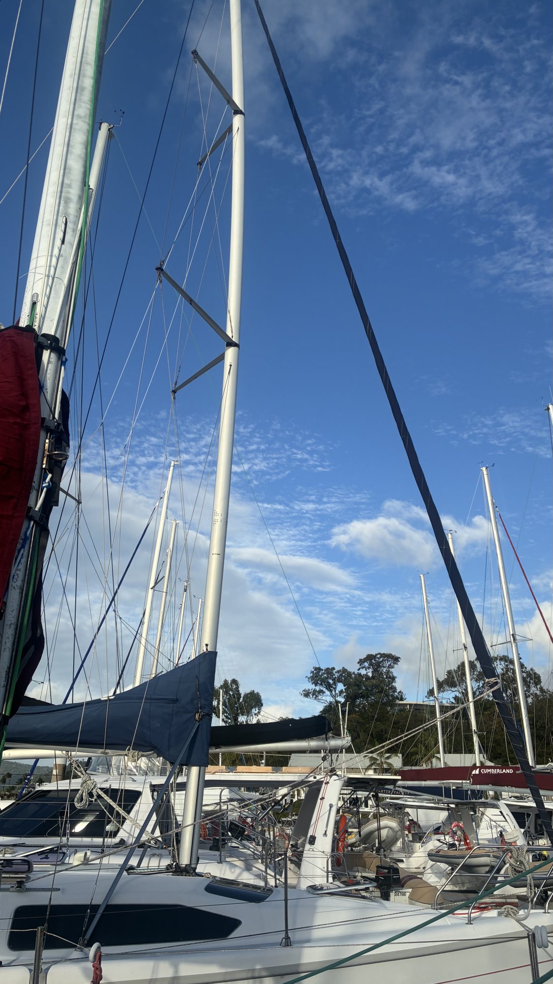

I have no idea if the previous owner made some rig alts that have left the mast well forward of vertical. The attached pic was taken as close to 'directly' abeam of the mast, but I'm not sure if it really shows anything useful.

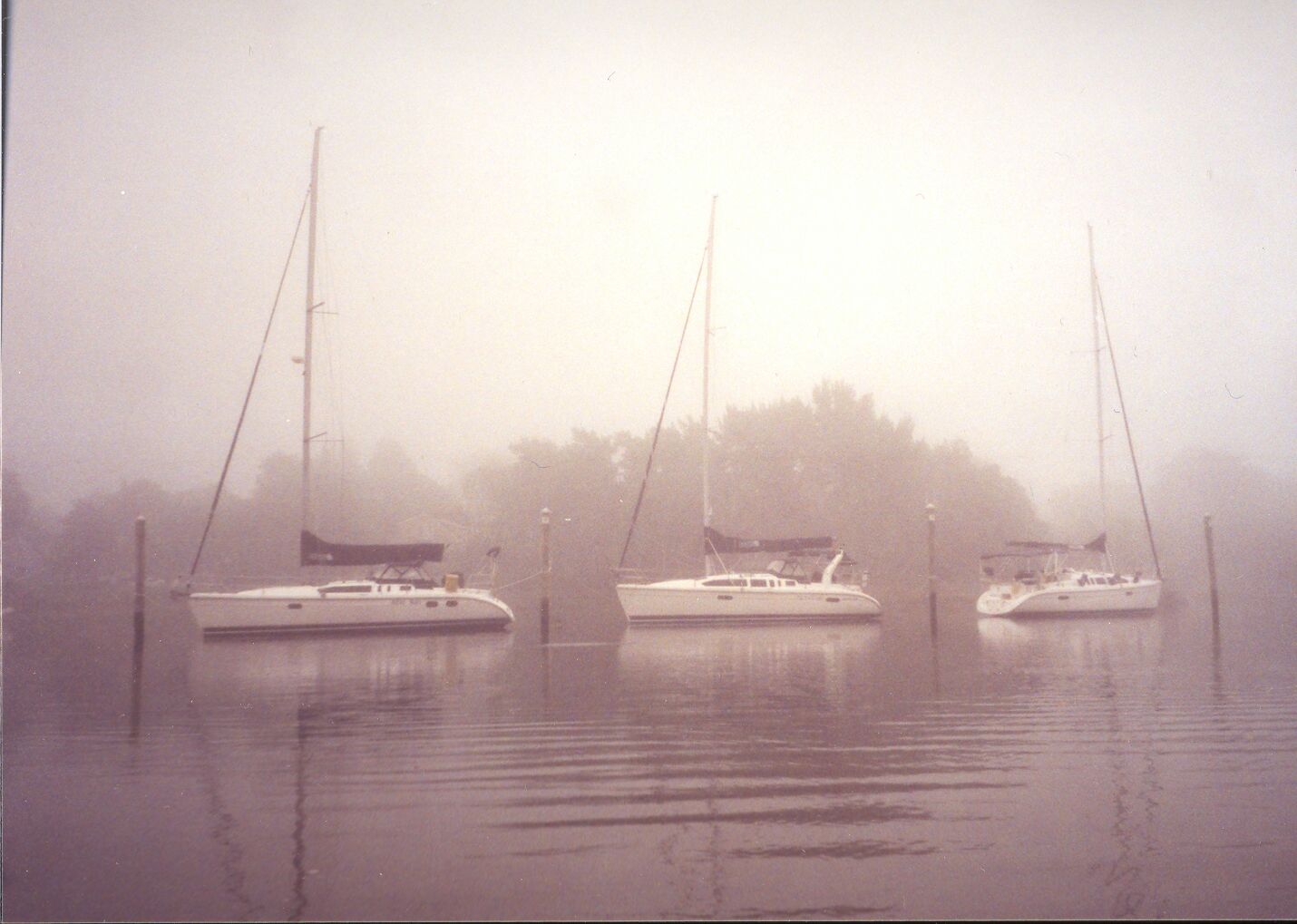

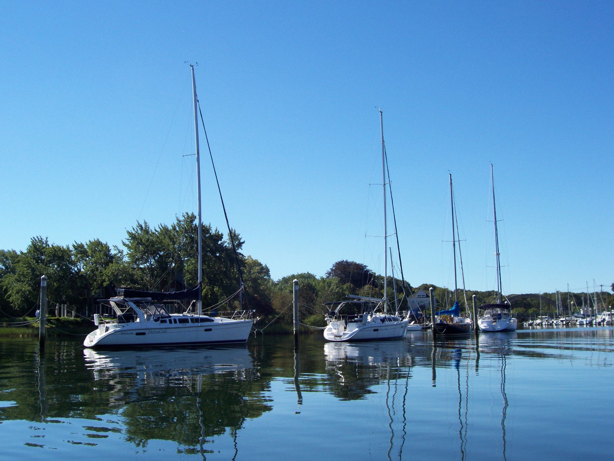

In this photo the first boat on left is a 1999 - 340. The same as yours with the fiberglass arch. The boat in the middle is mine (2000). This was a friend’s boat, he no longer owns it, so I can’t get any info from it aside from this picture. But it does show a significant difference from your photo.

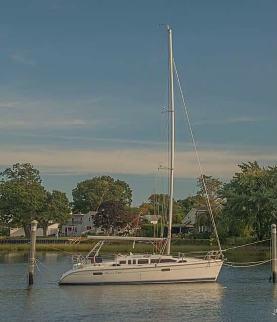

This is my 2000’s profile. For a possible reference.

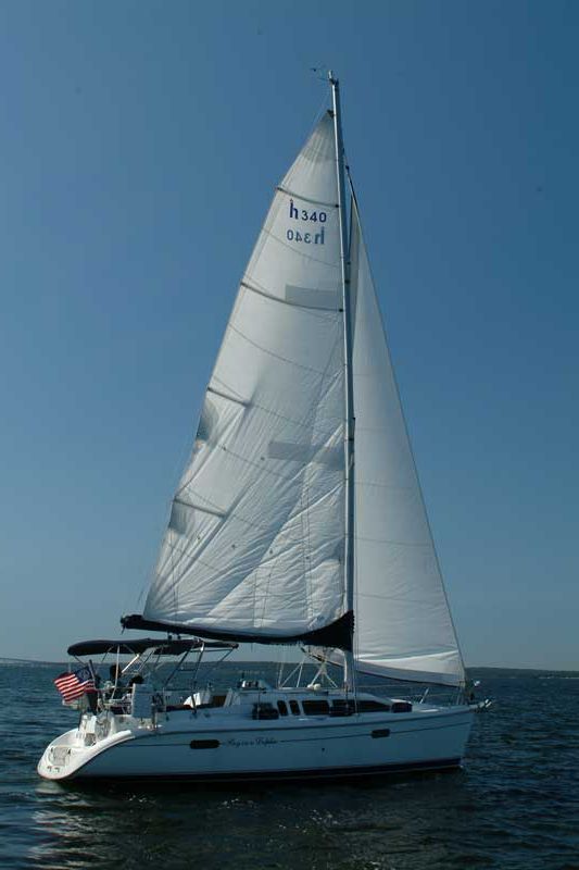

I found this and few other photos (of actual sailing profiles, if you’re interested) of the 1999 340.
The boat on the left is a 1997 - 380. Center is the 1999 - 340. Right is a 2000 - 340. It was a very foggy morning when I took this shot but it does show the profiles you are interested in seeing.

IMHO that mast isn't in Column. Rake usually refers to the top of the mast being aft of the step. Your mast appears to have a bow.. I would think that would simultaneously place undesired structural forces on the mast at 2 different locations .

The mast does seem to have a lot of pre-bend. There’s only so much you can conclude from a picture.
Changing the pre-bend could result in needing to re-cut the main or replace it. I’d sail it for a while before making these changes.

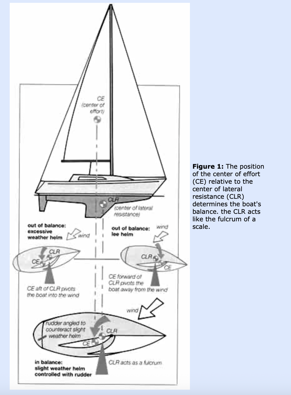

The somewhat extreme, (and deliberate) pre-bend on these masts means that the centre of effort, (Maximum force on the 'centremost' and therefore most powerful part of the sail plan sailing upwind) needs to have 'apparent' fwd rake on the mast to align vertically with the Centre of lateral resistance (Middle of the keel).
I've stuck a diagram below to illustrate.
