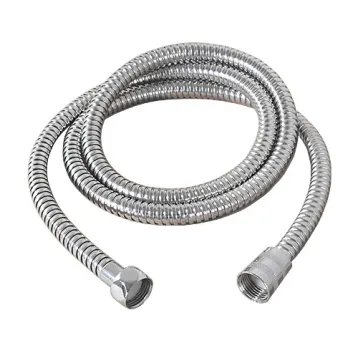

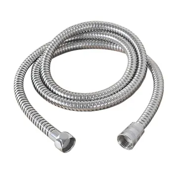

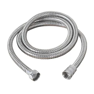

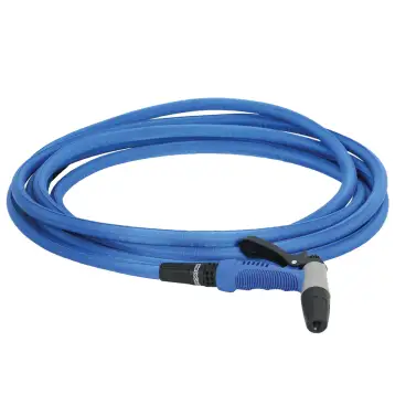

The hose is likely made of soft vinyl. This will kink over time. It is inexpensive and readily available at home DIY hardware stores. (Less expensive than from a marine chandler)

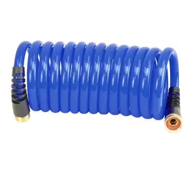

Or you might look at one of the expanding hoses that fit in a shoe box yet expand like a snake when filled with water. The connections might be an issue. We would need more information about your specific hardware.
Two ideas off the cuff. There may be others, but information about your boat and systems setup would be needed to flesh the ideas out.
These are about $30.

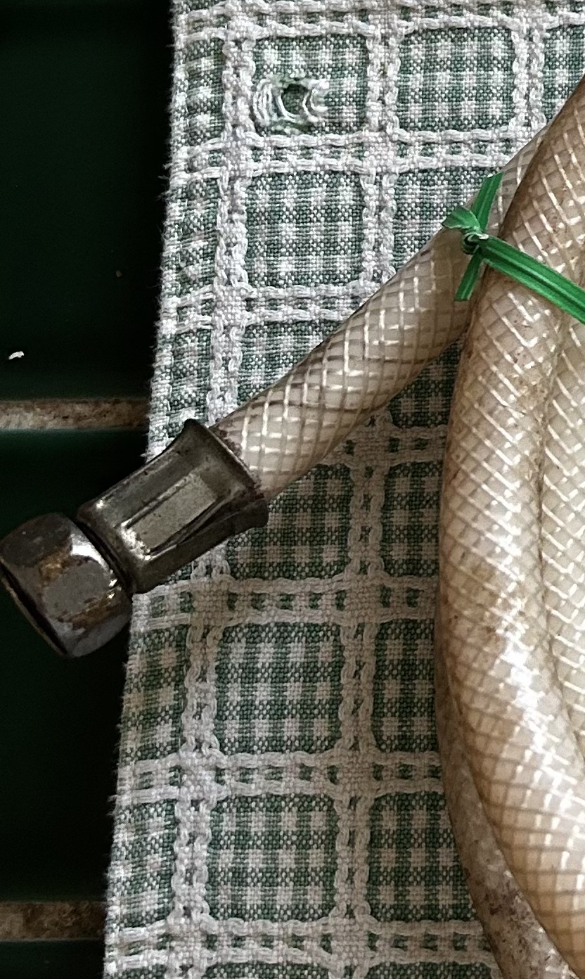

I was doing so many other things today, I didn’t remember to get a picture. My mistake.
This is the one….
Only mine is a very cheap version of this hose. Biggest question is, are the fittings a standard or unique to Hunter, back in 2000. Which would probably entail replacement of the entire unit. As seen in the SBO store.

More like a standard than unique. Hunter bought parts from the most efficient source rather than designing their own. Suspect you will find a match at most plumbing sources. I'd take the hose off the boat and take it into a Home Depot or hardware store of choice and ask for a twin.

The fittings are most likely standard. Go to a Big Box hardware store or an RV store, they'll be much cheaper than a marine store. It also may be cheaper to buy on with the shower head than without. I think I paid about $30 on Amazon for a fancy hose and shower head last summer.

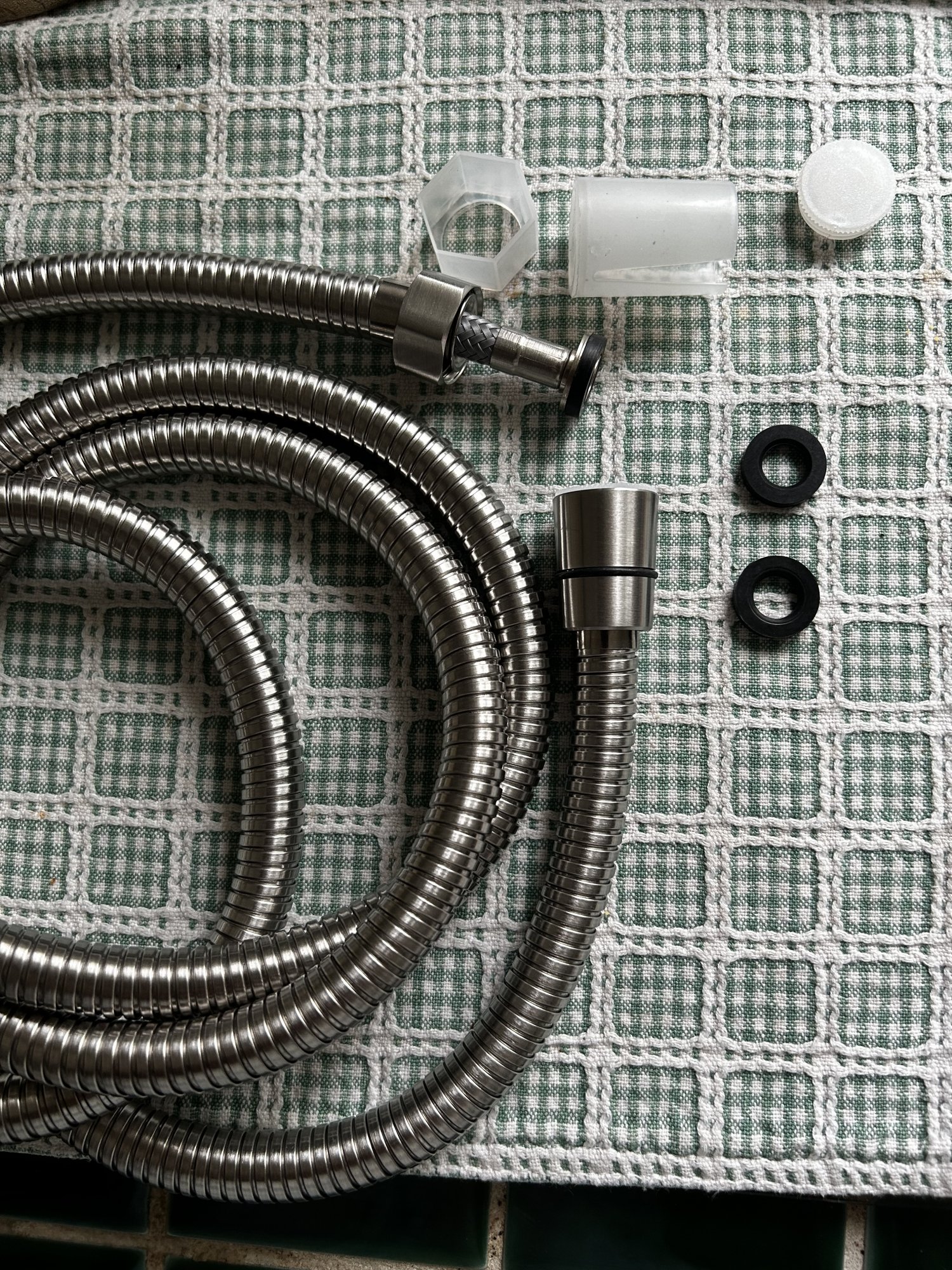

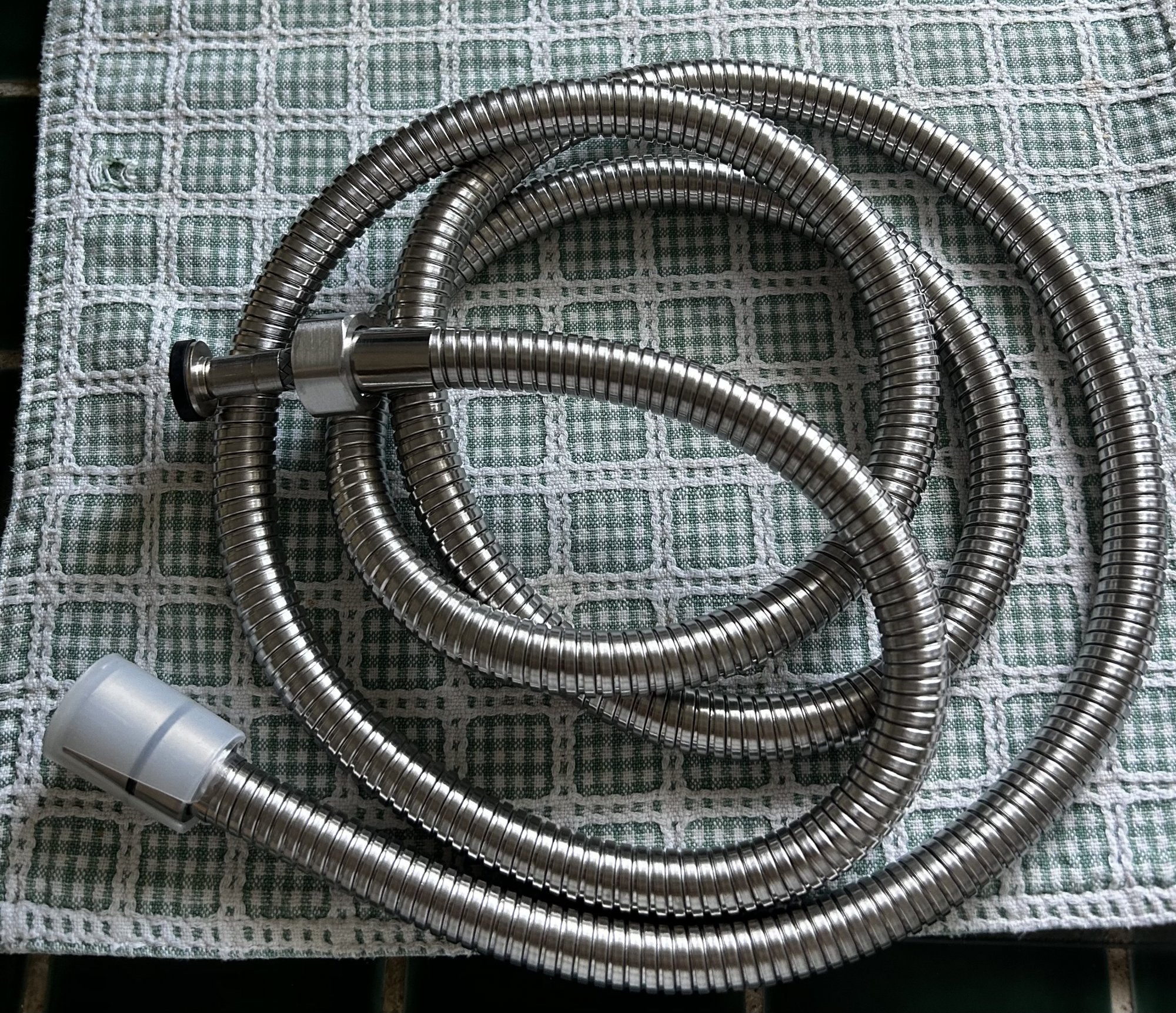

Got my new cockpit shower hose today. I was a victim of supply chain issues.
The difference in hose is night and day.
A word of caution to anyone looking to remove their original hose….the fitting at the hose connector behind the unit is sharp as a razor blade.
It has a flared out flange and it is sharp. Only use a wrench on this fitting, don’t be tempted to grab it with your hand once it is loose, it will cut.
As for the new hose it is a very flexible stainless steel hose that should not kink over the years going forward.
