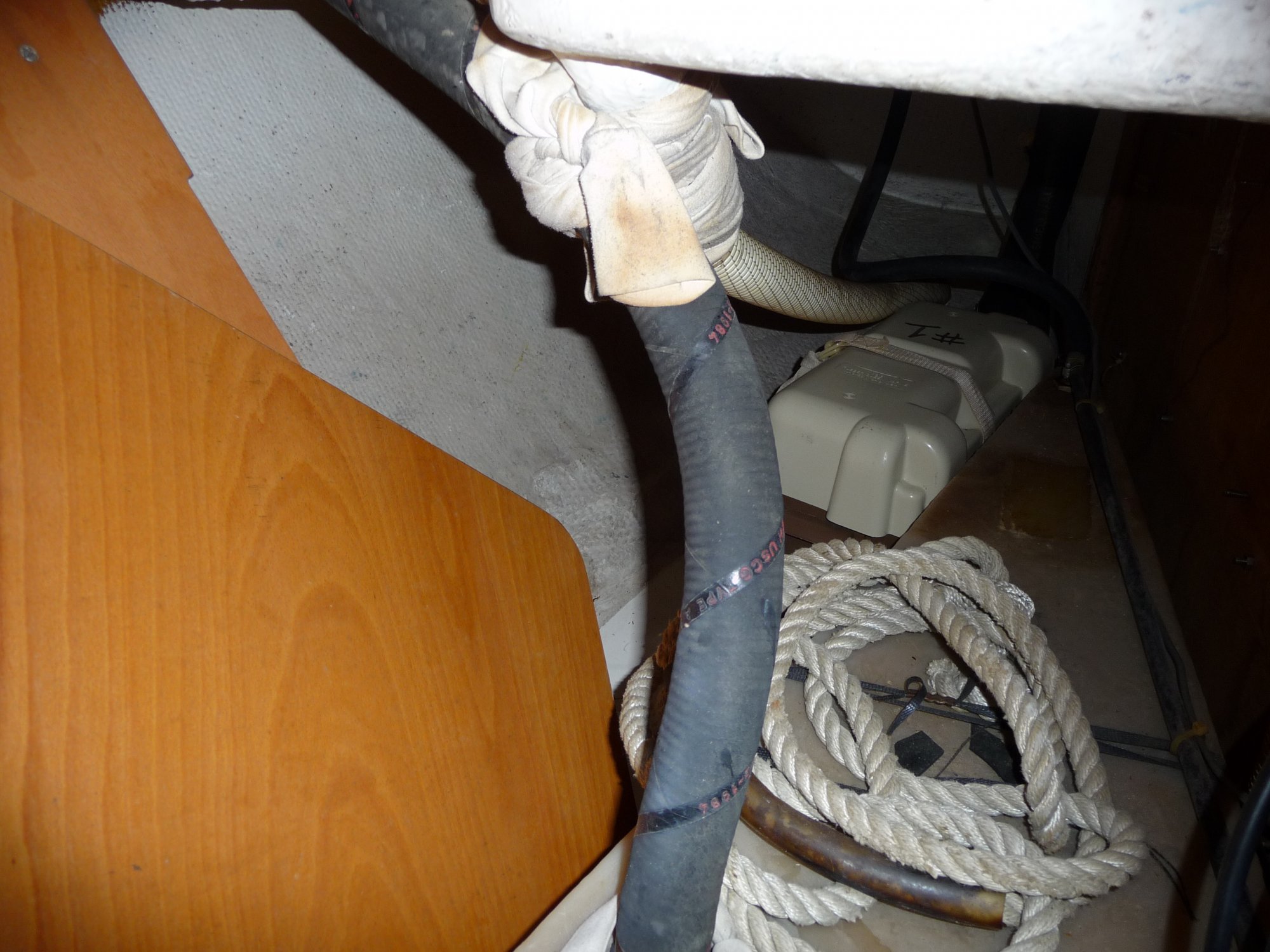

Remove a couple of hose clamps and about four feet of flexible hose and your done. Technically the drain is above the water line, but if you want to be sure the boat is not squatting then empty the aft water tank.
Should be an easy fix providing you can fit into the starboard lazzerat. Aka dungeon.
10,151
The top clamps are no problem but accessing the aft thru-hull is a job for someone small and flexible.. The ribbed white (ish) hose is the cockpit drain and it ends WAY back there by the transom in the depths of the "pit"
