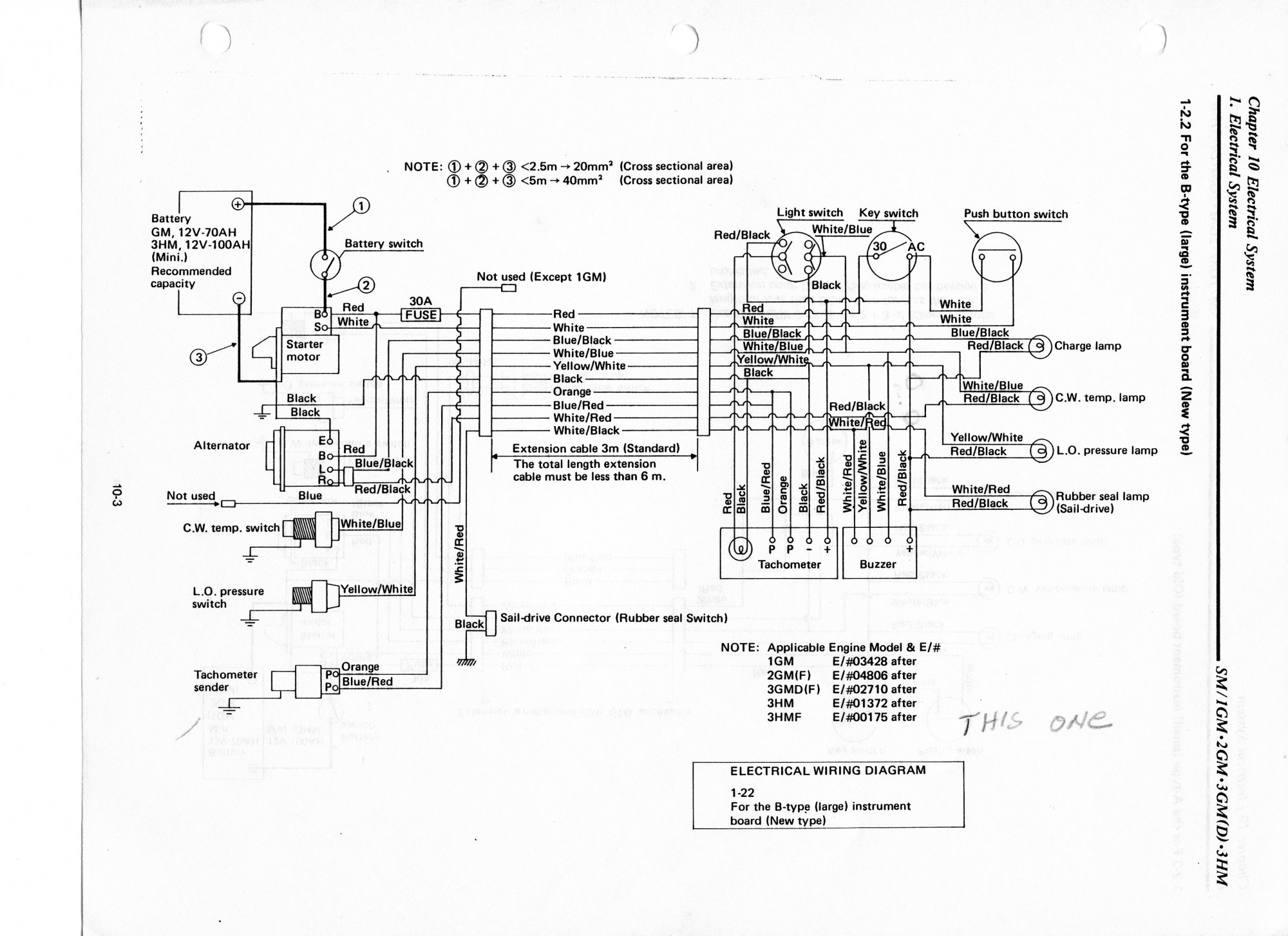

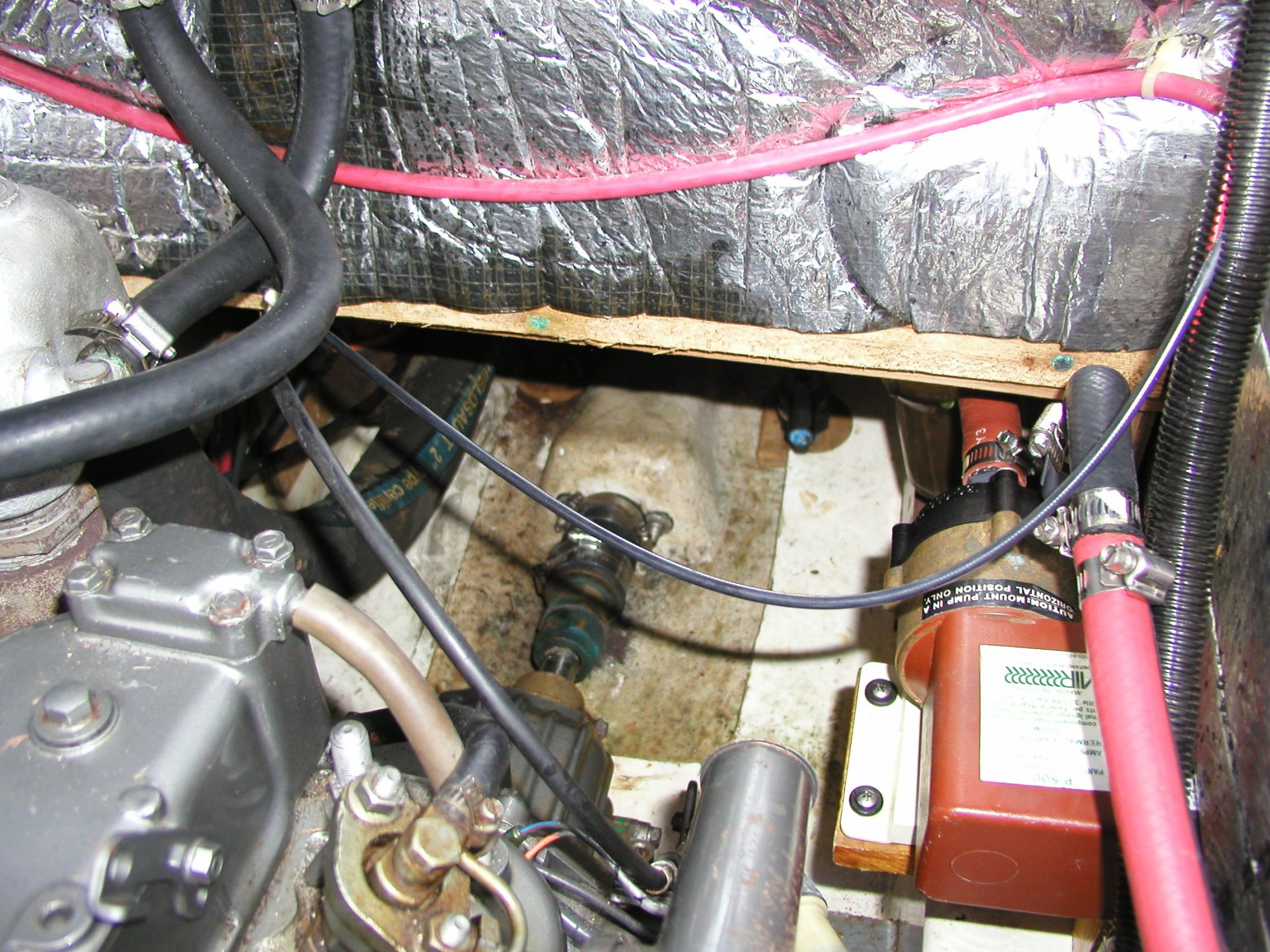

Randy, I wouldn't open the heat exchanger unless you suspect fouling or have overheating. If the boat is new to you, it may be prudent to open the forward end cover and remove any impeller vanes that you may find. If done very carefully, you won't need a new gasket or o-ring, but again it would be prudent to have those on hand.. The tachometer is driven by a sensor that counts teeth on the flywheel and converts that to RPM. That sensor is aft/port on the engine. the connectors for the wires are notoriously intermittent/dirty and need to be cleaned when the tacho gets squirrelly. Attached is a wiring diagram showing the sensor (bottom left) and its wiring. Also attached is a photo showing the wires location on the engine. In the picture you can see the orange and blue/red wires just aft and below the fuel injector.
