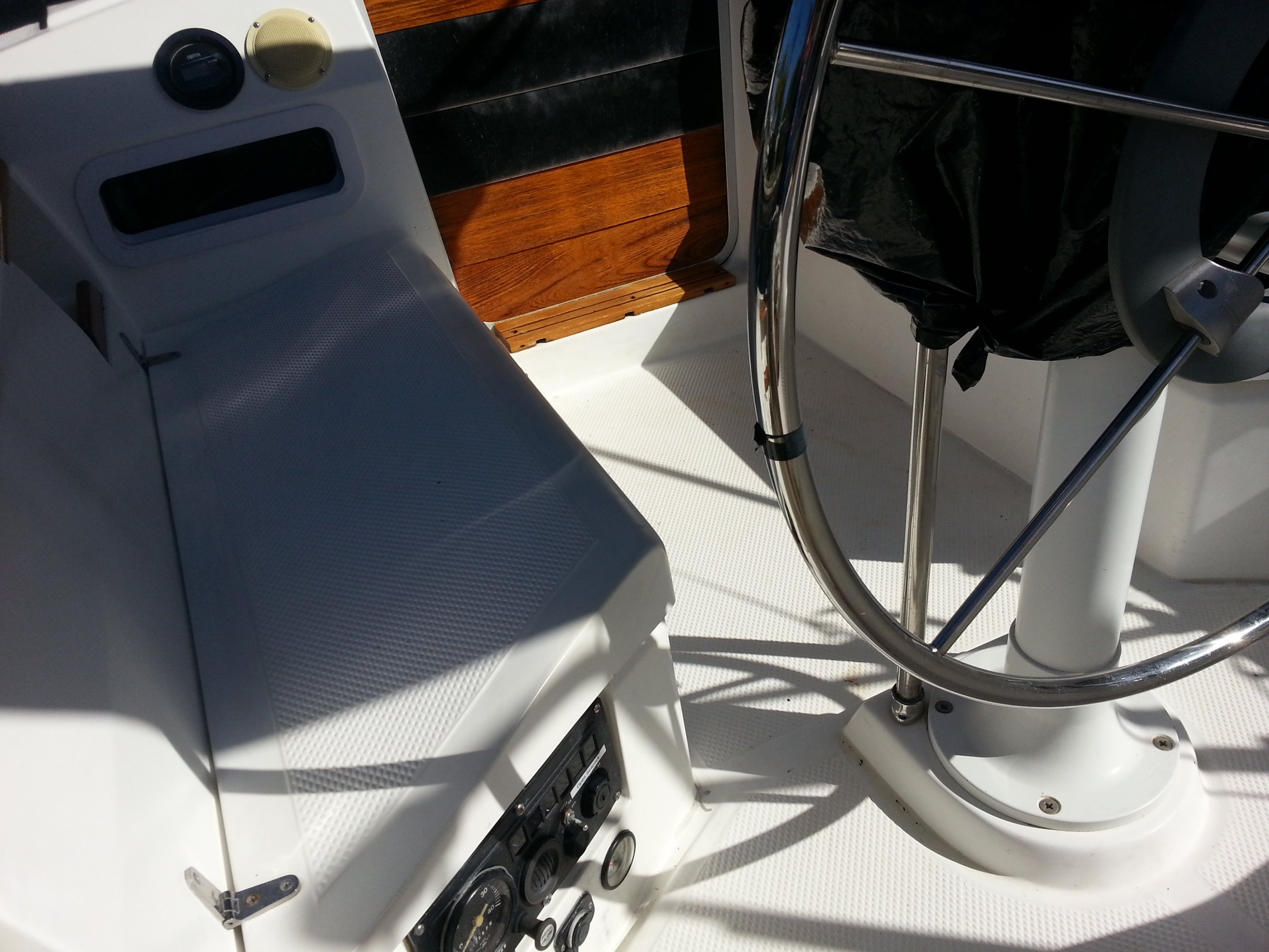

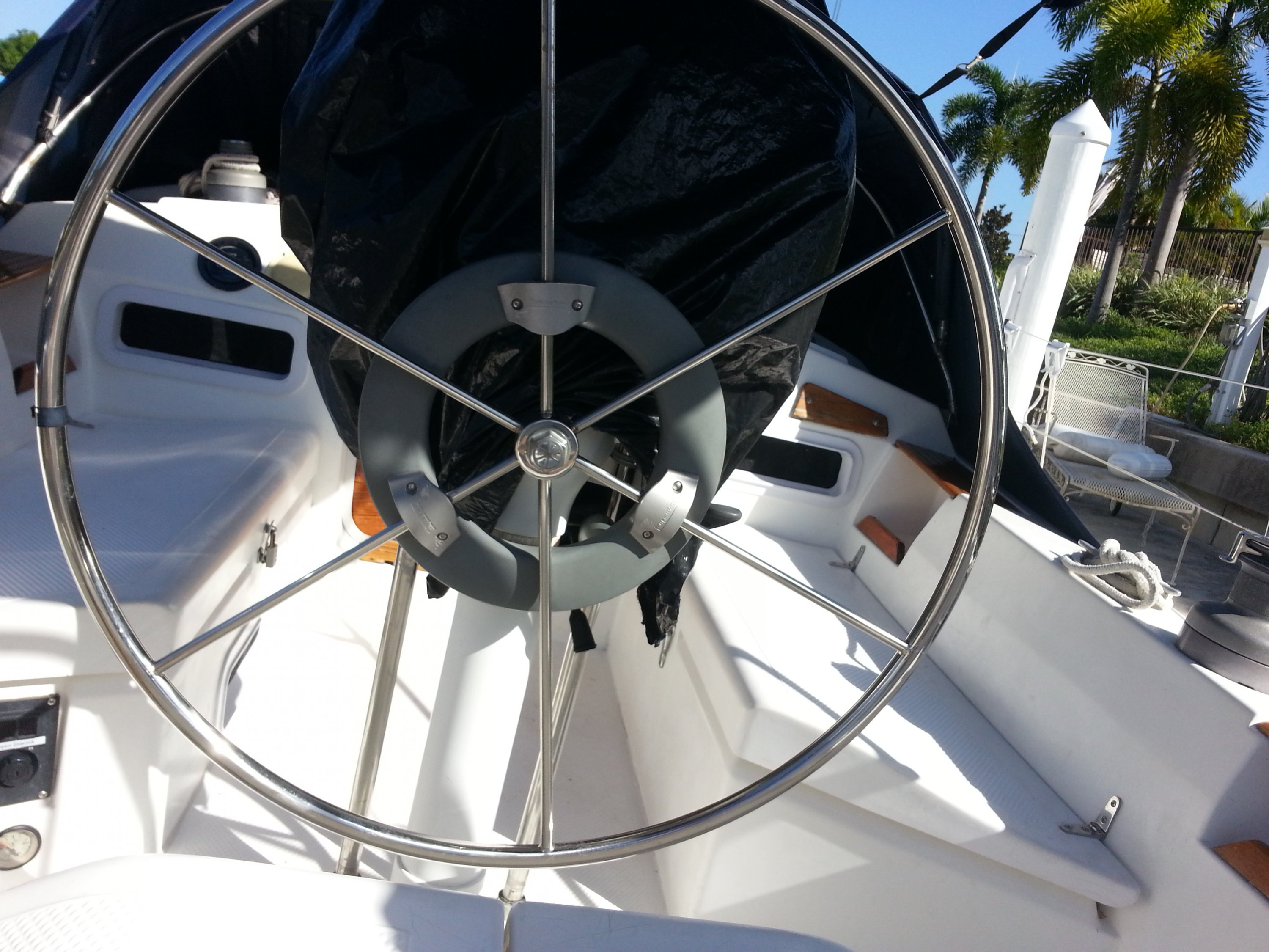

I purchased a new wheel @ defender which was 2" smaller in diameter. It's a million time better though it is not as easy to steer while sitting in the corner... I've been learning to steer with my feet while sitting there.....

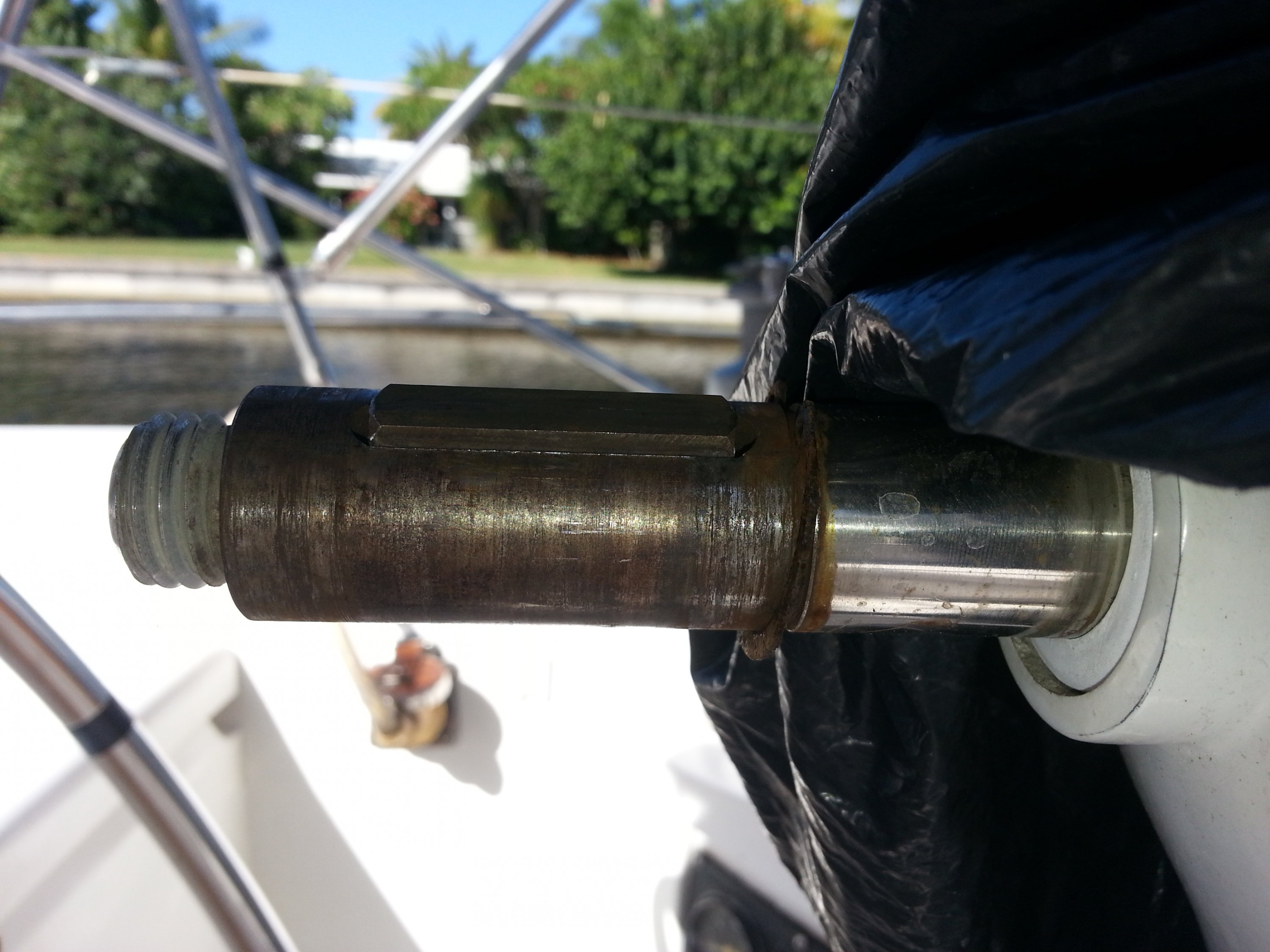

I've attached a couple of picture of the wheel.. You can see the extra room. There was no information on the wheel to indicate manufacturer.... but as you can see there are 6 spokes. -Jon

you may want to polish that shaft ...if it ever freezes up it will be a bit*# to remove....
