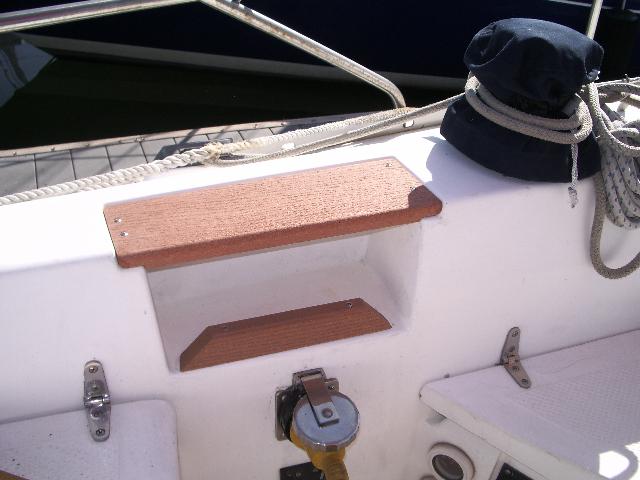

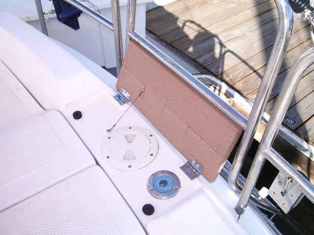

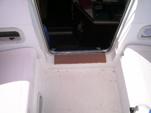

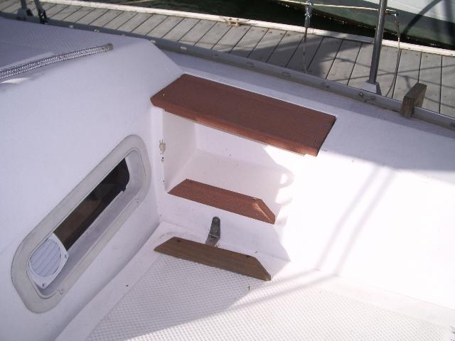

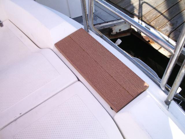

Having grown tired of trying to keep up the appearance of the teak seats on the coaming of my H34, I have replaced them with a synthetic decking material from Home Depot (like Trex). Total cost was $28.00. It took a while to trace and match each piece as they were not the same shape nor were they straight forward square cuts. The material was thicker than the original teak, so with the help of a router, I was able to cut it down so the new material still fits flush to the coaming surface. It cuts nicely with routers, chop saws, table saws and hand saws (all of which were employed). I used a file to break the sharp edges. We shall see how it weathers over time.
