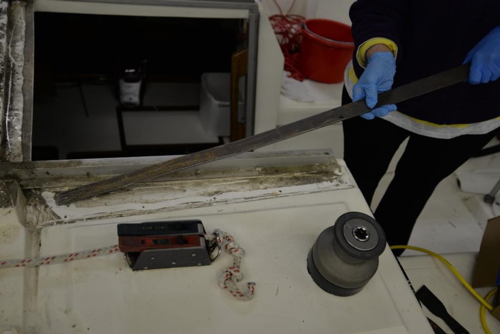

Hope this helps; key tool is the one where my wife is holding the long steel bar tapered at one end to hammer longitudinally to break the bonding agent, and 2 small question mark-curve crow bars used to gently pry up

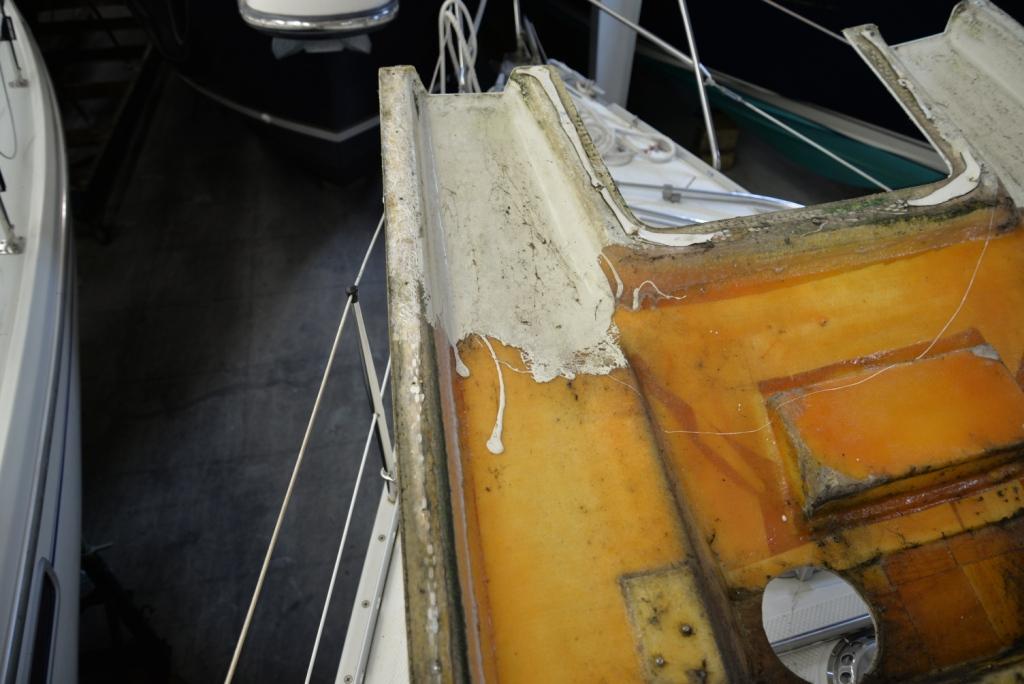

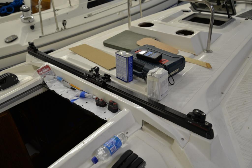

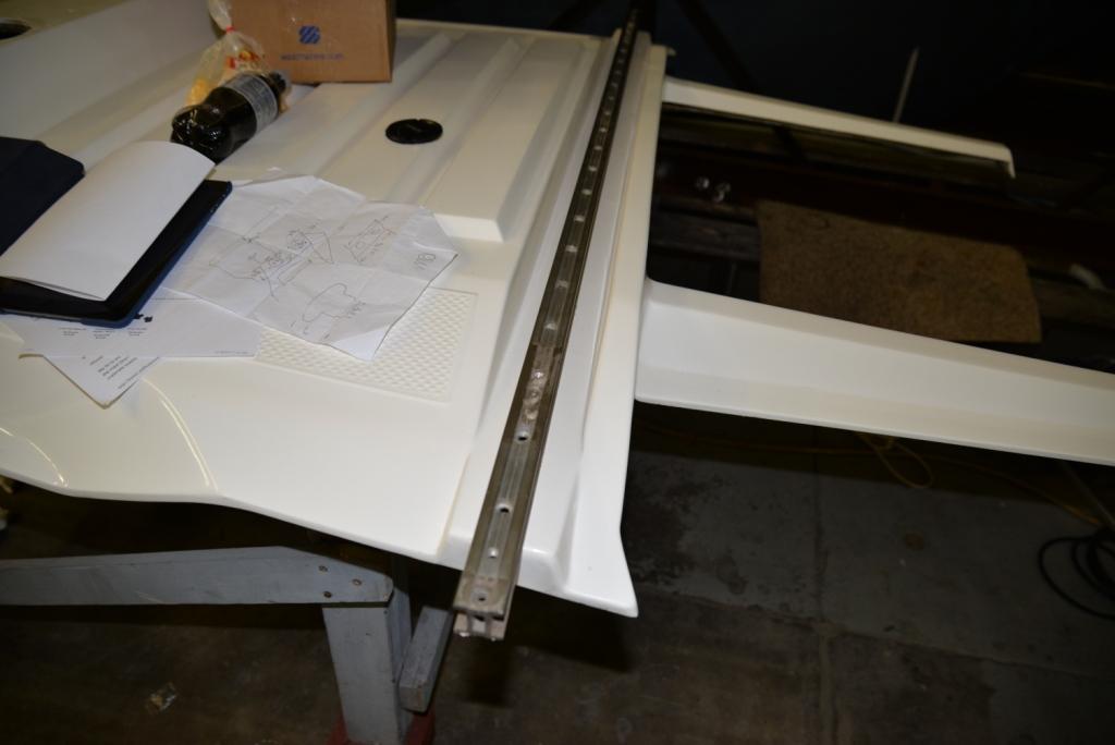

OK; so reading your posts I will post the following pics:

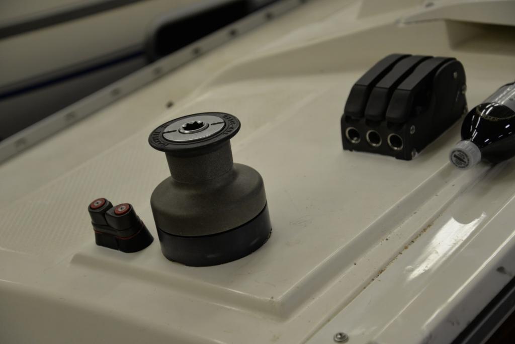

1: The original setup. I was able to remove all screws without the problems. The end port and stbd screws screw into the port and stbd pedestals on the deck on each side of the seahood. Once we cut the new Harken High Beam 32mm track to the correct length using the old Schaeffer track as a partial reference ( be VERY careful here and check with the new Harken end stops as their screw hole may necessitate length adjustment with careful measuring and not just cut to the old Schaeffer track length) we used the new Harken end stop on one side to drill and tap to a larger screw diameter recommended by Harken. We then position the other end stop to mark the exact hole position and repeated to drill a hole in the new track.

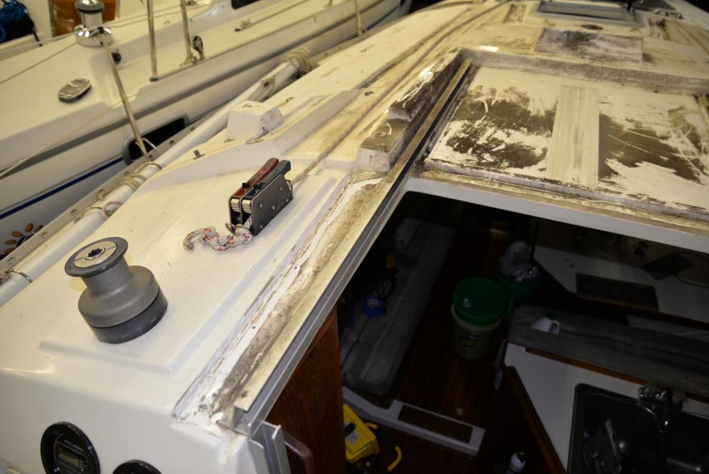

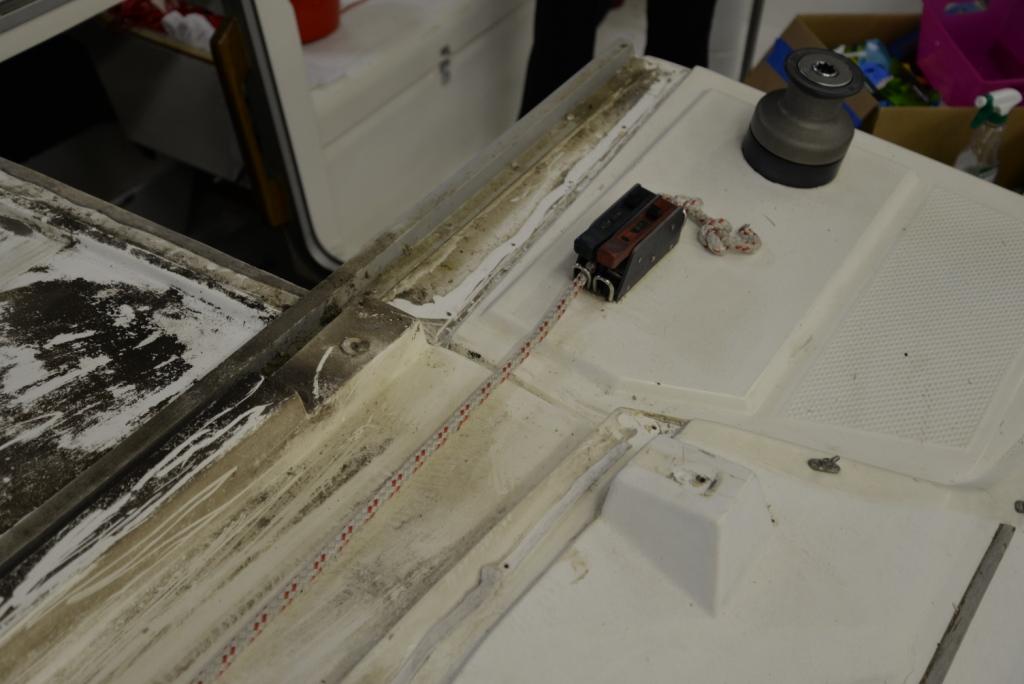

2: You can see the seahood in place with the old track removed prior to seahood removal. As I recall all subsequent screws go only into the seahood and not the deck, so you could probably pull off the hood with the track attached to it

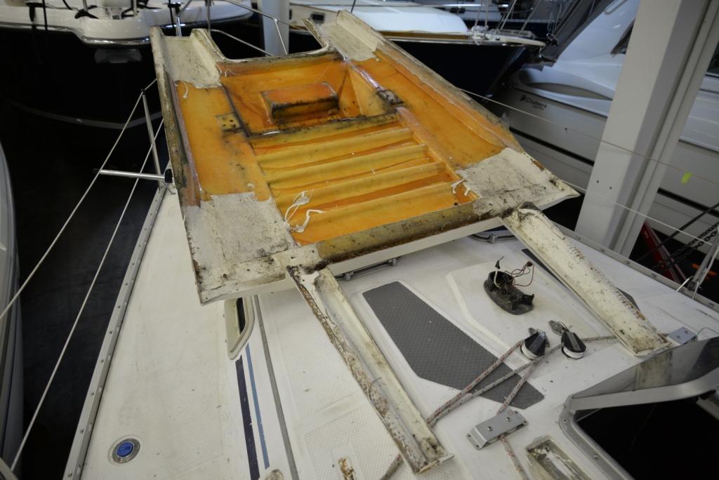

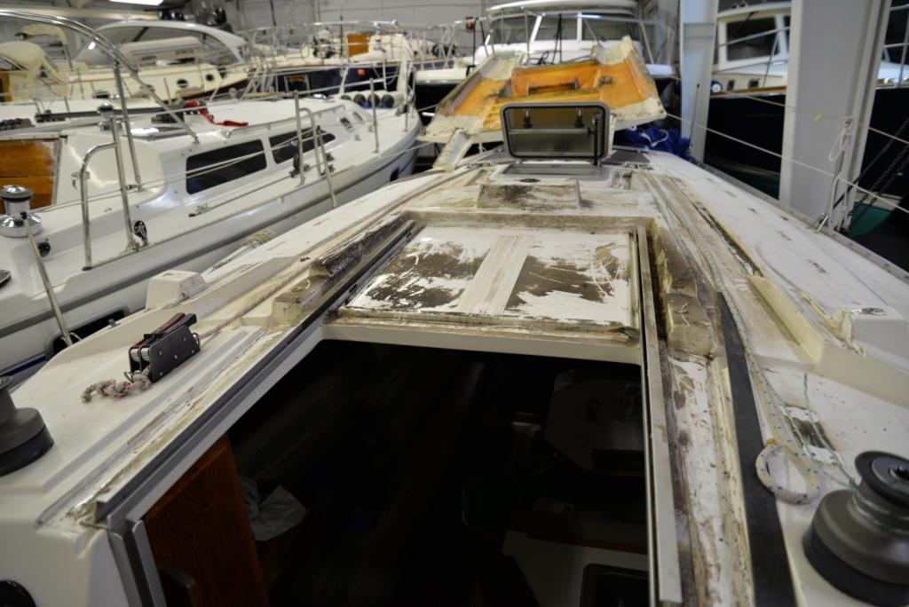

3: Just to demo; screws have already been all removed

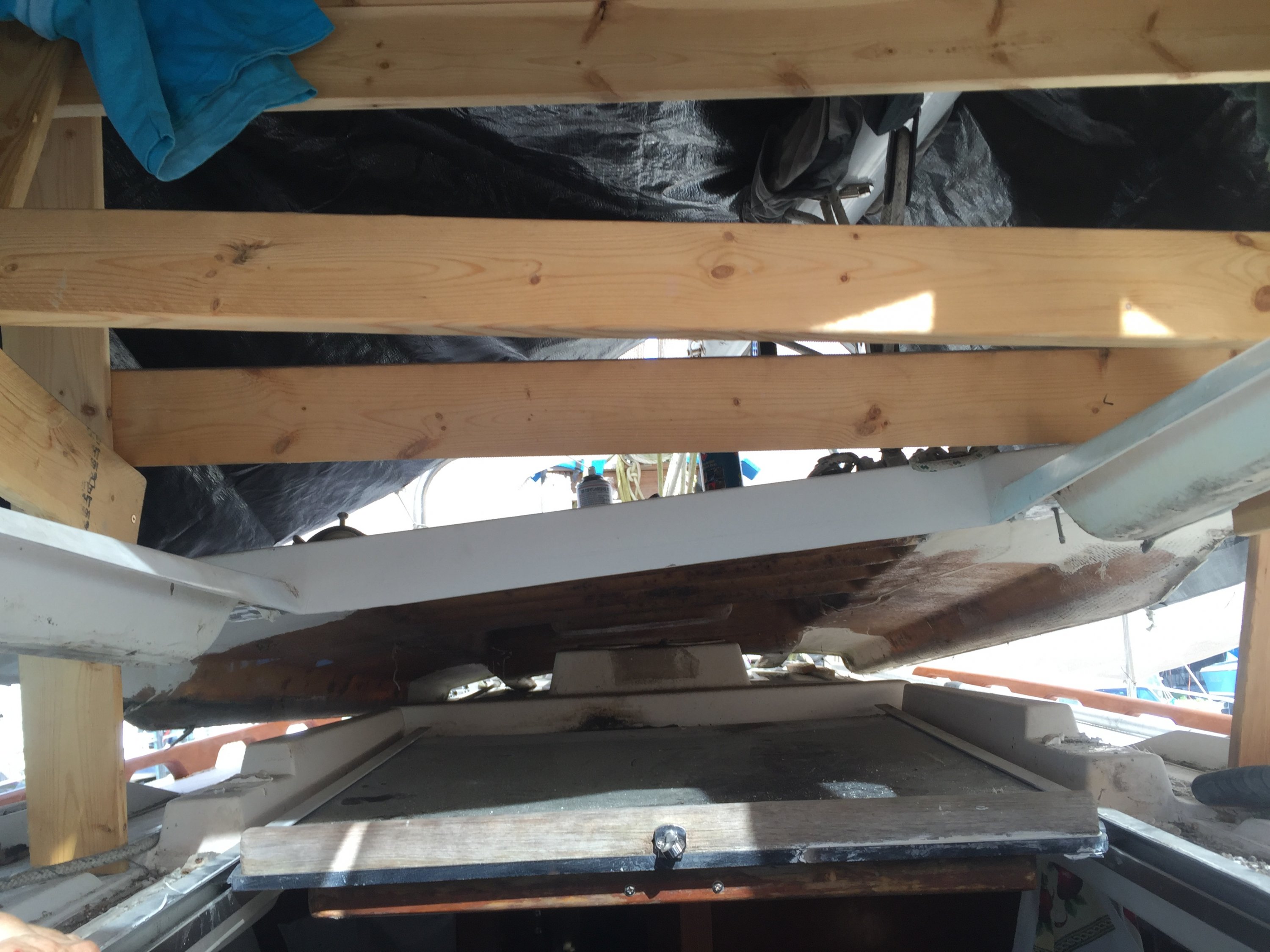

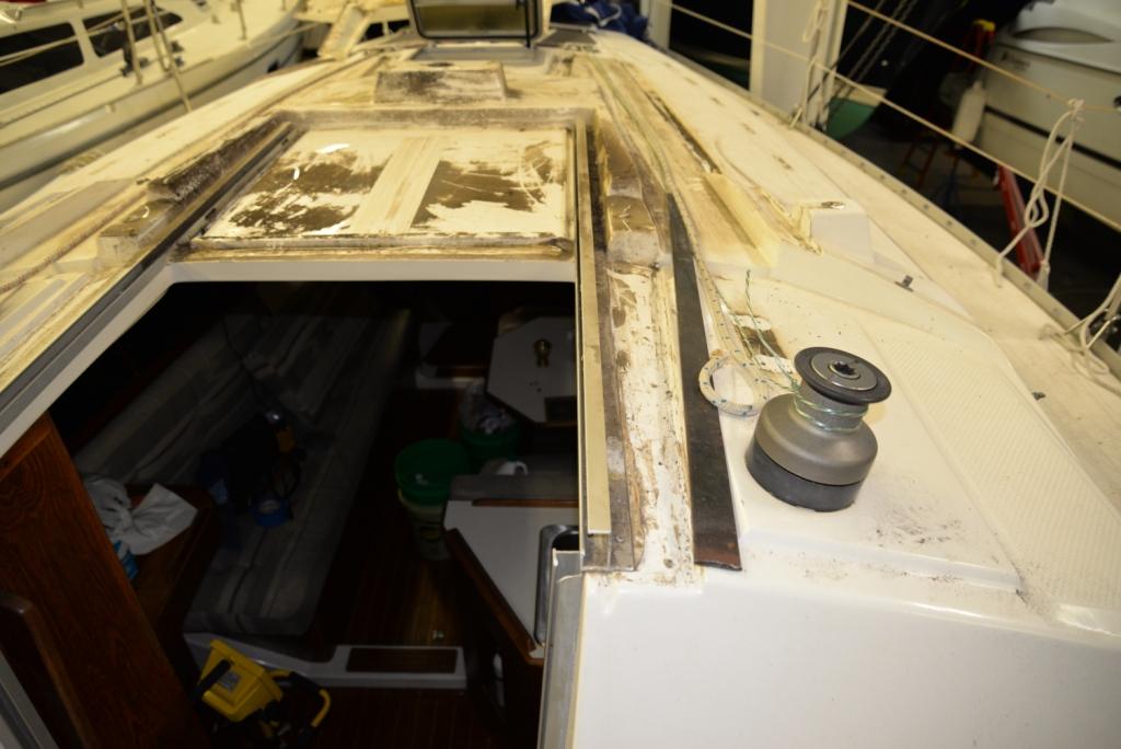

4: The million dollar shot: under surface of the seahood showing the screw holes the track screws screw into. There is a metal plate bonded into the hood that they thread into so they don't have to go into the cabin top. You will need to overdrill these to larger diameter but not tap as the old screws will be replace with nuts and bolts so you can tighten them on the underside of the hood given the T-slot design of the new track

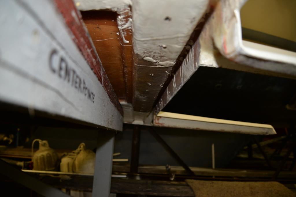

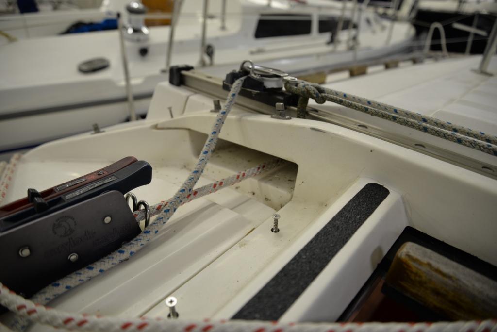

5: Seahood refinished with all 60 holes filled in and beautifully refinished by the glass boys at Centerpointe marina. The new track is mounted. The old screw holes securing the rail to the seahood were drilled out oversize to accept the new BOLTS whose heads slot into the new Harken track's T-slot allowing flexible positioning. The new bolts are now loosely slotted into the new track's T-slot and into the oversized holes in the seahood which is laid in place on the deck and secured on both sides to the deck pedestal columns, and because of the design of the hood you can reach under and apply a nut to one bolt on each side and tighten it. Now remove the pedestal end screws, lift the hood and tighten the remaining bolts to the sea hood. You can now reattach the seahood to the deck securely (4000 UV and a few strategic screws or through bolts rather than the 60 that were filled in and put the final end screw on each side of the track into the pedestal.

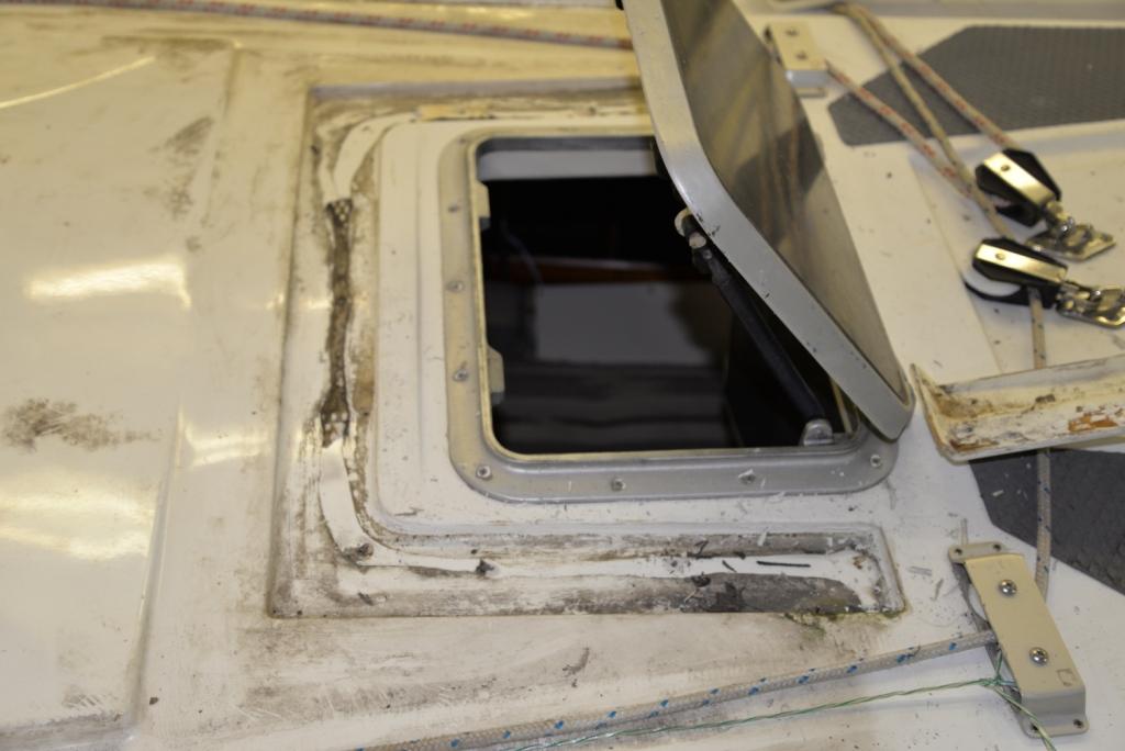

6: Bonus pic of the new Spinlock rope clutches I attached and the cam cleat for the main traveler sheet so I don't have to reach fwd to cleat and uncleat.

Thanks for that update and photos. I had to take the track off, that was day alone as the shafts of the 1/4-20 screws were seized (SS and aluminum don't mix well) in the track. Using dry ice I got all but 5 out, 4 I head to drill off the heads, the fifth and last one on the right, the Philips head had a hardened tool tip in it and couldn't be drilled. So I just used a hack saw to
cut into the track laterally to severe the screw.
Then, UNDER the track, I found two 1/4-20 2" machine screws holding the seahood down!!!!!! they are screwed into the fibreglass pedestal-waterdam. You can see the glob of 5200 on the aft end of that dam where the machine screws go in, and the right side screw hanging down from the seahood.
When I replaced the hatch, I had checked the threads in the glass, all ok so those 2 machine screws went back in with all of the 10-24 screws on a bed of 4200, with 4200 under the head of each screw. Too rain storms later, NO problem.
