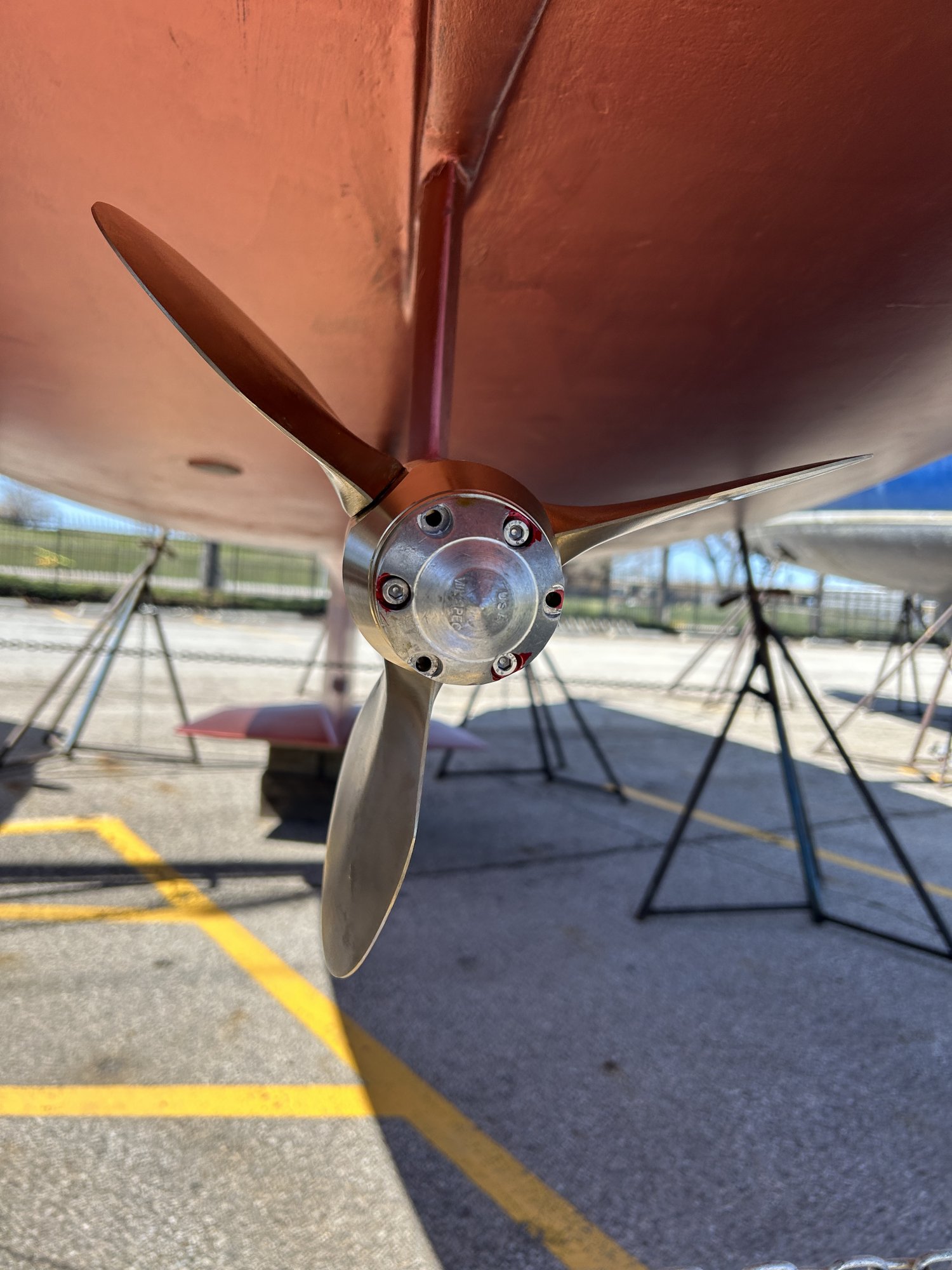

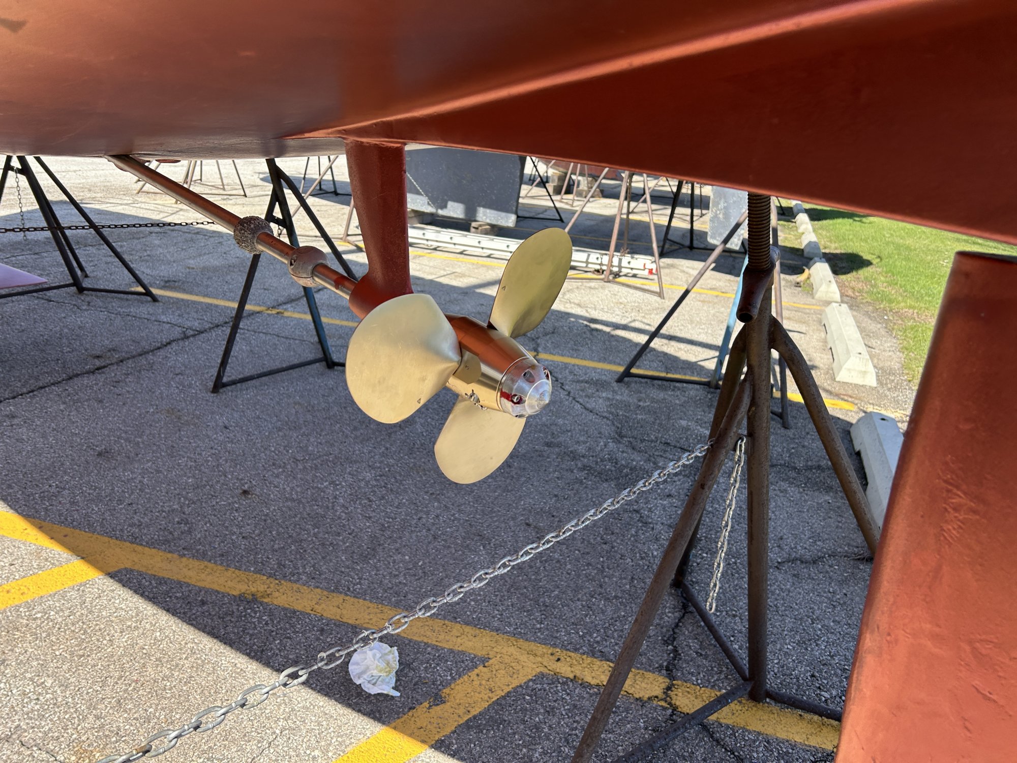

Why not consider a 3-blade folding or feathering prop? Assuming you sail, and don’t just motor, the feathering or folding prop will give you some extra speed when sailing. It will also stop the shaft from spinning while under sail.
I put a 3-blade MaxProp on Tally Ho last season and really appreciate the reverse thrust, the extra 1/2 knot of speed in light air, and the fact that the shaft is still while under sail. No noise and no spinning of the transmission parts. I also like the fact that the MaxProp pitch is adjustable. I am going to try to add small bit of pitch to my FWD setting this year to see if I can squeeze a bit more speed out of a given RPM.
Yes they are expensive, but they are a work of art ;)
