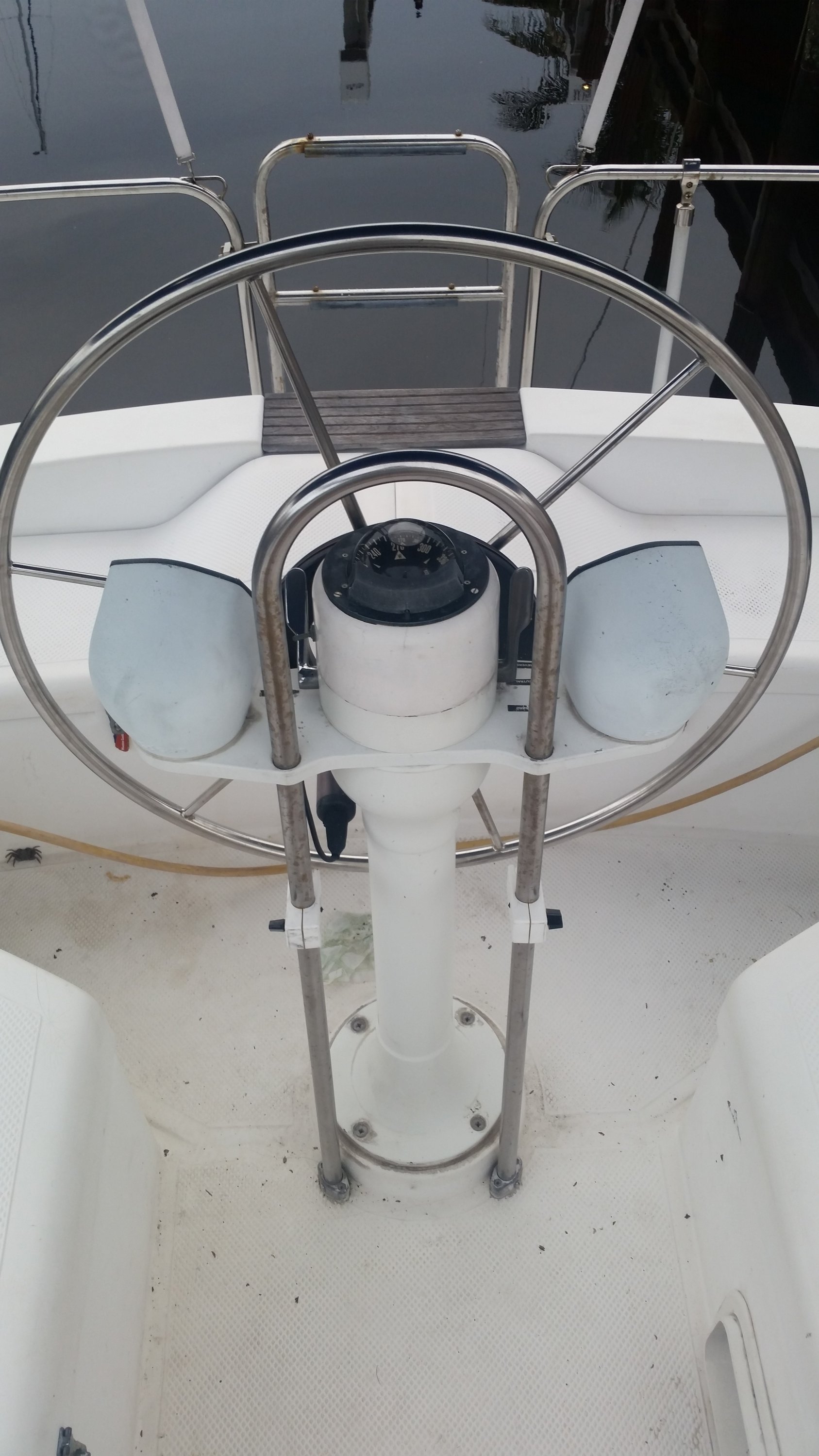

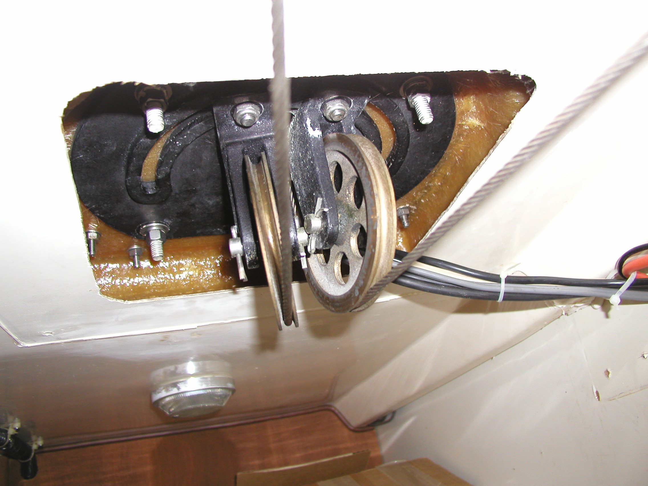

P7100343.JPG PC030469.JPG I drilled a hole in the guard and fed wire down the tube into the covered place in the aft cabin ceiling.
Thought I had a picture but I have nothing useful. Previous owner had run a power wire up through the pedestal tube and out a small hole in the pedestal tube. He had secured it under the clip that holds the shift and throttle cables in order to keep it out of the moving steering wires. I had to drill the fiberglass under the guard base to get the cable out.. I angled the drill bit into the guard to get the wire to go down.. I put a drip loop in the cable to keep water out of the pedestal guard.

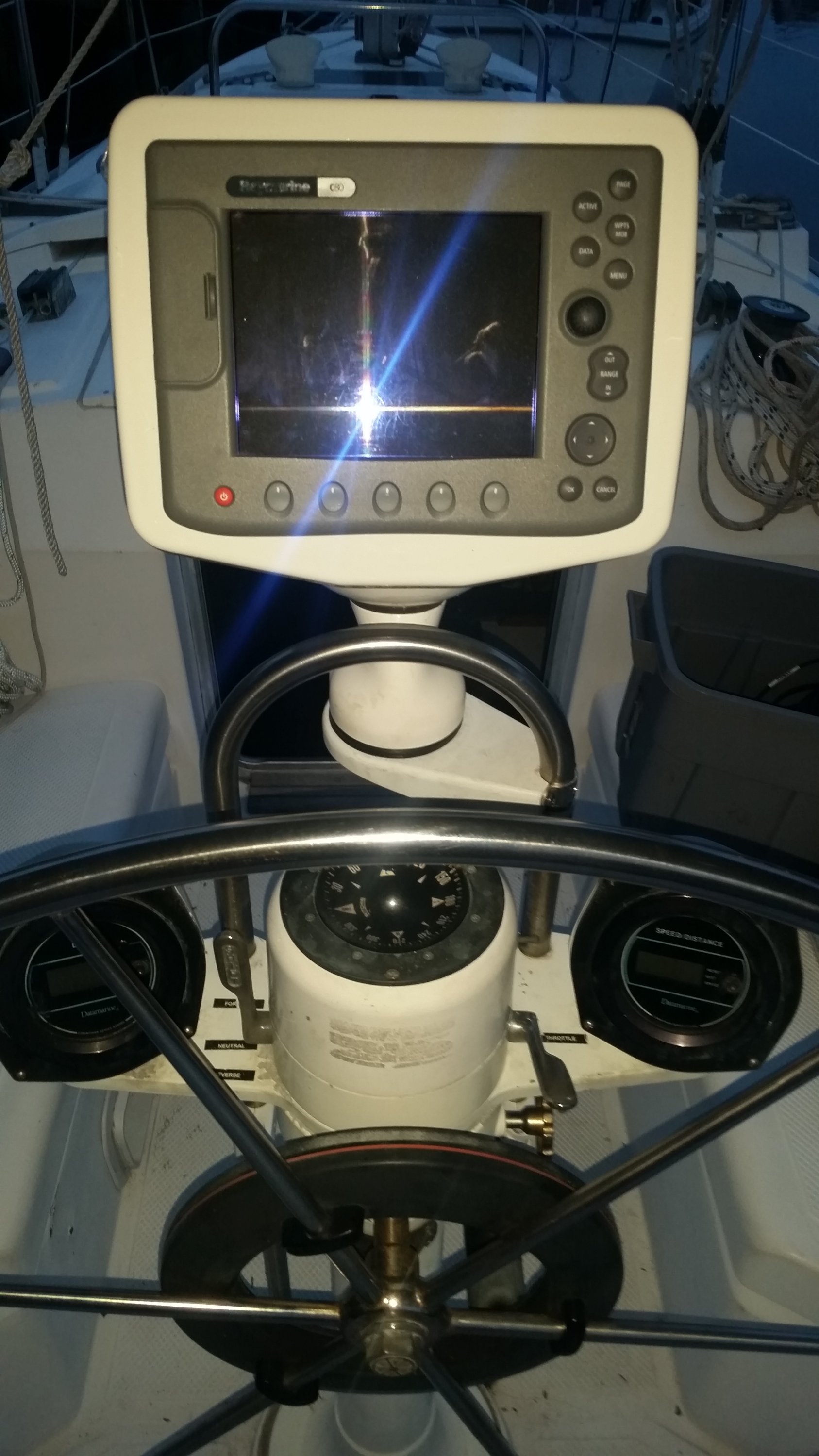

Below are pics of what I did for my Raymarine C80. I still have not routed the wiring since I am searching for a raystar 125 GPS module first. However, I am planing on adding a new waterproof thru-deck fitting next to the Binnacle guard rail.
