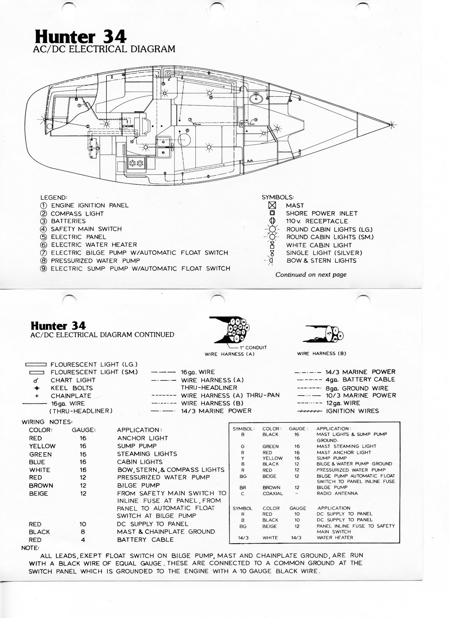

That is a strange one, Robbie.. my 34 does not have a breaker in that location. All breakers are on the electrical panel at the nav station.. The owner's manual for the 34 does not show a breaker there .. Electric diagram attached..
May 17, 2004
5,827
Pretty strange location for a breaker like you said. Maybe a previous owner addition for some unknown reason? Is there any change in wire gauge that would suggest the extra protection is needed there?

kloudie, I’m the original owner so it was definitely factory installed originally equipment and I was looking at the owner manual electrical wiring as well to troubleshoot my issue It’s exactly the same as what you posted and it doesn’t show it on the diagram either. I’m thinking that it has to be there for some electrical code compliance reason. Very strange, however the factory technician should have mounted it somewhere better, even if they would have mounted it a foot lower or inside the engine compartment would have made better sense. Were it is is so easy to inadvertently bump into it and trip the breaker. Maybe I’m wrong, I’ve owned this boat for 40 years now and never bumped into it before. However now that I know it’s there I’ll probably bump into it all the time lol.
