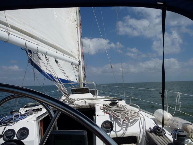

Thought I had a picture of mine (nope, didn't), but what you describe is what I have, essentially. From the aft end of the boom, the reefing line goes up to the reefing clew then back vertically to the boom and is secured there with a bowline or a couple of half hitches or whatever makes ya feel good The line is secured fair between the main foot slides..
10,093
Found it.. You can see the second reef line tied around the boom aft of the mainsheet bails
