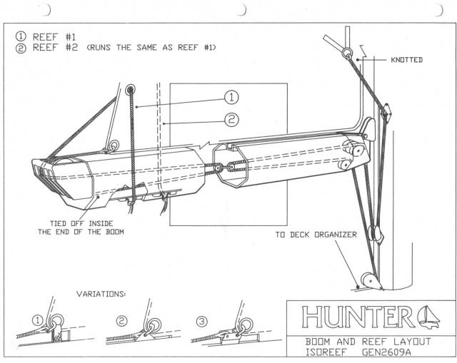

Here's a diagram of the boom that's on my 34. I sort of shows the inside of the boom and how it works.
Hope this helps a little.

That diagram is for an isomat boom with jiffy reefing. If you have a Kenyon boom then it is somewhat different. I will take some pictures and post them here. And yes you need to take both end caps off to gain access to the parts. Cheers

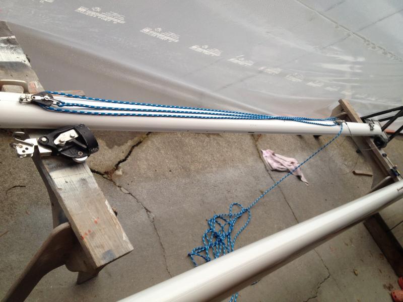

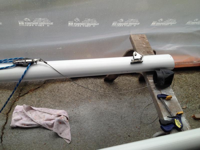

Kenyon Out Haul
My apologies for taking so long to post photos. You probably have the job done by now! What you are seeing is the workings layed out on top of the boom as they sit inside it. There is a bolt that holds a bail on the outside and extends through the boom and the fixed end of the block system is held with this.

Thanks. Great photos. You answered the big question with the bail bolt holding thr fixed block end. Thanks again.
