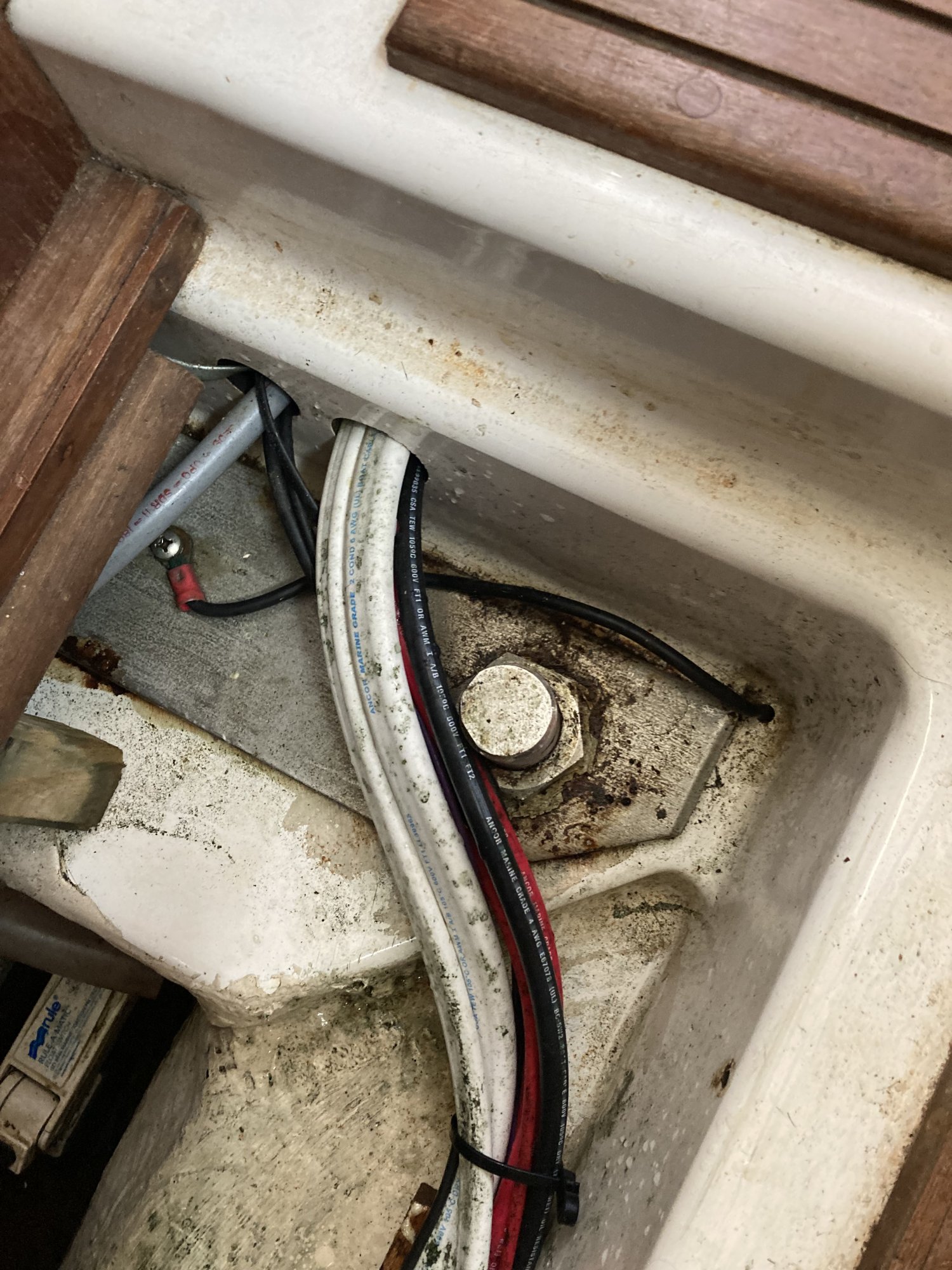

I have an ‘86 H34. The keel bolts, actually they are 1 1/4” stainless steel studs with nuts over stainless backing plates, appear to be in good condition. I inspect them frequently and keep’em clean. I checked torque in 2020 and was able to snug a couple just a tiny bit.
I repaired a keel smile a couple of years ago and I’m concerned about crevice corrosion on the two studs at the fore of the keel - located in the shower pan. I’ve researched here and the internet/YouTube, etc. and can’t find any info on dropping the H34 keel. Though there’s tons of info on dropping keels, both lead and iron, it seems most studs in iron keels are mild steel, not stainless. And all of the photos and videos I’ve seen show quite a number of studs in the keel.
My first question is, how many bolts/studs are there? I count only 5 on mine. Two at the fore, two in the main bilge toward the aft end of the keel, and one at the aft end. (I can’t seem to find a definitive answer). I used an endoscope to look forward from the bilge through the limber holes and don’t see any under the sole. And I didn’t see any in photos where folks replaced their sole. Are there really only 5?
Second question - are the studs threaded into the cast iron keel? And if so, has anyone successfully unscrewed one to replace it?
Stainless steel threaded into cast iron for 38 years might be a problem. There are a number of suggested techniques to remove mild steel studs. But I find nothing on removing stainless studs.

First question that comes to mind - are you sure you don't have a lead keel? I thought most Hunters from that time period used lead keels.
Second question, got photos of your keel bolts?

@Colibri - yeah - right after I posted that question I realized I was thinking of the earlier hunters. Maybe @Crazy Dave Condon knows how those keels/keel bolts were put in.
The picture sure looks good of the one you've posted. Where do you plan to sail that you are concerned with loosing your keel? It would seem to me, unless you are planning on crossing oceans and will be off shore for extended time frames, just keeping an eye on your previous fix would give plenty of advance warning if there was some sort of problem. Checking torque once a year would also give an indication if a bolt was failing.
Unless I had a tangible indication those keel bolts were beginning to break, I would leave them as they are.
