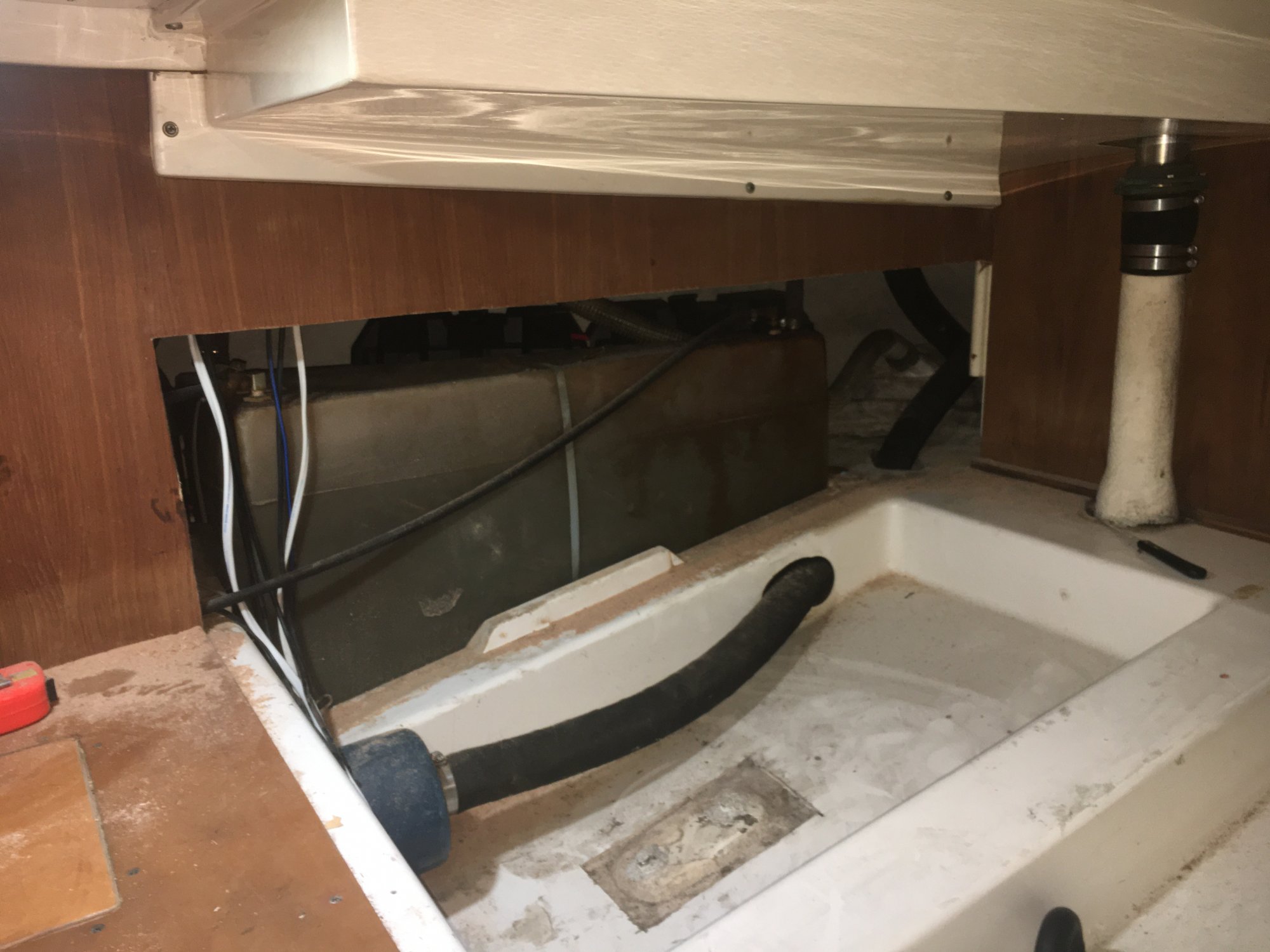

I know it needs to be replaced, I know what and where to buy the hose and mixing elbow, and I know there may be some cleanup. However, I want to know how to access the muffler and rear hose, can it be accessed from the starboard locker, or do bulkhead s need to be removed? tia
You will need to remove the floor in the aft berth which also requires removal of the aft wall panel. The photo shows muffler mounted in a stringer beam and exhaust routing under floor to starboard locker.

Before demolishing the boat, can you attach a tracer line to the hose where it attaches to the thru-hull and then pull the tracer back to the muffler ? The tracer can then be used to pull the new hose through to the thru-hull. Somehow I doubt any bulkheads have to be removed as the hose was likely the last thing to be installed in the boat at the factory. Follow @RoyS recommendations in his post #6 for fittings but only if necessary.
@Charlie98117 's photo looks quite doable with a tracer unless the remaining routing is more difficult.
Photograph and send pictures starting at your muffler outlet and going to the thru-hull so we can get a real life picture of what you're dealing with. We don't know the year of your boat and you may have a different setup from the pics we have seen so far.
