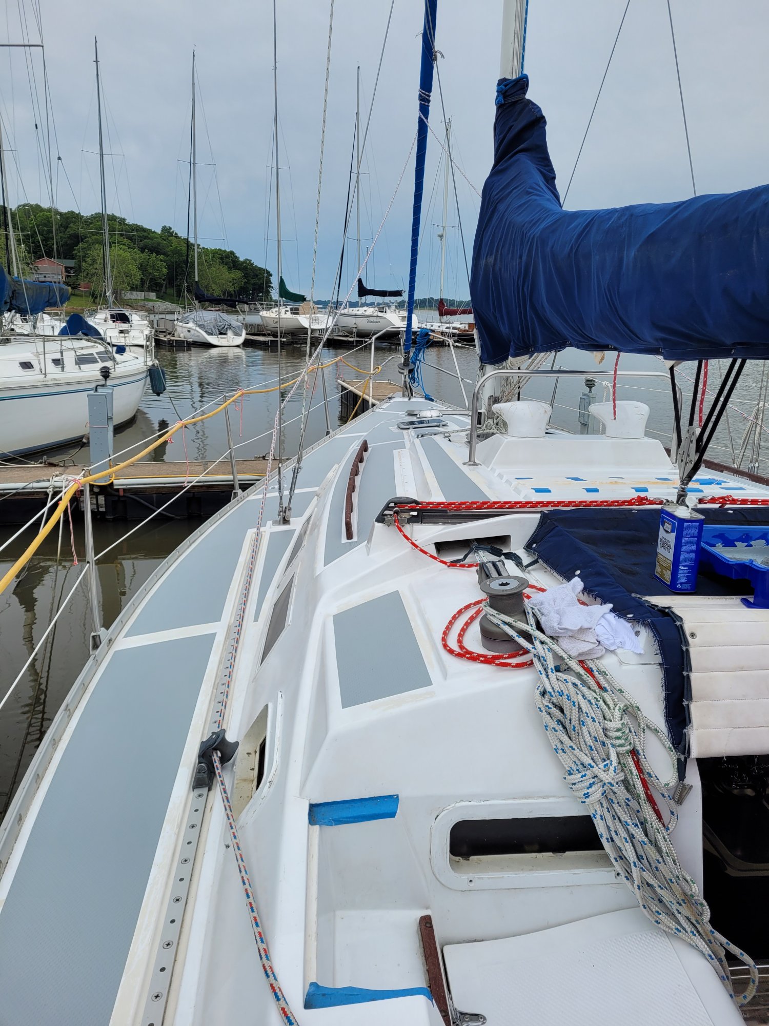

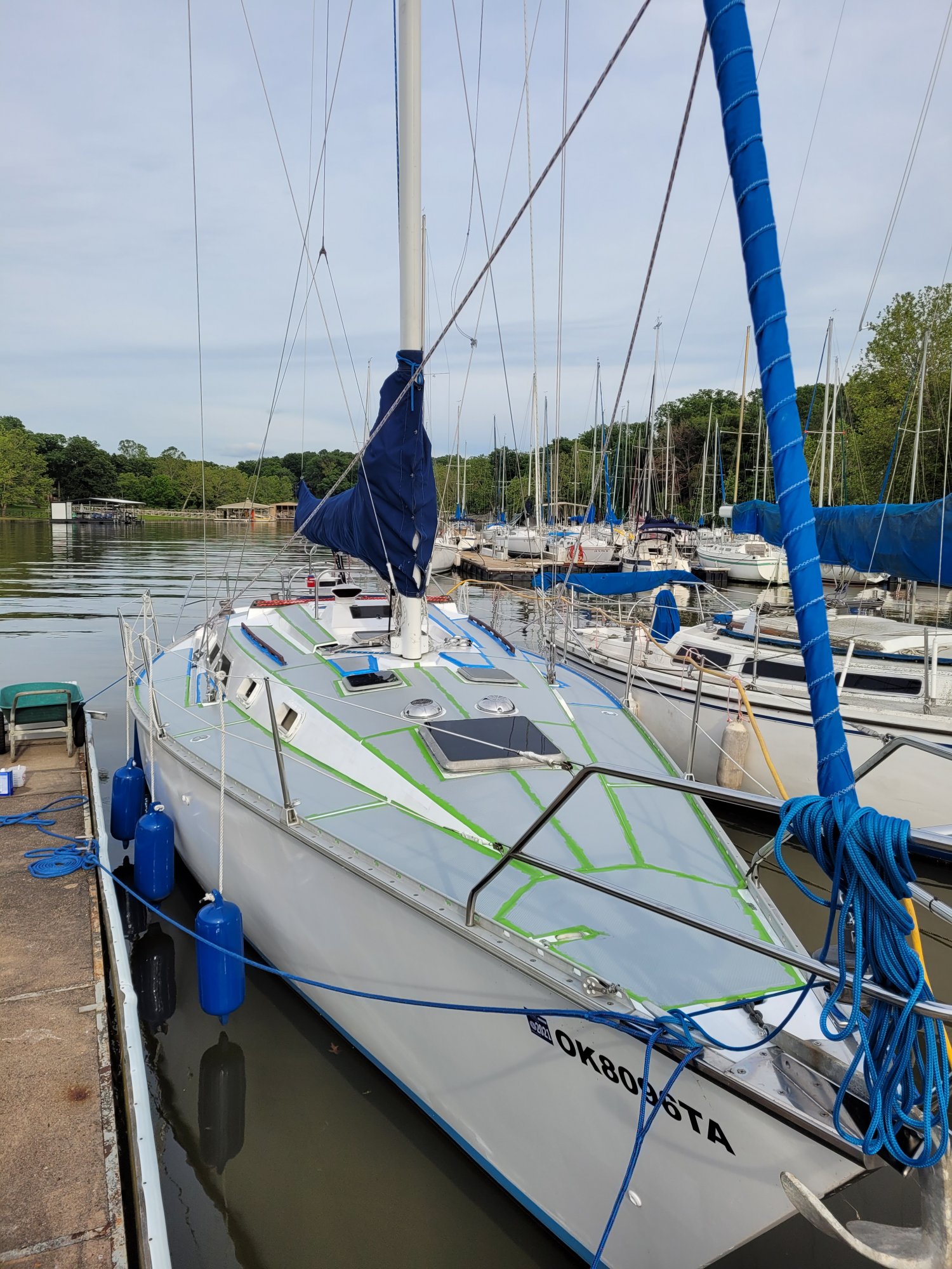

We did Total Boat Total Tread in light gray. I don't have experience with any other non-skids though. It went on well, 2 coats, and has been very durable except where my wife accidentally hit it with the orbital when working on another project - at least its easy to touch up. We only scuffed with 80 grit and did not do the recommended primer. I probably would if I were to do it again just to get the extra longevity. The grit doesn't hurt bare feet but it does actually get pretty hot. If I were to go again I would choose white the next time around.

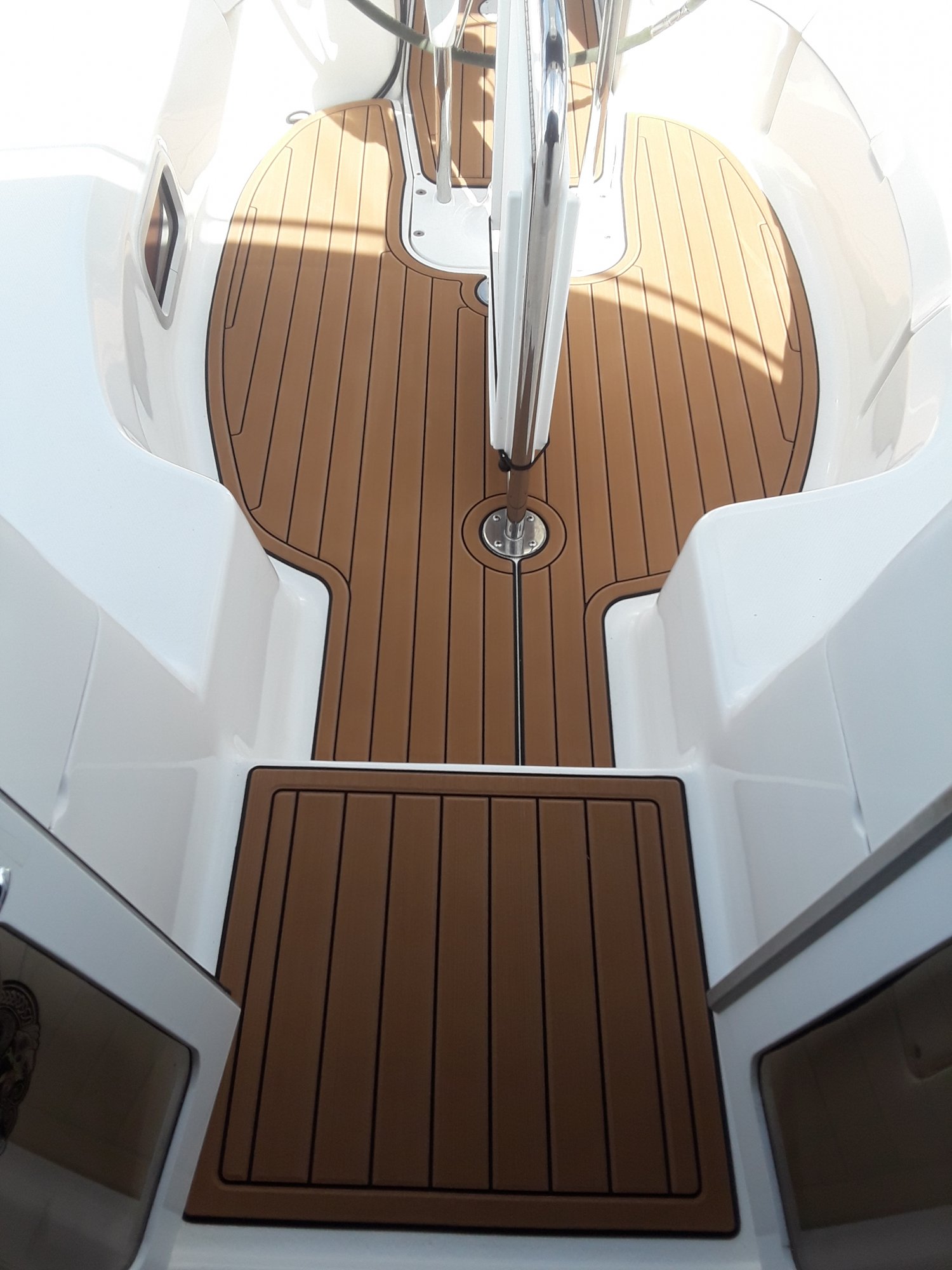

Whats the name of that specific synthetic teak product? I've seen many, and gotten samples of Lonseal before, but in hand it looks very "fake". The picture you shows looks way less like a roll of plastic.

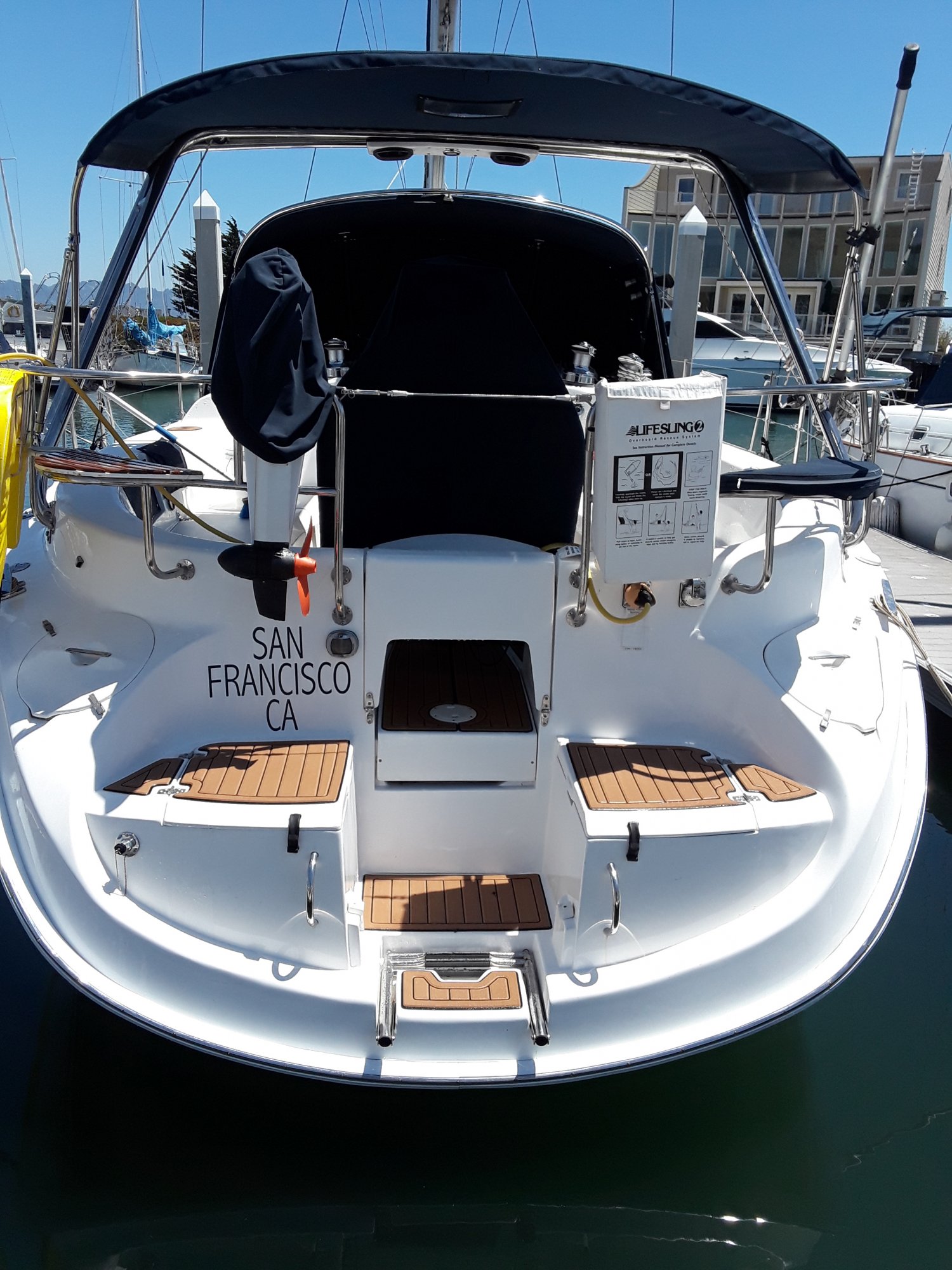

The synthetic teak we used was manufactured by PlasDeck. They have a DIY section that has everything you need with installation videos and instructions. We were hesitant at first because the adhesive that you put down is this thick black goo, and we were afraid of ruining our deck. After we worked up the courage, it was really fairly easy. The material cuts nicely with a hook blade utility knife and the excessive adhesive goo cleans off of the fiberglass with denatured alcohol (really not lying!). Speaking of cleaning off the adhesive, the process of wiping up the excessive adhesive works some of the color into the "grain" making each plank look slightly different. So it looks better once it's been installed than when you first see the rolls. You can san it to smooth edges just make sure to sand with the direction of the grain.
Hope this helps! We are super pleased and it provides a lot more grip than the old non-skid!
