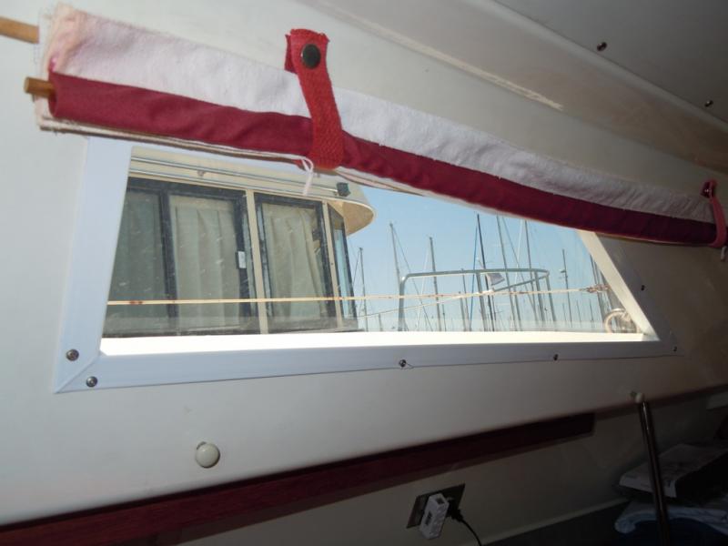

Our original curtains (still have them) are pleated so they can fold up above the window and are secured with snaps. The buttons below the windows are for an elastic loop to hold them down and against the cabin top.
There are also wooden dowels at the top and bottom of the curtain to give rigidity an weight to hold them straight.
10,067
H 34 Curtains
Mine are really simple and a lot like Allan's .. They roll up and have a loop on the back to go over the top buttonto keep 'em rolled.. Unrolled, that same loop can be wound 'round the button to hold the bottom against the cabin side. There are dowels in the top and bottom. I suspect these were original ..

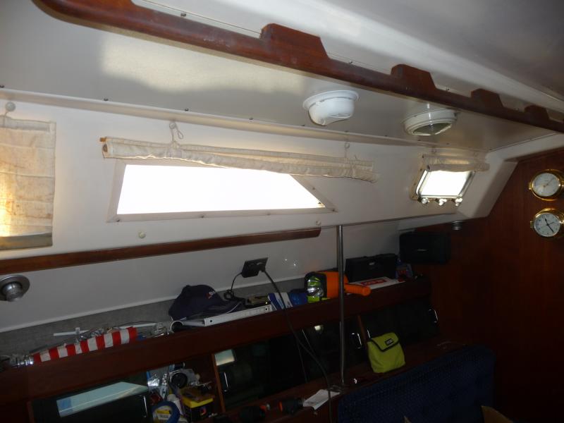

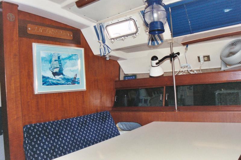

Previous owner installed blinds across the fixed ports and small "curtains" on slider tracks over each of the main cabin's opening ports. See pix...
