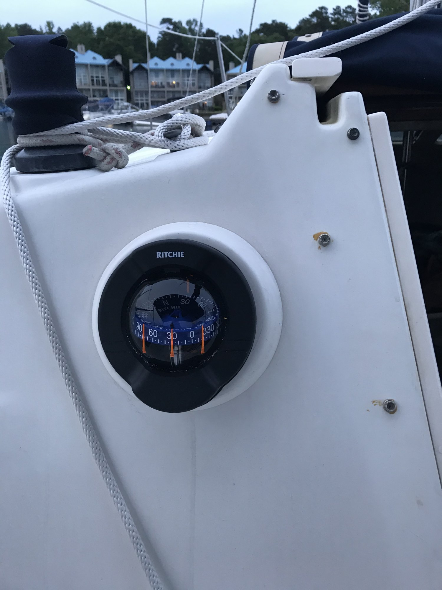

Hello, Rich!
I replaced mine with a Richie Powerdamp Plus with a blue card. It is a fairly heavily damped compass for high speed powerboats, but I figured it would be fine on a sailboat. I believe the mounting circle , the screw circle, is 5 1/4” . It was on sale at West Marine a few years ago at a great price, so in it went.

Thanks Kloudie- that helps a lot - a specific model that will fit.

Well, I think I found a solution. I installed a Ritchie F83 yesterday. The screw holes fitted, The diameter fitted fine. I have to check whether the light is working but the seating and the fit were really easy. Cost was pretty good- 209$
