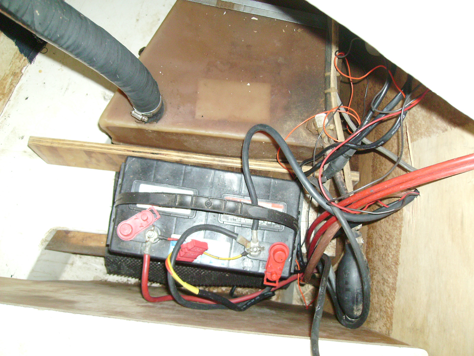

Hi;
Has anyone changed the battery location so they are more accessible? I am getting to old to climb into the rear locker or hang upside down to check the fluid and terminals. Have even thought about switching their location with the water heater.
Thanks. Ilan

I agree the "pit" makes an inconvenient location. I had thought about putting a house bank under the port settee, but ended up drilling a hole through the bulkhead and running the leads for the bank through there.
I am not really comfortable with the way the battery sits on the port side.

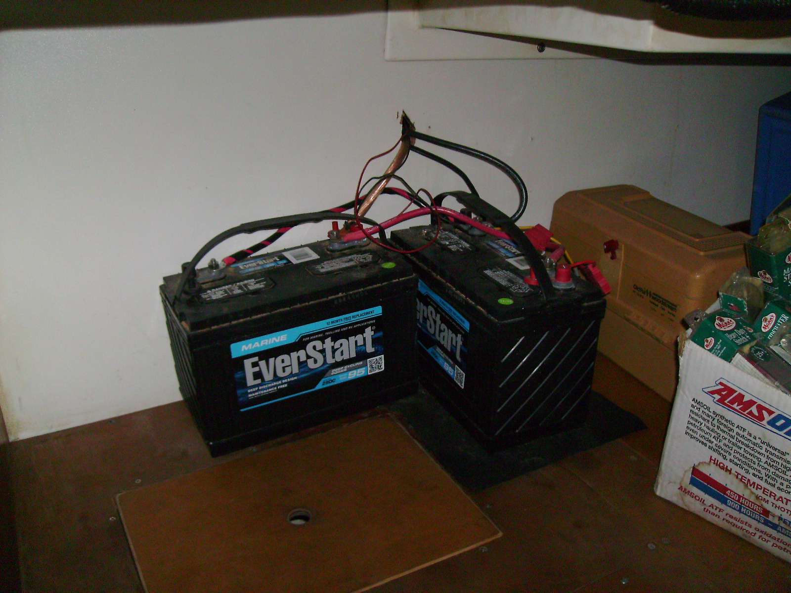

Ilan,
Here is the link to my battery relocation project. Its the third response down from the original post.
If you still have the original holding tank, then the starboard settee next to the water heater is an acceptable location. I left my starter battery in the cellar as its maintenance free and you don't have to service it. My four house batteries (all 6V) are now fitted with automatic watering systems that works great.
http://forums.sailboatowners.com/index.php?threads/adding-house-batteries.131515/#post-829451
Allan

This is one of those common subjects for the H-34 and an improvement that I am planning on doing myself. I plan to move the batteries under the port settee both for ease of access and better overall weight distribution. Definitely worth the effort. I also like Allan's idea of creating an access hatch from the aft berth into the starboard locker. No more tumbling down the rabbit hole to get a fender.
