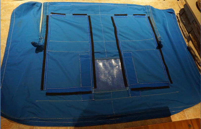

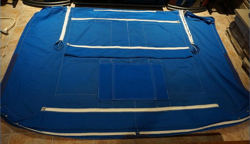

If your radar pole does not interfere with the bimini frame it's simple enough to have the canvas cut around and a zipper or velcro installed to close the aperture around the pole and to the side or back of the bimini. Pix 01 A shows the upper side of the bimini with the black velcro for the solar panels. On left and right side you'll see a zipper and velcro going to the rear of the bimini. That allows installation around the double back-stay and the funnel like piece is velcroed around the back-stay preventing water ingress. Pix 03 A shows the inside part of the bimini (i.e above your head). The zippers and pockets are clearly visible. Good luck.
