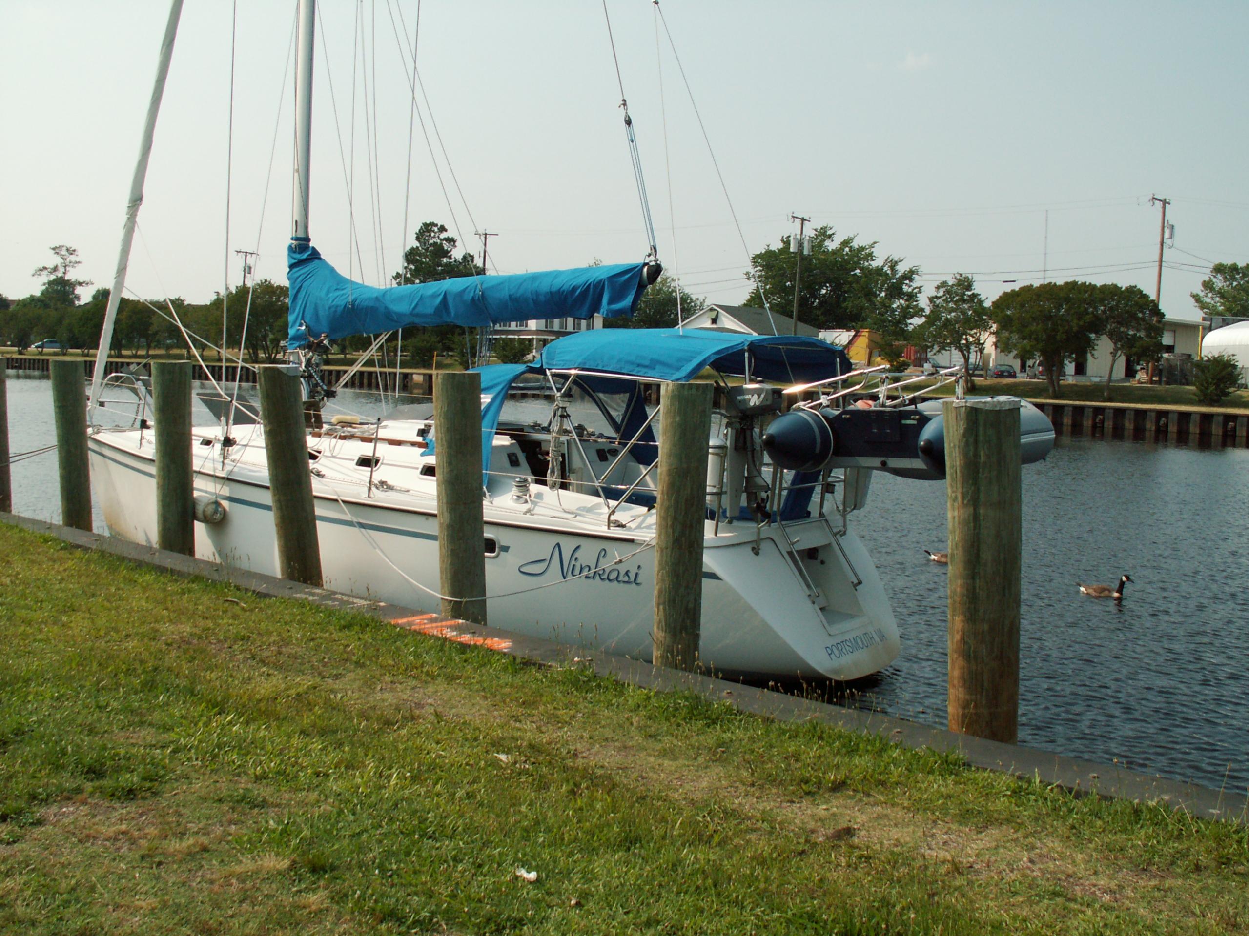

We installed Martek
Although Ninkasi, our 1988 33.5, isn't like the newer walk thru transoms, , I purchased and installed a Martek 370 davit system with 4:1 ratio lines, stabilizer bar and cam cleats while in FL last year. The unit is well constructed and reasonably priced. We traveled the ICW home to Norfolk, VA with the dinghy riding well in the davits. While in FL we raised the dinghy complete with motor over night. Having the davits sure saved on cleaning the dinghy bottom.
www.martekdavits.com
