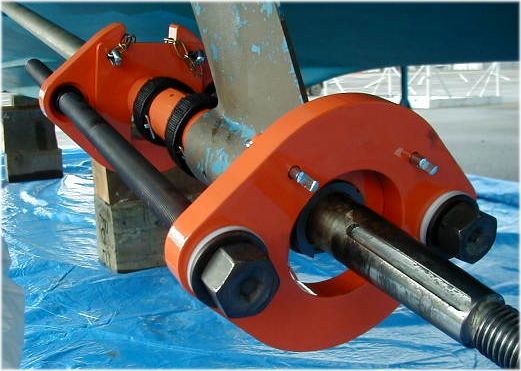

Bearing Size 1" X 1 1/4" X 4". If you have a friend who can lend you the tool it can be easily replaced without removing the strut, a big time saver.

Thank for the size info. What does the tool look like and are you able to explain the procedure for removing the cutless onthe 33.5

After removing the prop and set screws the old cutless bearing is pressed out and the new one pressed in. With this tool the whole job should take less than an hour. The alternative is removing the rudder.
