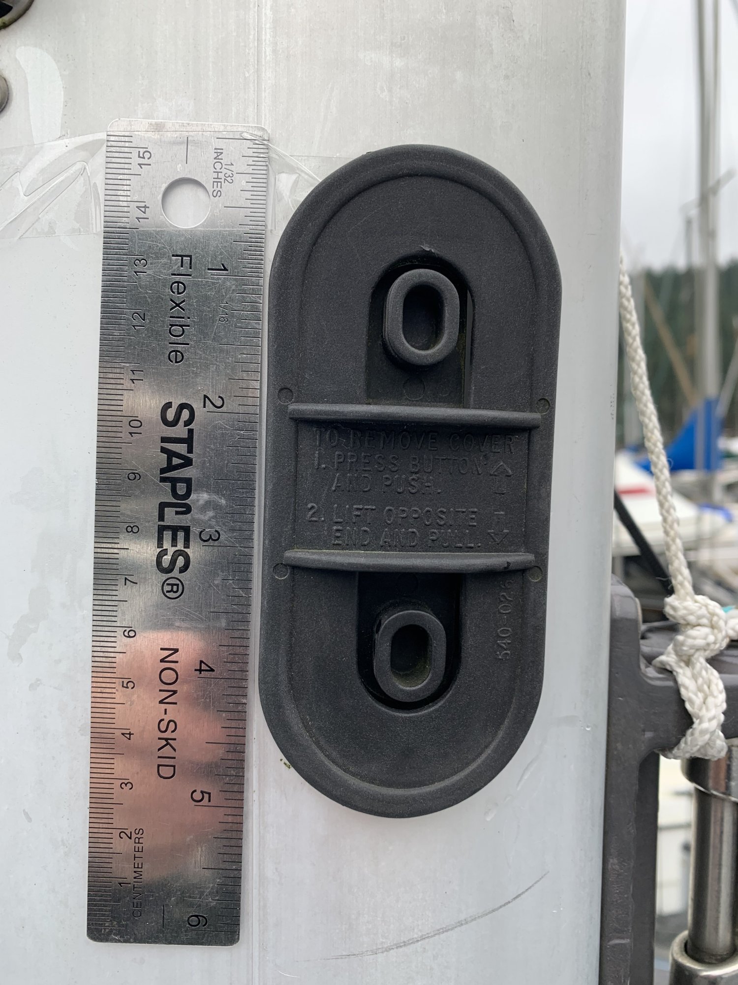

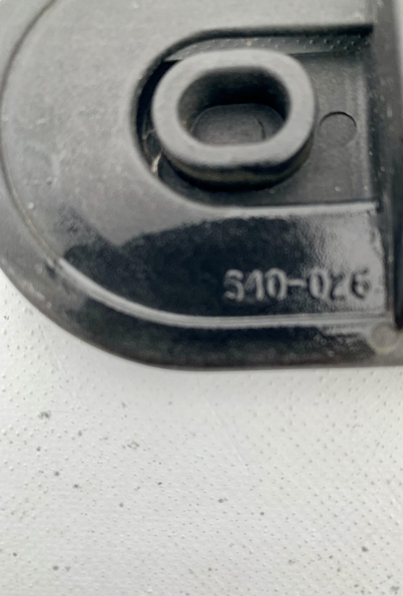

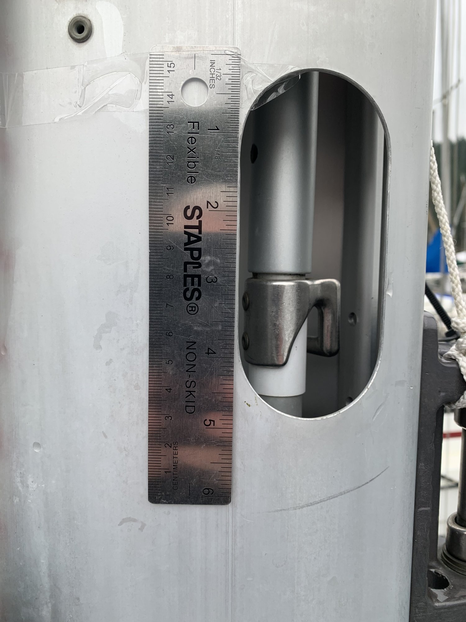

I will measure the covers on my 2012 H33 Selden infurling mast tomorrow if that will help. As far a supplier in Canada, any rigger should be able to source for you; however, Marine Outfitters in Kingston is a good place to retail from.

I ordered a replacement directly from Selden. I don't recall a choice in size.

Our local library does 3D printing for the cost of the materials. I had 2 Selden 100S furler flanges printed 3 months ago for a total of $5(Cdn), taxes in. Almost identical to the OEM which retails for $61/each + shipping + taxes from Marine Outfitters.
Here is a free printing file for the cover I think you require. May be worth the time and effort to ask around. Most 3D printing outlets give you a choice of material and colour to use for the item.
Selden Small Cover Plate - Thingiverse.com
