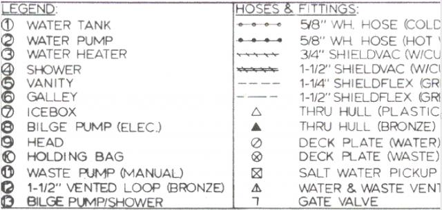

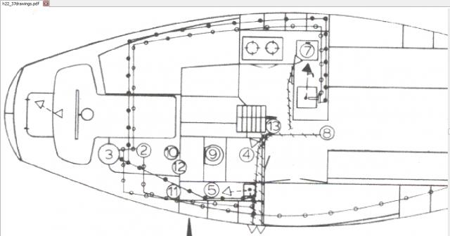

The bilge in the engine compartment is a separate shower bilge. A separate bilge pump with a separate bilge hose and exit drains this bilge. If the boat does not have this bilge pump it should be added to make the system work. The attached Legend - look at #13 and the plumbing diagram show the original design.

Paul - this was helpful One time I saw the full set of diagrams for the Hunter 33 (1981) as you have here - do you have the link for the full set ? Doing some wiring
