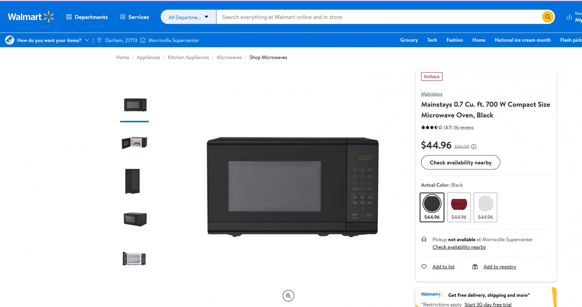

Until recently it was nearly impossible to find a replacement for the small microwave installed in the Hunter 326 and perhaps other models. Now there is one that fits perfectly on sale for just $46 at Wallmart.
