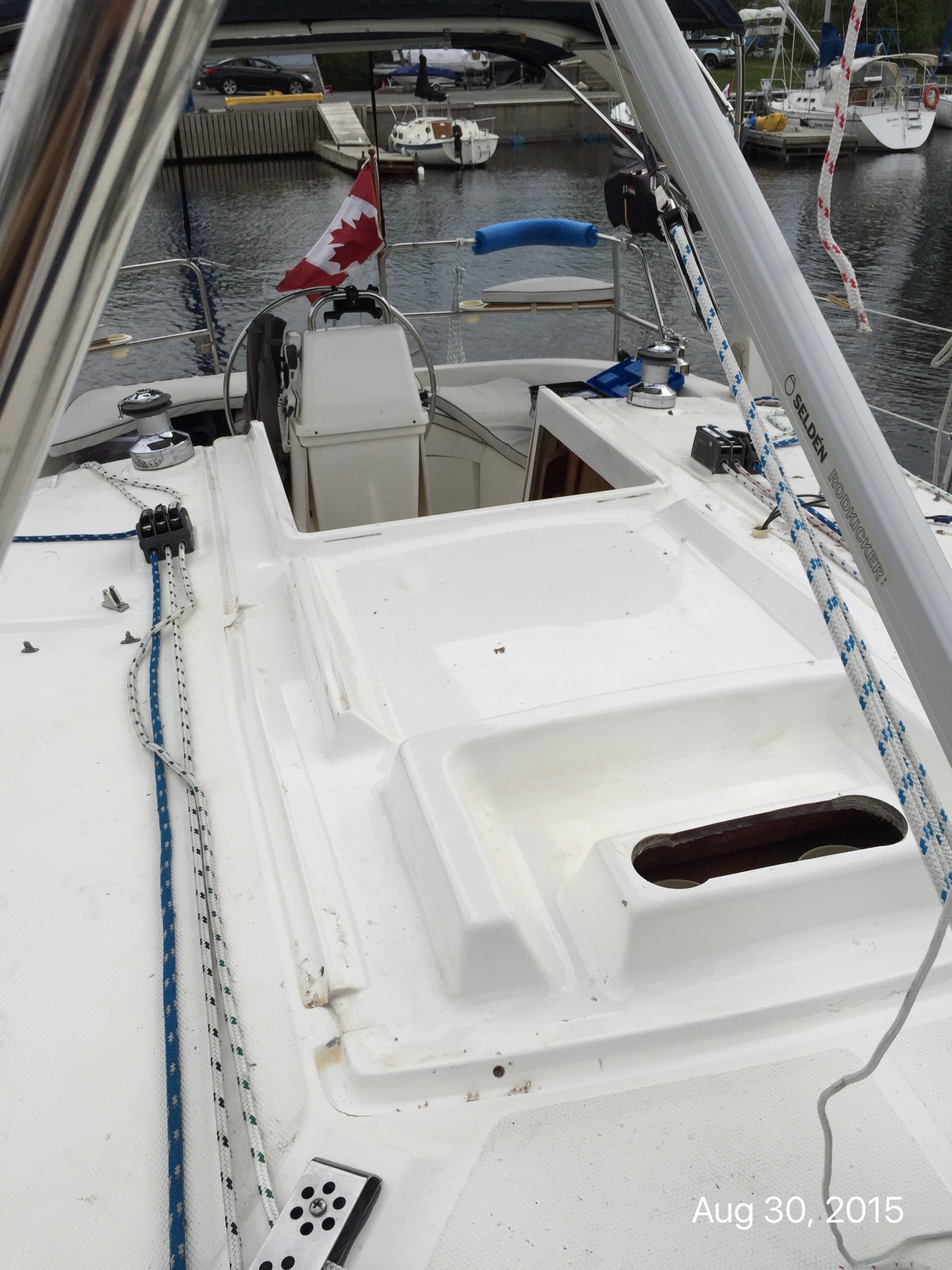

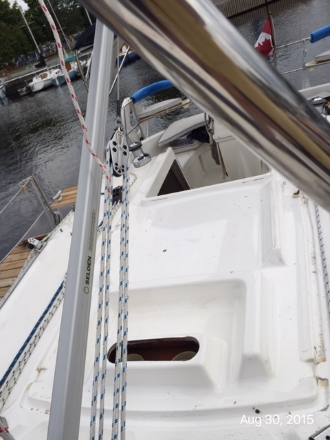

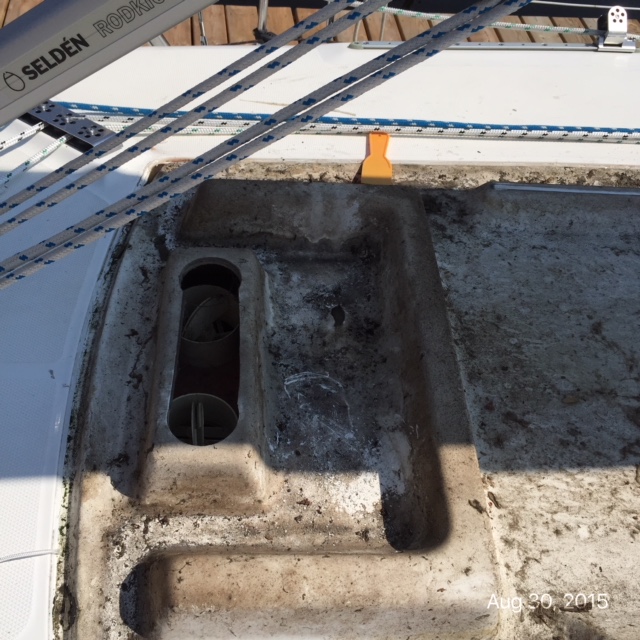

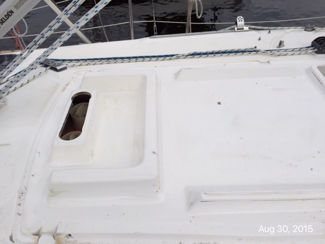

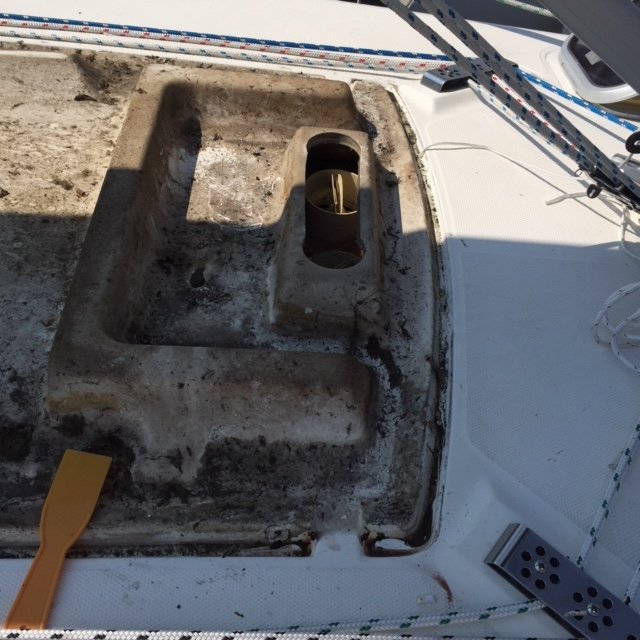

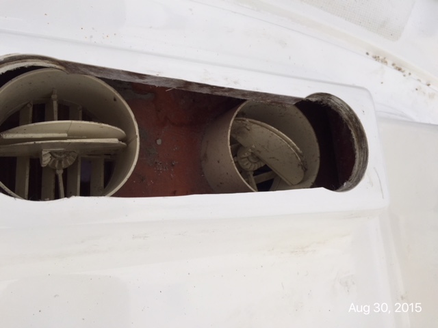

Hi Ralph

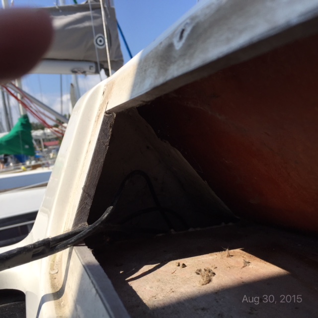

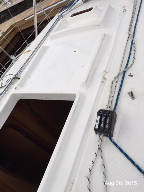

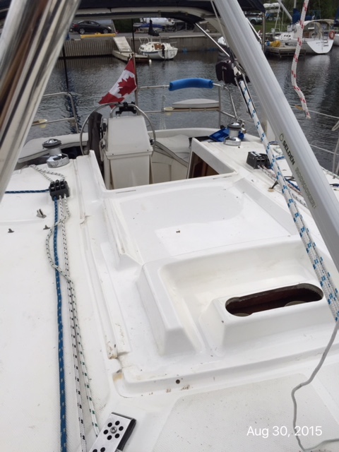

This is all I have. When I re installed the hood I didn’t caulk the border at all as there didn’t seem to be any reason for it. I did have to refill and redrill the screw holes as I found water was leaking into the cabin through them. It was the search for the leak that prompted me to remove the hood in the first place. Removing and re installing the hood is not difficult.
Tim

Tim,
Thanks for the excellent collection of shots. I presume the darker ones show the accumulation of grunge before you cleaned out the interior.
These will be most useful for removal this summer.

Yes, the grungy ones are the before cleaning but after I removed the wasp nest!
Tim

Wow !
lots of difference between before and after, can't wait to do the job. thanks again for the photos.
