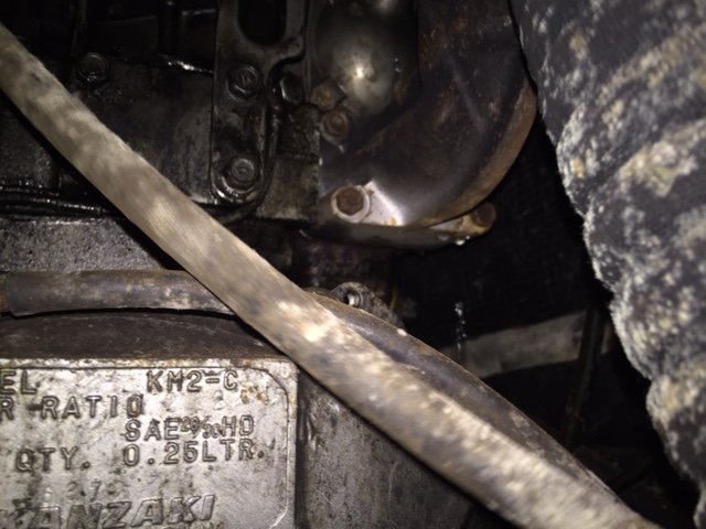

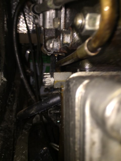

Hello everyone. I performed a inspection on a 1986 Hunter 31 that I currently has a offer in on. The engine started very easily after sitting for about 10 years. I noticed a steady drip of water (drip every second) during operation from the left back region of the engine. Without a right angle mirror I could not see exactly where it was coming from. I have attached two pictures and included a page from the manual with a red circle from the estimated area where it is coming from. I have a survey scheduled for Monday but just wanted to get a idea in advance if this is a area of comment gasket failure or if this could potentially be a cracked block. Thanks again for all the help.

Impossible to determine from the photos, except the last photo show clear water, and this is a 2GM20F, which should have antifreeze. This makes me think the leak is in the external cooling circuit (salt/lake water). Maybe the exhaust elbow hose connection?
You need a mechanic to definitively determine the cause, meanwhile wine like crazy and negotiate a lower price.
10,108
Like MZ says, could be a lot of different stuff.. Ya need to determine if the "water" is water from outside the boat or water from the coolant (antifreeze) side of the engine. The little valve that you circled is a drain valve to allow coolant to be drained from the heat exchanger housing.. Just above and aft , the little hose that connects from the back of the heat exchanger to the exhaust elbow, same one that MZ is talking about . Sometimes this hose has an anti-siphon valve in it that is a problem child but can usually be cleaned .. Check it and connections and the heatex end caps.. Ya need someone familiar with this engine because that could be $2 or $2000 to fix.. And do whine like ya mean it..

After using a mirror on the stick I tracked the error down to a hose fitting on the heat exchanger. Easy fix. Thanks for your help
