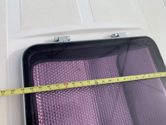

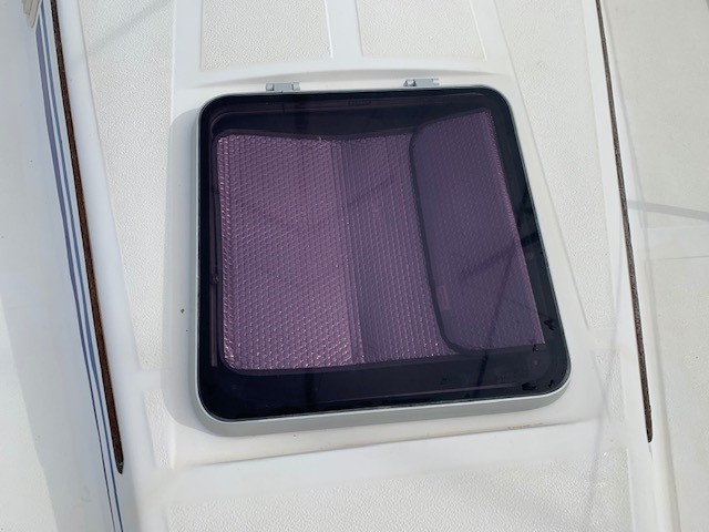

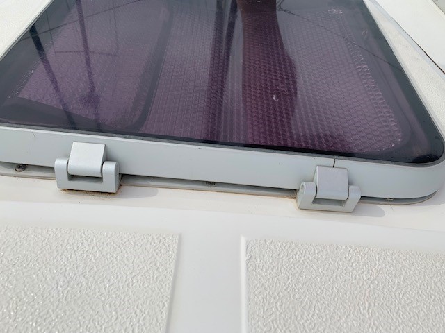

I own a 1985 Hunter 31 and need to replace the front hatch. Unfortunately it was open and a jib sheet caught it while coming about and "tweaked" the hinges. It closes and stays dry, but I can't open it easily and keep it open. I don't see any markings indicating a manufacturer, and no exposed fasteners. Not exactl sure how to take this one one. The hatch glass measures approx 21" square.

Remove the hatch and measure the inside cutout dimensions, then match that with the replacment hatch. If you just want to repair the hinge Hatcmasters Hatch Repair - HatchMasters might be able to do that.

The same thing happened to my hatch which is a bomar I wound up replacing hinges, Check out https://pompanettellc.com for the hinges they are a pain to replace but will take care of your problem. look under spare parts
