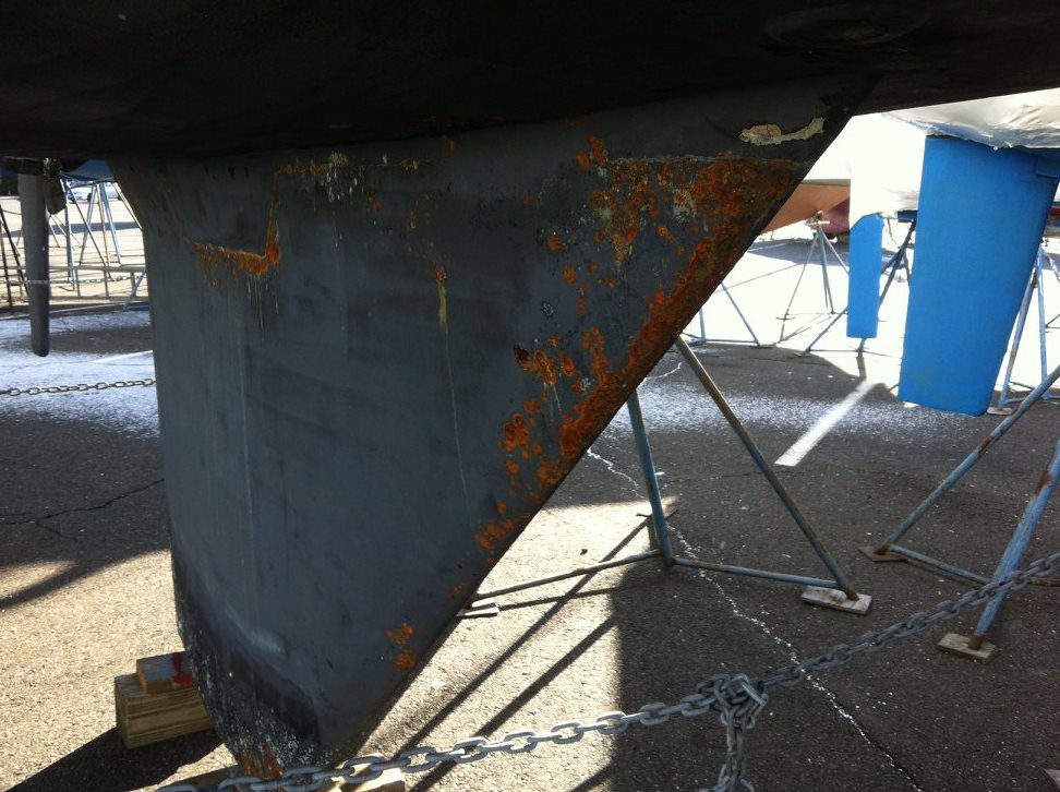

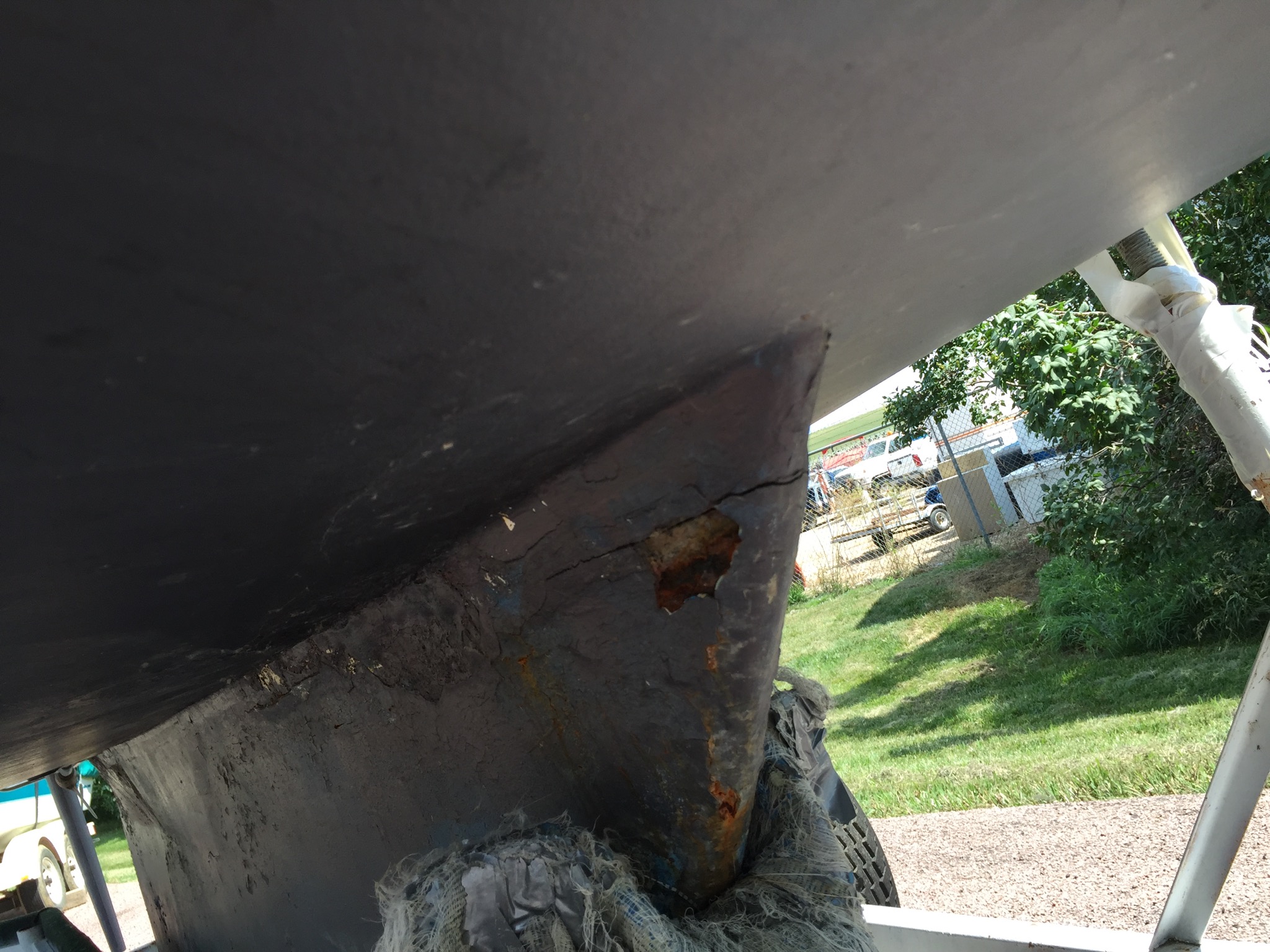

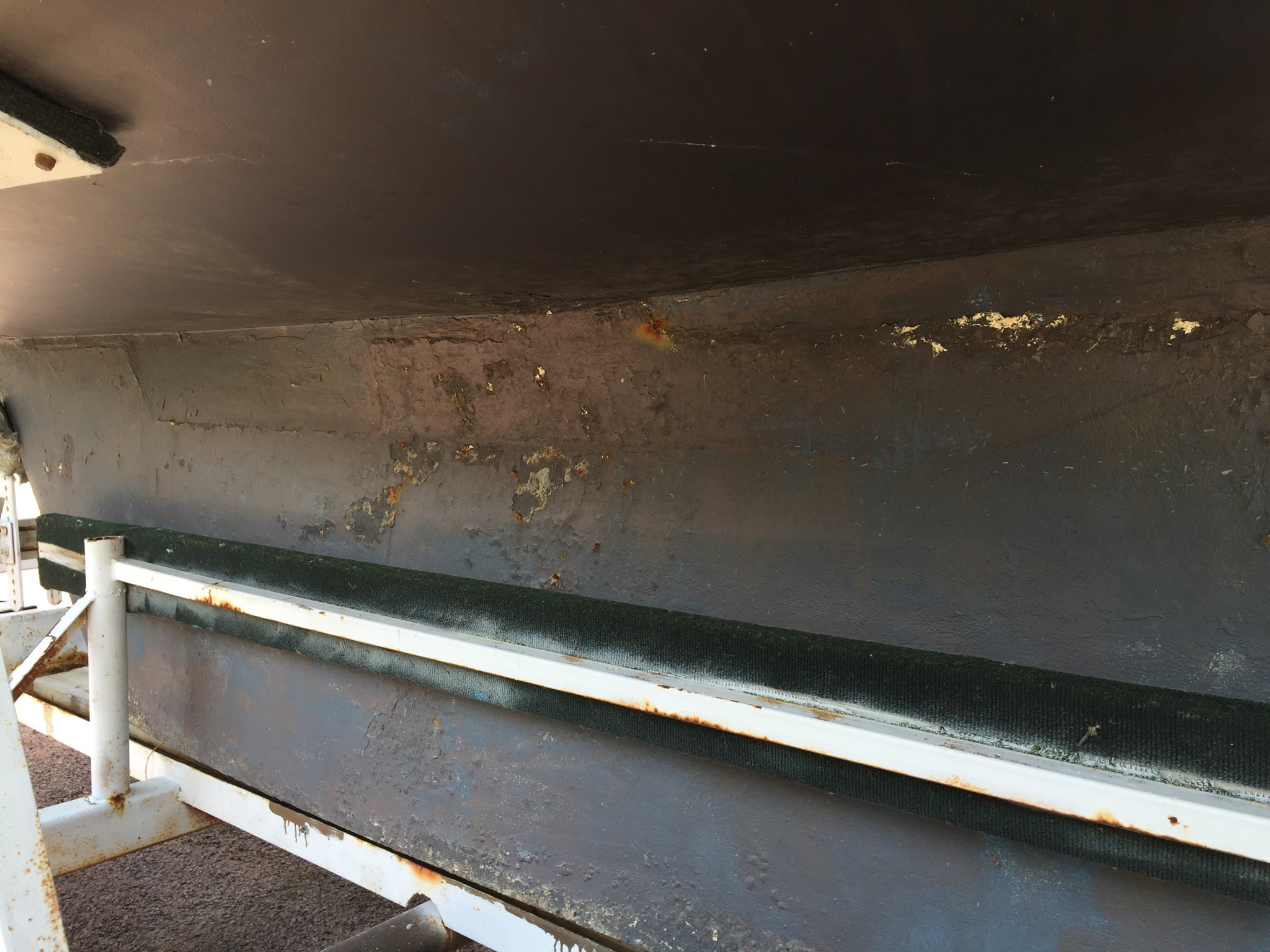

I'm interested in opinions on the attached photos of the iron keel on this Hunter 31. I'm considering purchasing but am very concerned about the integrity of the keel. There is some separation at the keel to hull joint which I understand is normal, but the crack at the leading edge looks like it's possibly been repaired and then failed. Possibly grounded?
Dec 25, 2000
5,851
Hi Bradv, it is abnormal for a separation in the keel stub joint. It looks as though something caused the joint to open up. If it were my boat I would have a marine surveyor assess the joint integrity, possible repairs and estimated costs. These should be taken into consideration towards the purchase of the boat.
Jan 1, 2006
7,349
Slickcraft 26 Sailfish
So far as I can tell the fiberglass hull at the front of the keel and aft end is undamaged, which would be unlikely if there was a hard grounding. Before engaging a surveyor, I would inspect the bilge around the keel carefully with a strong flashlight to look for damage to the tabbing around the keel stump. If the tabbing has separated then a hard grounding is likely and repairs could be a substantial expense. If the tabbing in in tact, and you like the rest of the boat, it's time for the surveyor.
The crack at the front looks like separation of the keel from the keel stub. I can't tell from the photo if it is the keel itself, which would be unlikely. Keel stub repairs are highly suspect because few do them by taking the keel off and rebedding the whole keel. More likely some goop de jour was pumped in, smoothed and painted. In any event that iron keel will have to be stripped down to metal and treated with layers of epoxy or other anticorrosion technology. You're probably going to drop the keel if you buy this boat.

Thanks Shemander! I agree that it looks like some repairs were done over the crack and they've given way and released from the iron. When I get back to the boat (without the owners standing there watching) I'd like to scrape this area and see if epoxy or gel coat material comes off before I get to iron.
Apr 27, 2010
1,277
Hunter 23 Lake Wallenpaupack

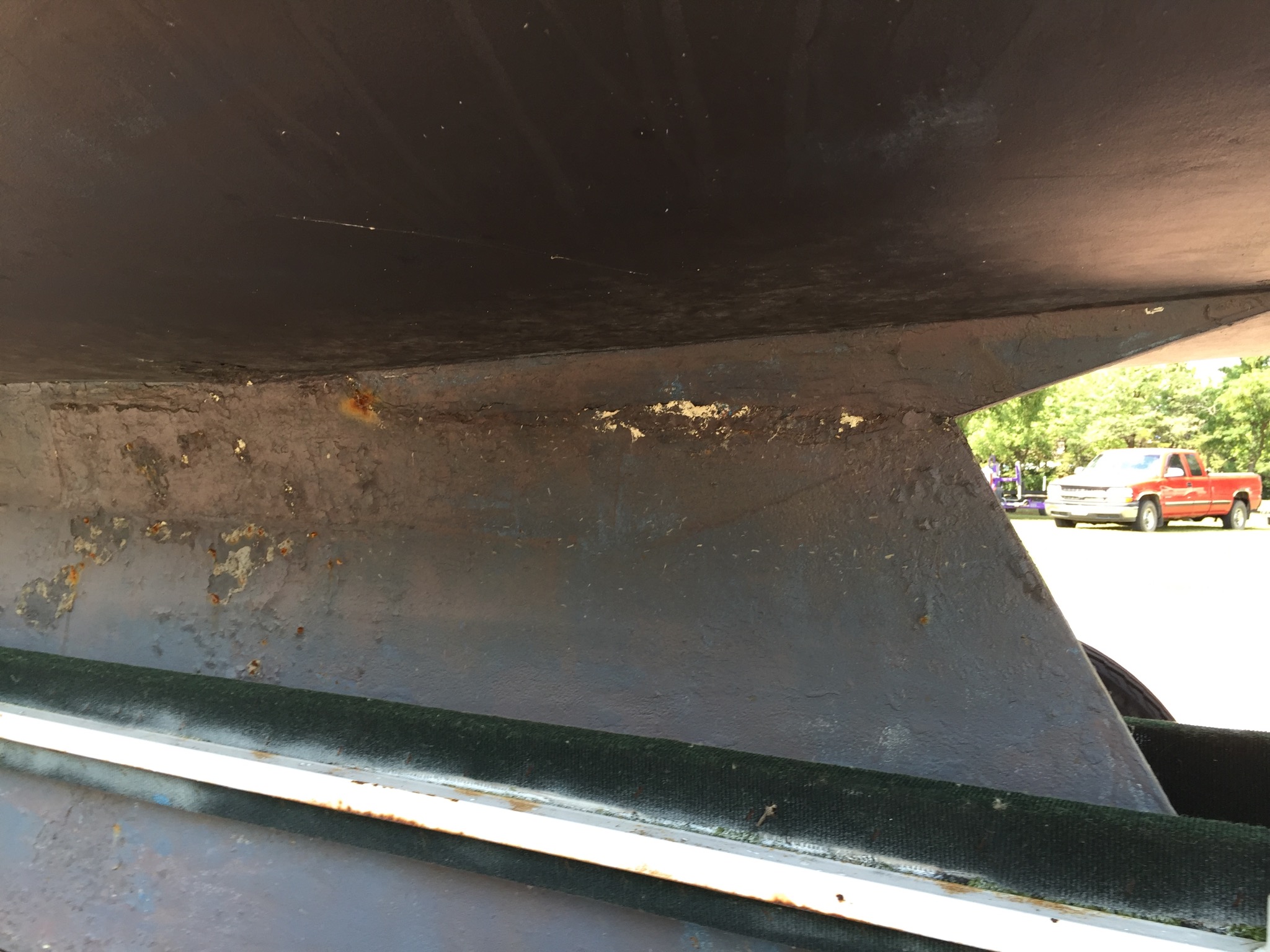

There are some odd straight line cracks in bottom photo. I'm not familiar with that boat/keel, but I'd check those. If owner let's you, scrape paint off those and the "smile" at the front. If lucky, maybe these cracks are just in the paint layers.

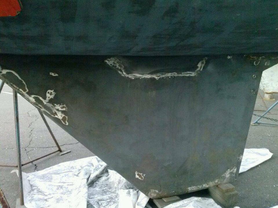

Had the same problem with my 1987 Hunter 31 twice over the last 18 years. The flaring fails along the seam of the iron keel and the hull. Sand, flair, protect and paint.

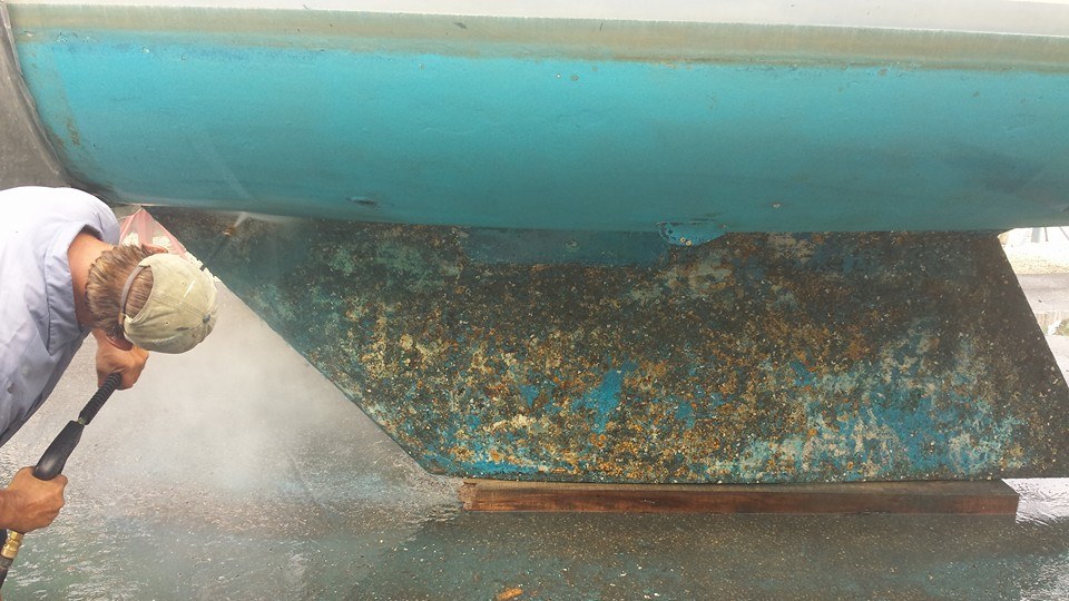

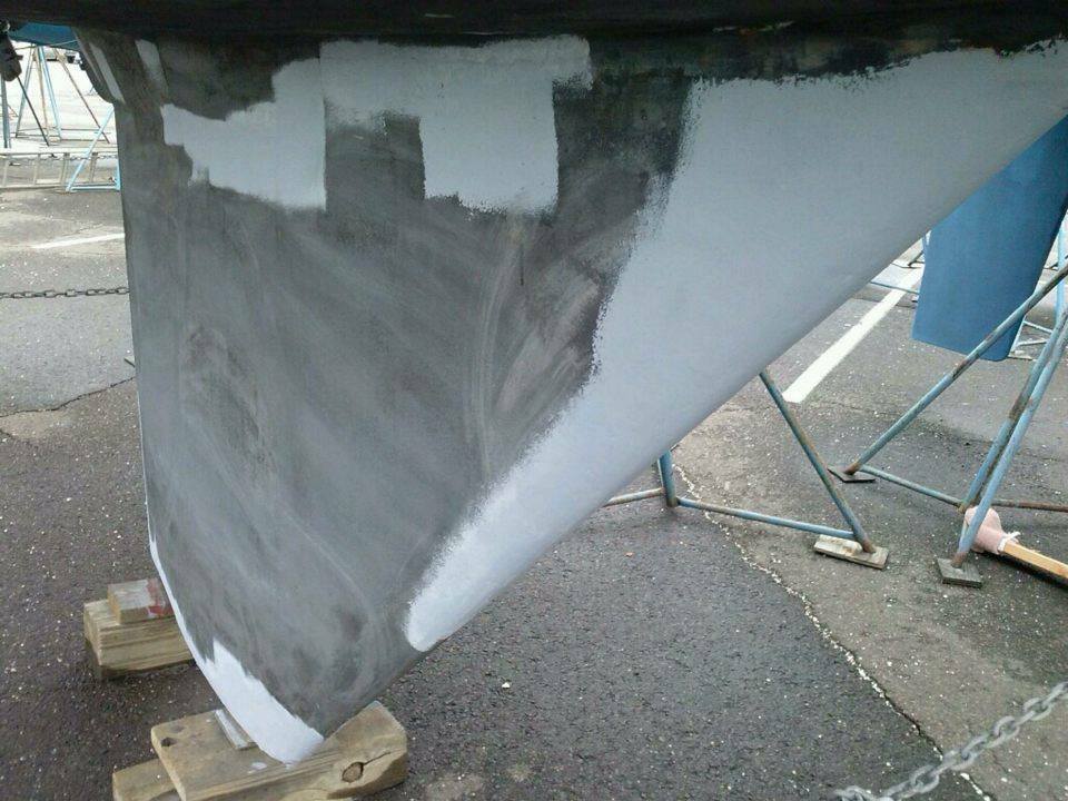

pateco
Aug 12, 2014
2,207

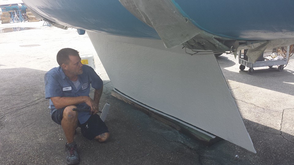

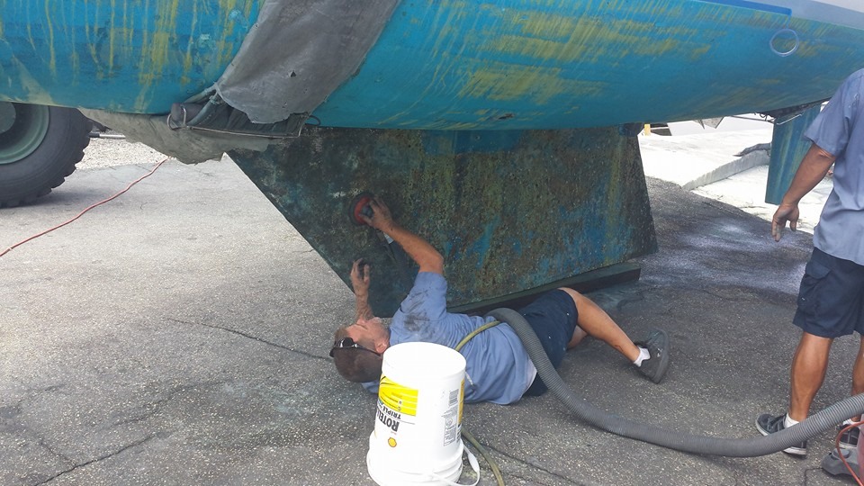

Here are pics of my 1983 H31 after power washing, sanding, and epoxy coating. Luckily I had no smile.
