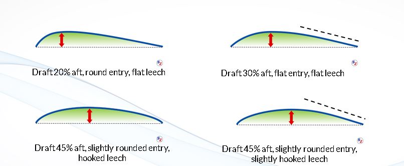

Move sail’s center of effort (sail draft) aft, Increases weather helm.
Easing the outhaul and some halyard tension would give the main a fuller shape Powering UP the Main. Putting more force behind the Mast adding balance to the sails.
Mainsail shapes.
You might continue to adjust the balance if you can reduce the size of your foresail. For example using in a 100% or 95% jib when the wind is up instead of the furled Genoa.
Mainsail shapes.
