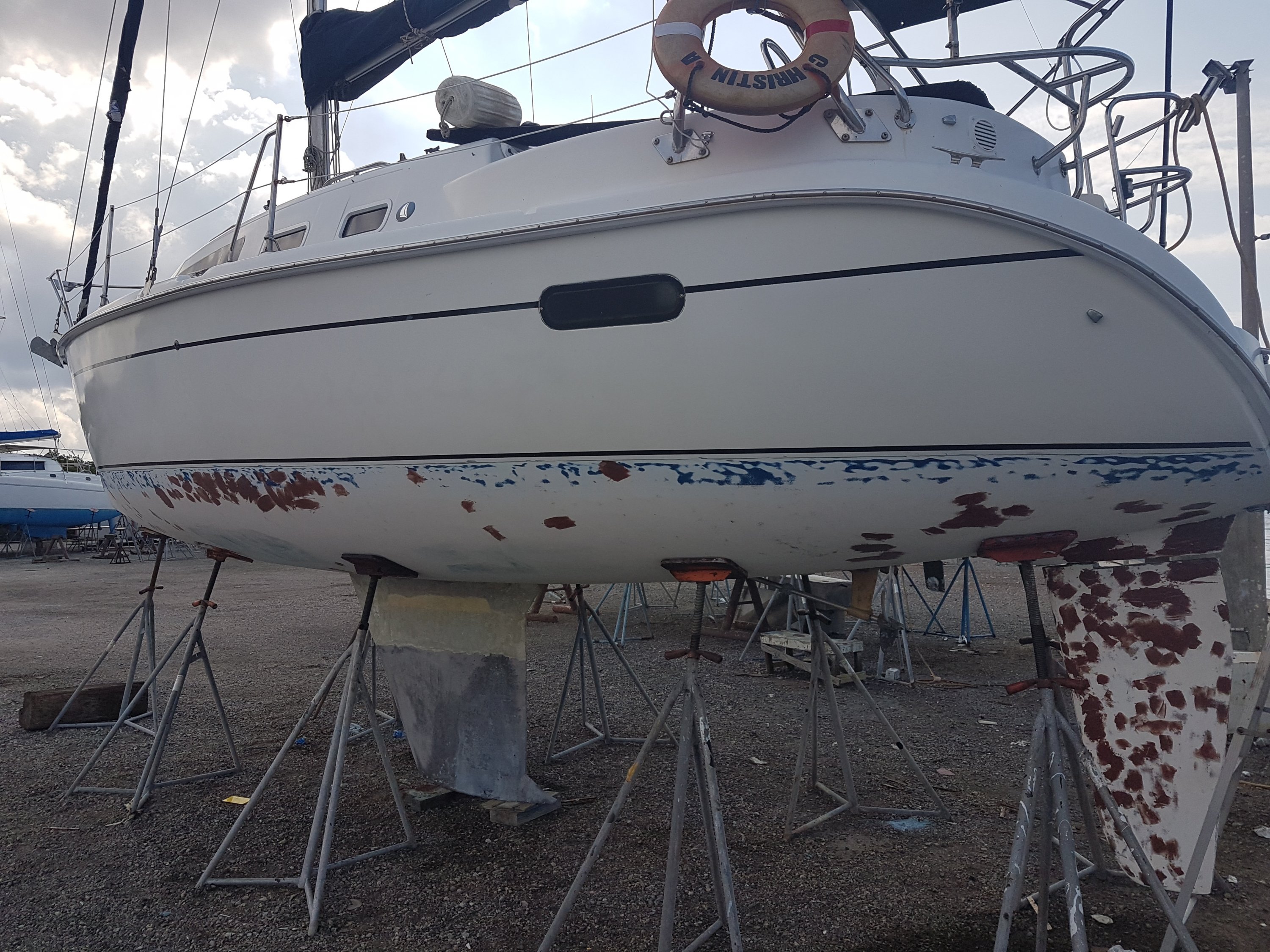

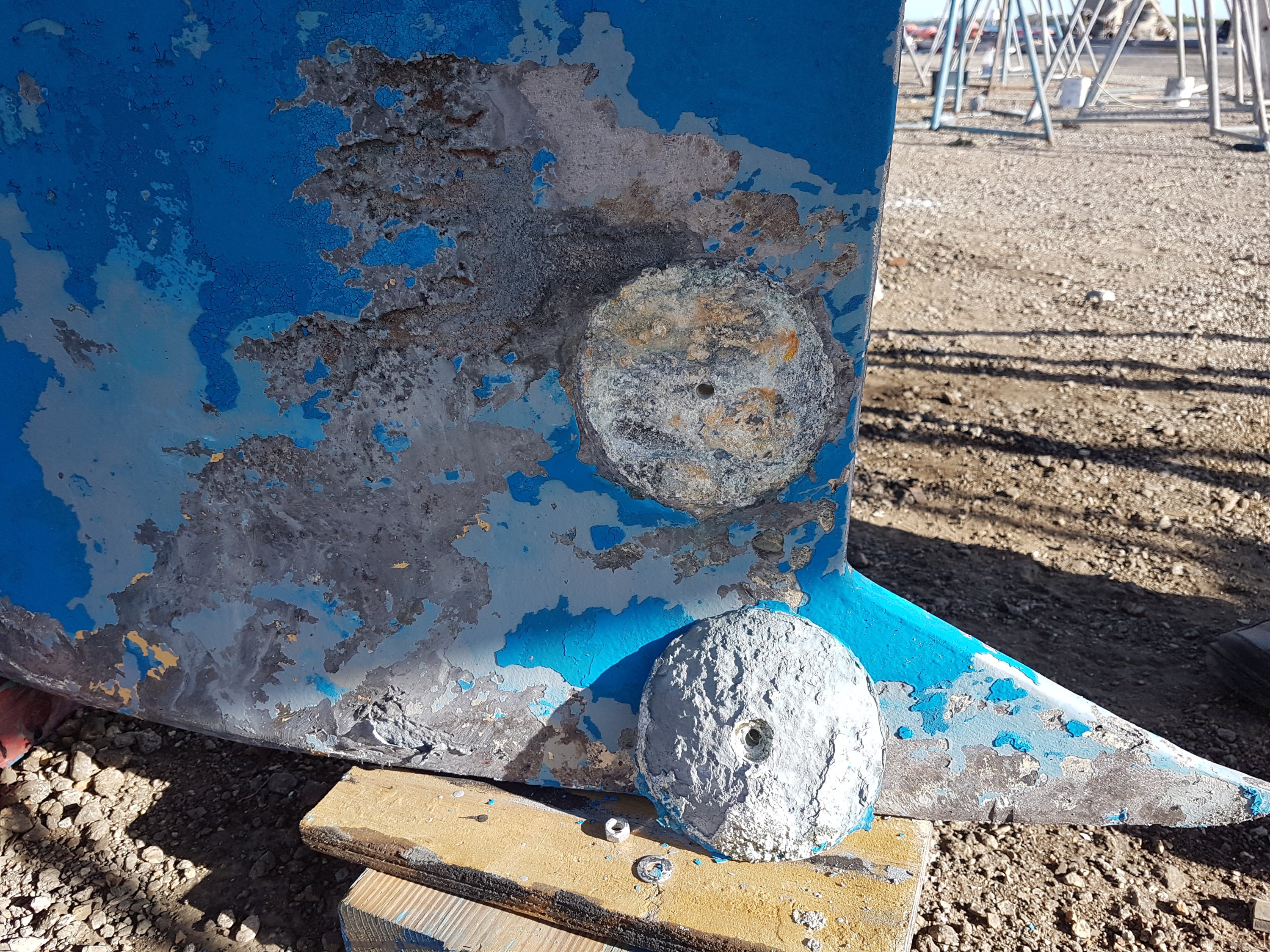

Had a lot of oxidation issues with the keel over the past years (picture shows what it looked like when we hauled her out last month) which were thought to be from possible ground leaks. Looking at the info found it might just have been caused by the zinc placed there.
We also checked the ground leak/stray current on the boat and found to have 3 volts with the switch open and a resistance of 44,540 ohms and 0.15 volts with the switch closed......so negligible current.
We've since soda-blasted the entire hull, we faired the keel with epoxy and will apply at least 5 coats of interlux 200e to create a strong barier before applying seahawk's Islands 44 anti-fowling.
