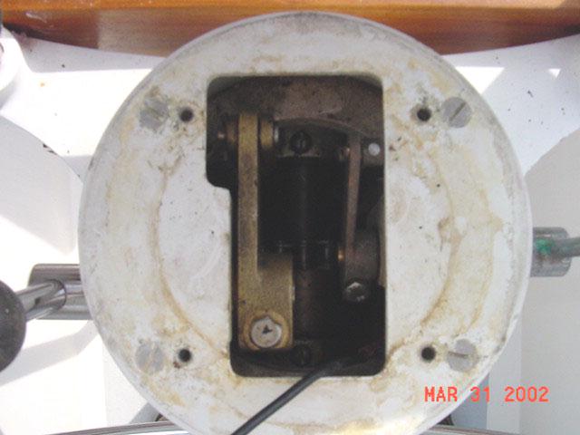

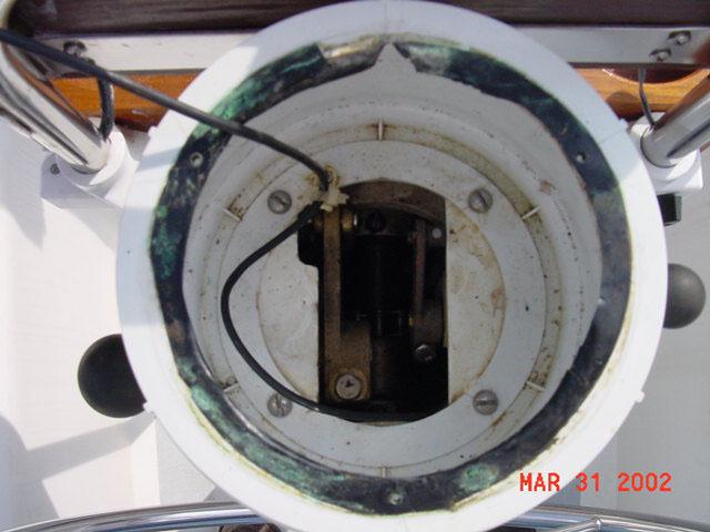

I have Yacht Specialties
My 79 H30 has a Yacht Specialties pedestal. The photos posted also look like a YS. Kevin
