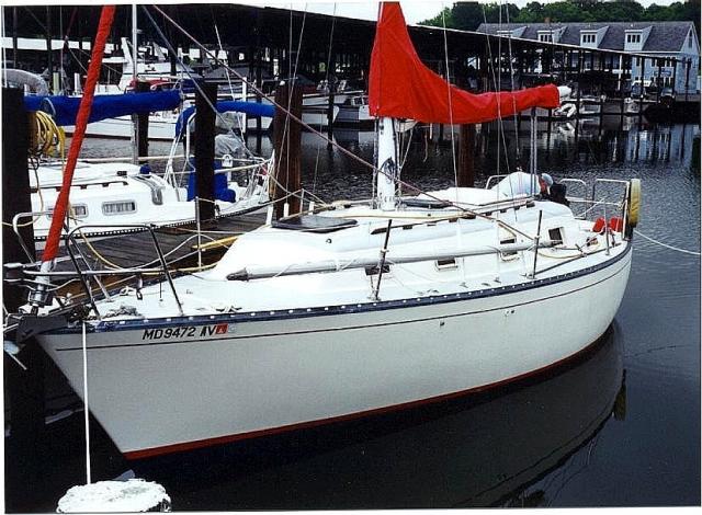

My previous boat was a 1980 H30. I added an anchor roller - Simpson-Lawrence KBR-20. I had to angle it slightly to the left of the stem piece and the port side chock had to be moved slightly aft. I installed a backing plate under the deck. I had to remove the left side jib reef hook to get the anchor roller close to the stem piece - just sawed it off. The space on the deck forward of the anchor locker and just aft of the black stem trim plate is 5" long and 6" wide so there was plenty of room to accomodate the new roller. It was a great addition to my boat. .

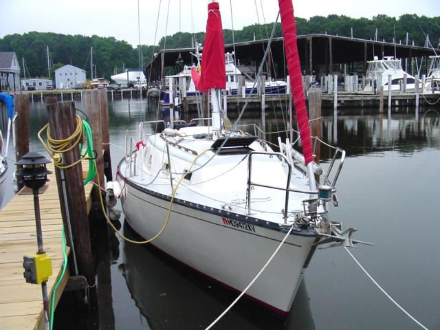

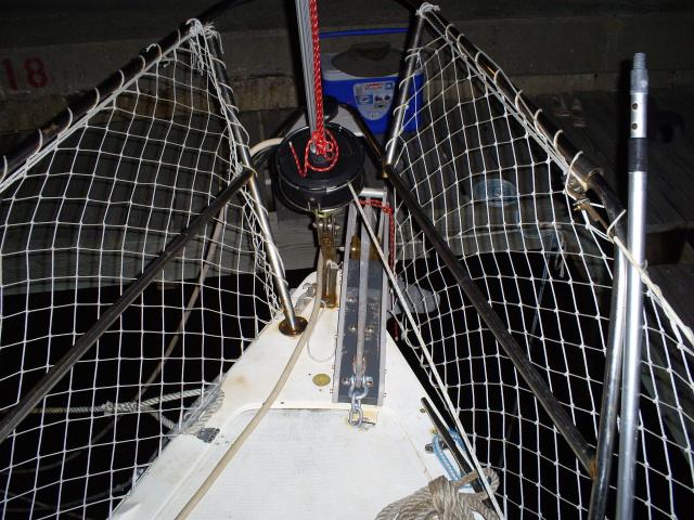

I had the idea that the chain would be scraping across the deck so I wanted a bow roller to cover to the locker. I wanted to be able to kick the anchor out and not have to worry about it scraping my new paint job(which I haven't done yet).
I did not have the room either for a deck mounted roller. If you don't you are just going to have to move some stuff around. As you can see, I only moved one cleat, the port side is still what came on the boat. I just haven't got around to it yet.
I had to cut one of the support poles for the bow rail. I guess what I would recommend is keep it as close to what it is now. I love to anchor out now that I have a roller that it is easy to retrieve the ground tackle.
