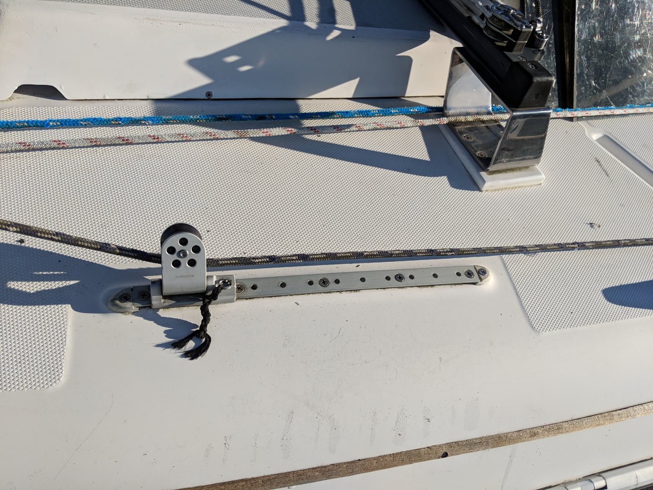

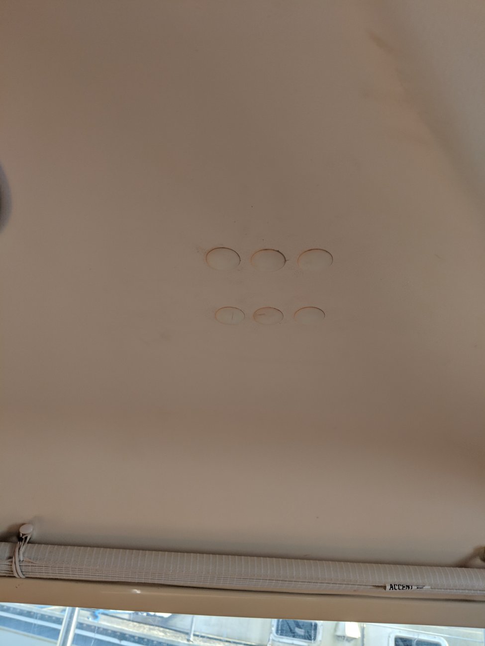

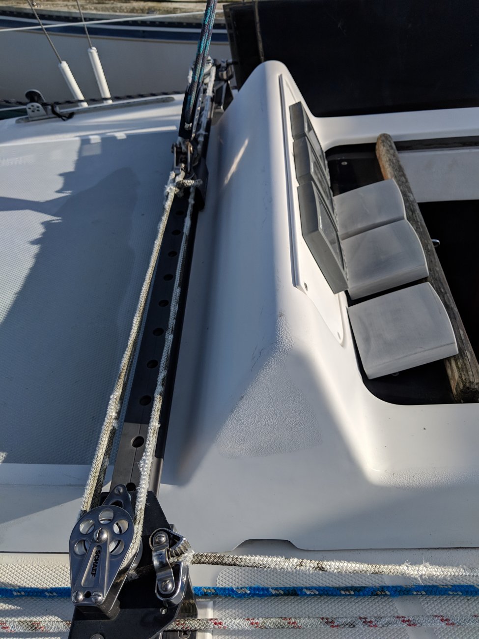

There is a traveler on top of the cabin in a logical place. I've attached pictures. The second one shows the attachment point in the upper right. The attachment points are accessed through the cabin upholstery with color-matched plugs (picture attached), which makes me think it was either an uncommon factory option or a well done modification. There was no visible fiberglass repair, but I'll get some better pictures.
Just as a note, they removed the topping lift when they installed the rigid boom, which seems fine.

Factory installed. That answers my response the 290 was shipped w/o an arch.
