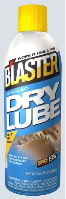

Glad it worked out for you. I keep a can of this in my boat's tool bag.
I'm not endorsing this particular teflon spray, it is just what Walmart had on the shelf. But it is a good idea to keep something like this around. A few times a year, I spray all of my turning blocks, slugs, companion way slides etc. I would also spary the carpet on my trailer bunks. It made the "bump" a lot less dramatic when getting the boat settled for a trailer ride. You are probably not trailering your 280 so not an issue for you.
