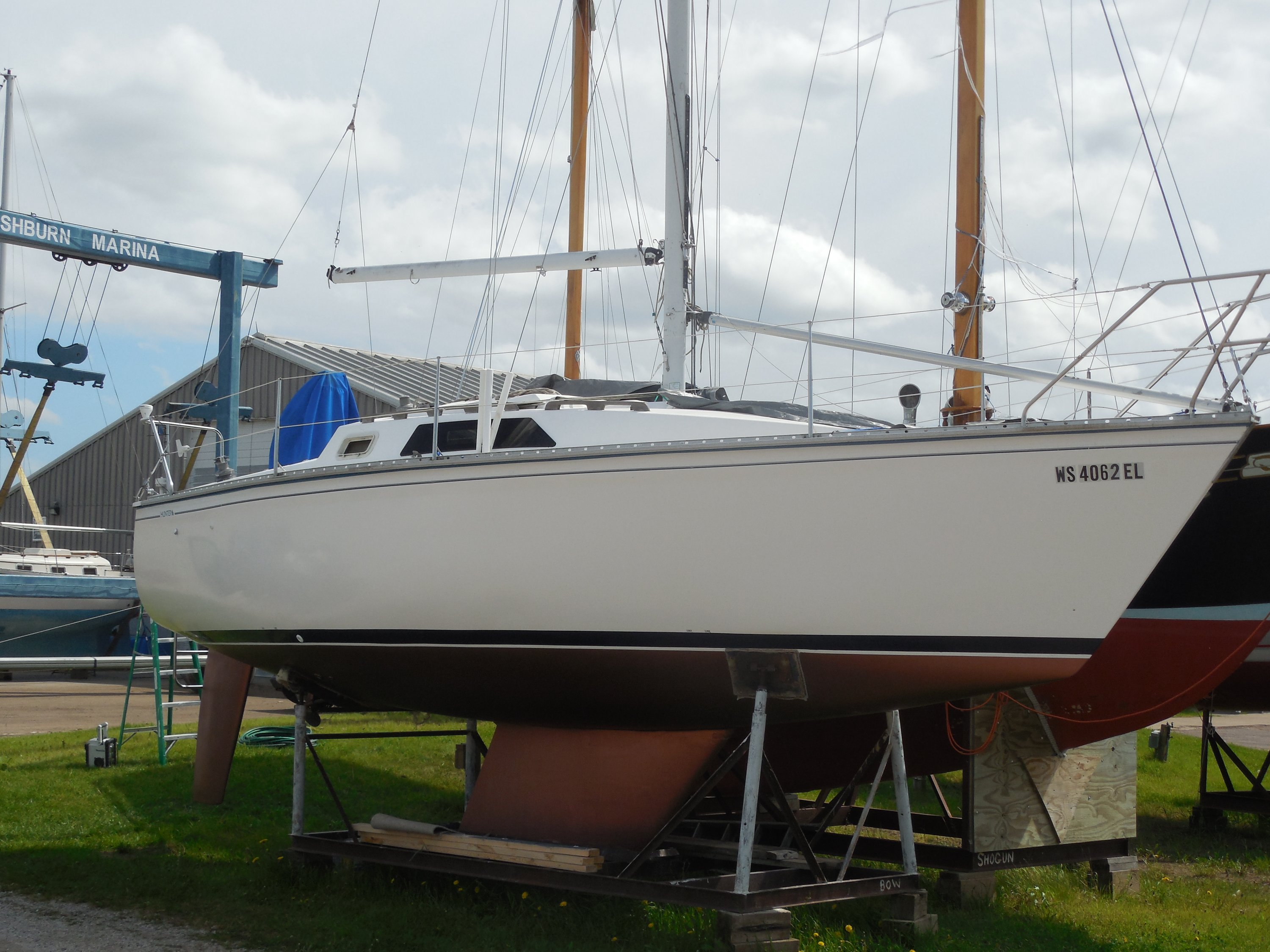

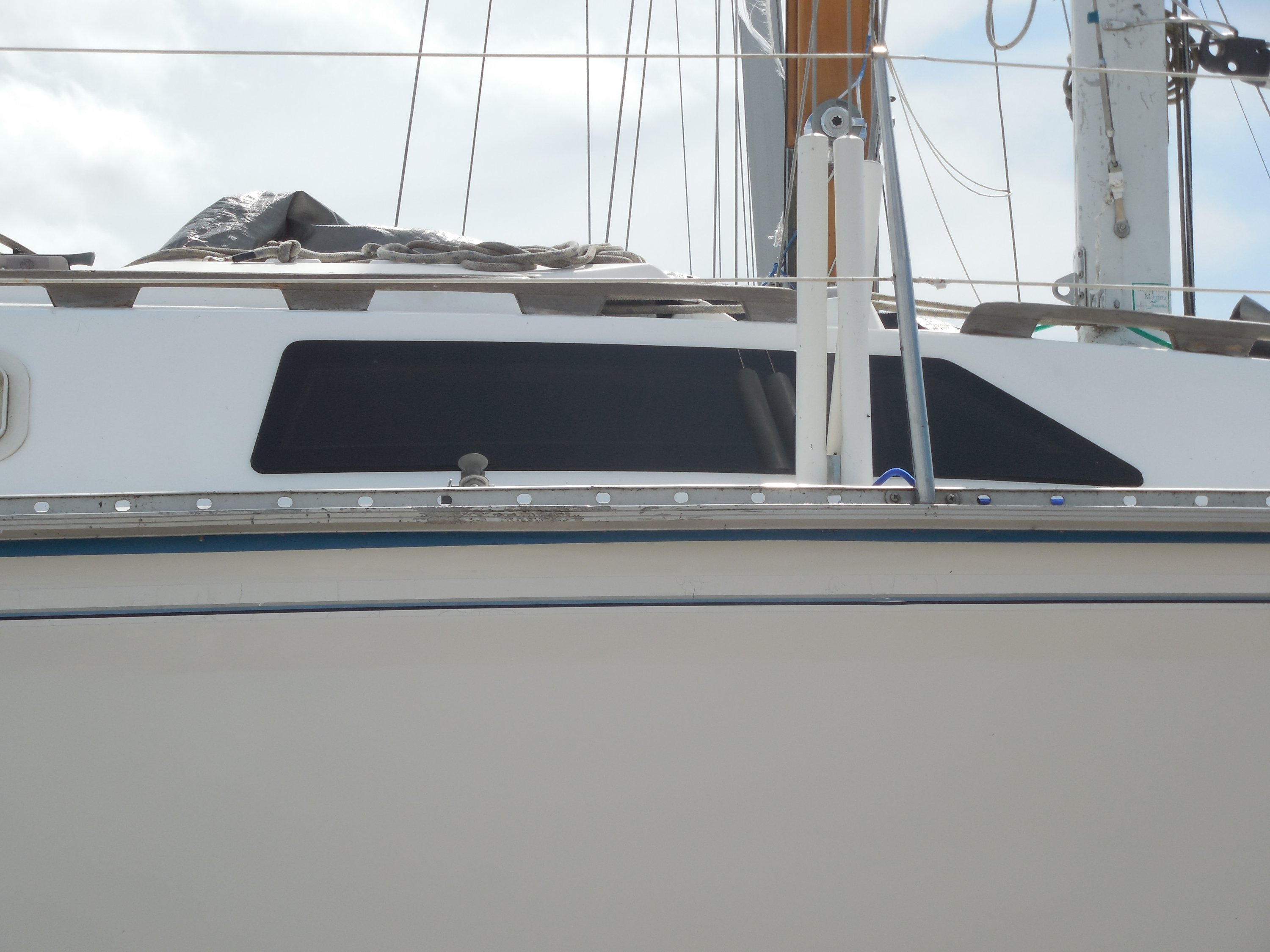

Steve, I replaced my trapazoid windows last year and they look fabulous. I had Mark Plastics in CA cut me new ones. I measured the old ones and added 1/2 inch all around as to cover the part of the opening that wouldn't clean up. I think the bigger windows look better anyway. Then I used 3m vhb tape to hold them in place sealed with Dow 795. There is much discussion on the forum of this method. The windows look great and make my boat look 10 years newer IMHO.

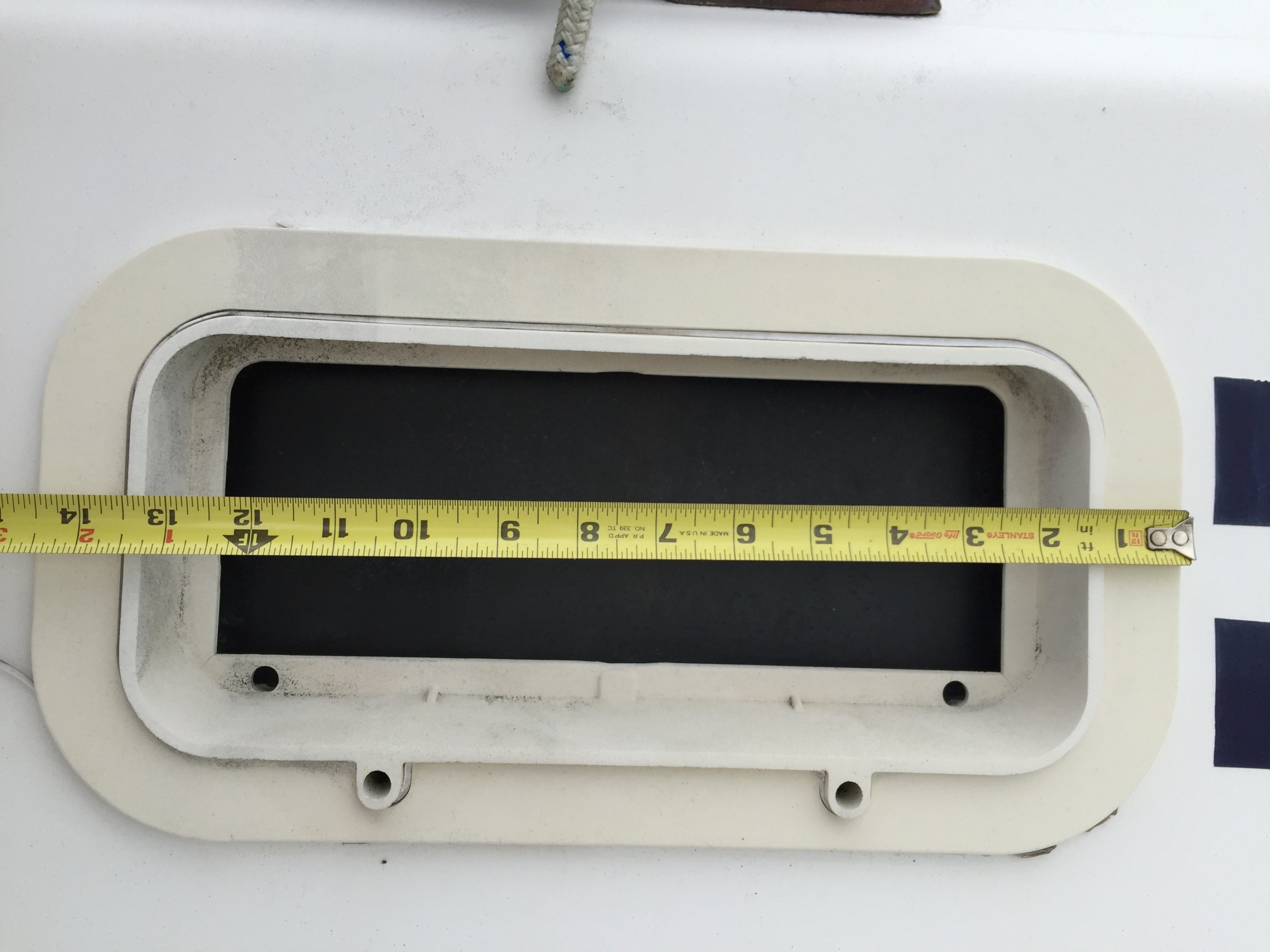

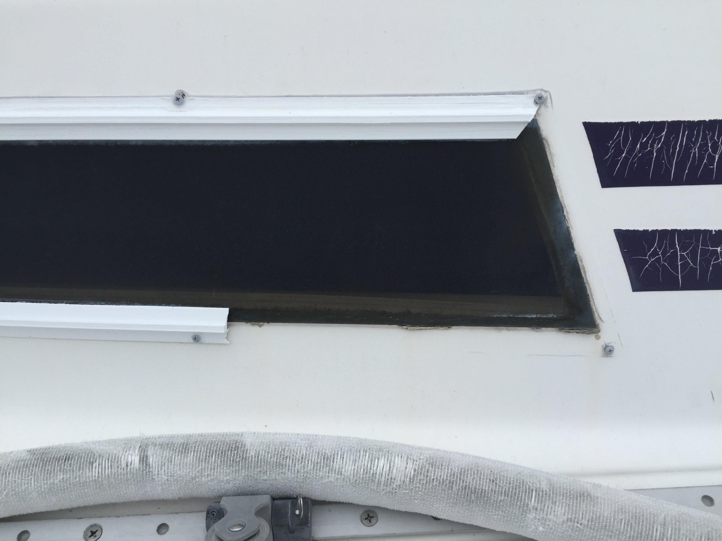

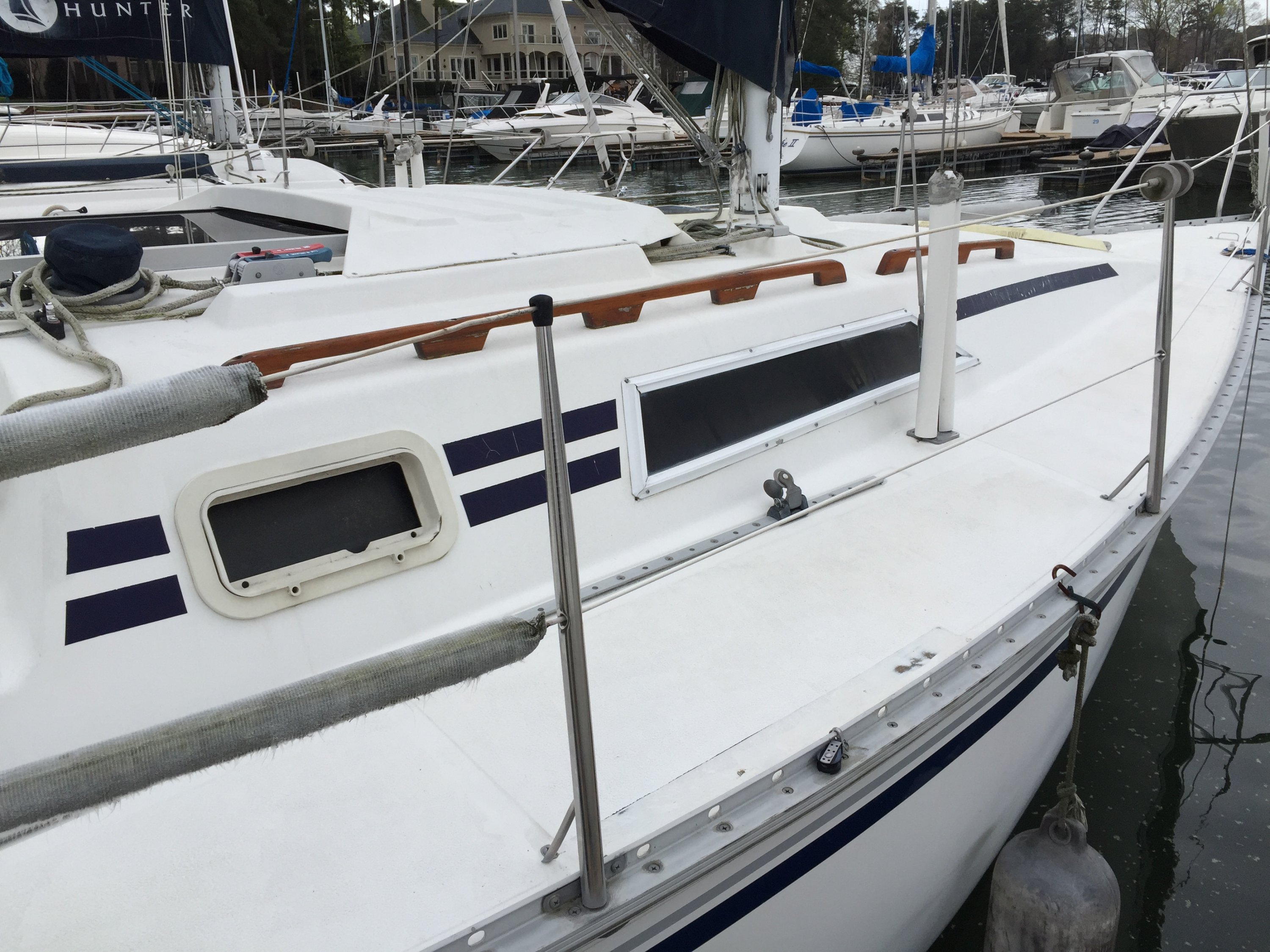

Hi Jeff. Thanks for the offer. Photos attached. I'm trying to find drop in ALUMINUM replacement portlight hatches AND some photos of the trapezoidal main cabin windows being replaced without the white plastic frames.
For the portlights, I'm having trouble finding a product that's lighter duty since I'm on an inland lake and don't require bluewater heft and construction along with the expense.

Jeff, those windows look first rate! If you didn't tell me otherwise I would say they were OEM factory installed. I have seen a couple local boat owners that have done something similar but they used screws to attach them. That method just looks like a DIY hack job..........IMHO of course.
Nice job, really nice job!

Thanks Craig. I wish I could find some more close up shots. Mark Plastics did a very nice job of cutting the windows for me. If you notice, all the corners have a smooth radius cut and he put a bevel around the outside. That really gives it a nice finished look after I sealed it with Dow 795. I thought about using screws, but since I don't sail off-shore, I decided to use the VHB tape to hold it in place. No regrets yet. :biggrin:
