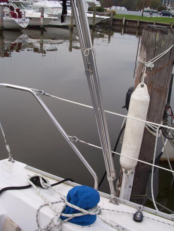

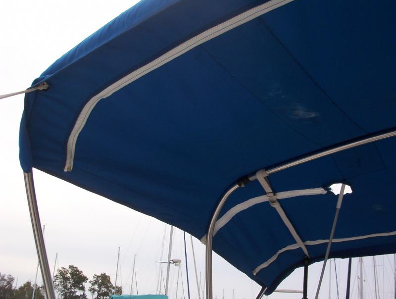

The bimini frames on my '86 H28.5 were secured to the deck coaming just aft of the winches. Like Stu, I had the main leech reduced a few inches to clear the deployed bimini and I had standing headroom under it.

Thanks Warren and Stu: If you have any pictures kicking around and if it is not too much of an inconvenience, I sure would like to see them, if not for anything else, to evaluate the pros and cons of deck vs rail mounting and if they can fold back or is that prevented by the double backstay? Very much obliged in advance. (Weather update: can see parts of the driveway now but not the lawn!)

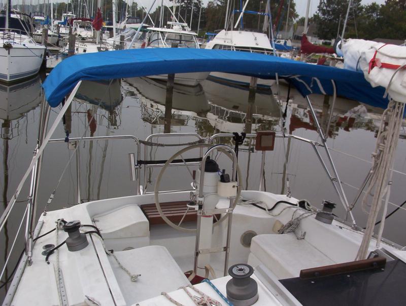

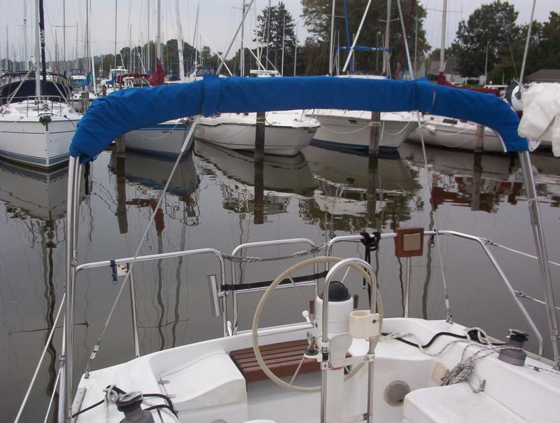

That is terrific Warren. Thank you very much. That is a great help. Definitely a picture (or pictures) being worth a thousand words. I can't tell but does it have the means to 'fold' back, towards the backstays and how much forward does it go. I have a dodger installed and the company provides a 'joiner' to connect the bimini with the dodger when the mainsheet / traveller is not being used (ie: anchored or at the dock.)
As an aside, your toerails seem to be the reverse of mine. That is, mine are through bolted on the other side (inside) where yours appear to be on the outside.??
Thanks again.Ontario Guy

When not opened, my bimini folded up against the twin backstays (one bow aft and two forward of the stays). When open, the bimini would reach forward to a within a few inches of the mainsheet gear. Yes, the toerail on my boat was bolted on the outboard side of it. My boat is an '86, what is yours?

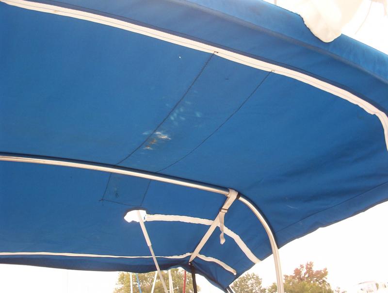

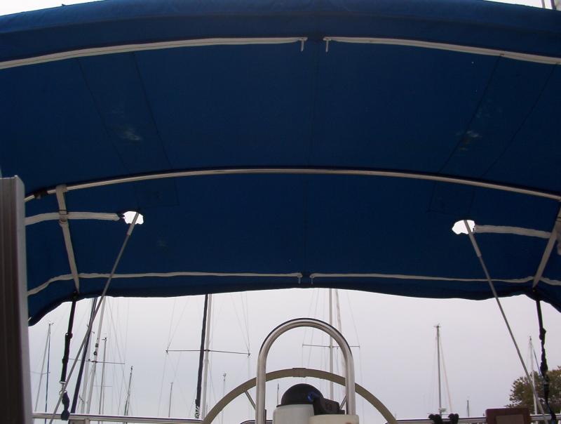

Two more great pictures and more information re the folding of it. Many thanks again Warren. Collectively I think that I have enough to take to Genco (the bimini company in Toronto) as soon as I can get on the boat to take specific measurements.
