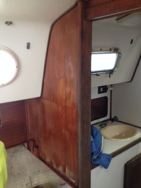

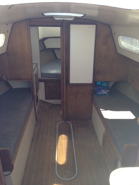

After lots of cleaning she is starting to take shape. We two part teak cleaned everything inside and my girlfriend made the cushions. Next is a satin finish on the wood.

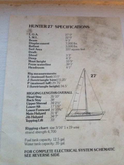

Also, we found the original spec sheet int he boat. It is attached too.

Yes, seeing progress makes it worth it....
