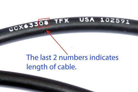

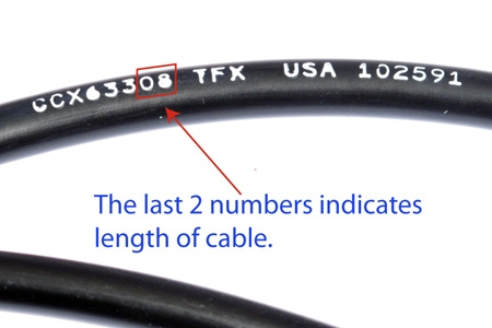

Dear Hunter experts,
My gear control cable suddenly got sticky after the marina made a service on my boat.
Not sure what happened but from one day to the other it was not possible too engage reverse.
I have inspected the cable and it sticks when pulled back to the last centimeter.
A new cable is needed but did not have time to measure the old one.
Does anyone know the right length of the gear control cable?
Would like to order one before I go back to the boat next time
Any good tips for a pain free replacement?
Thanks
May 19, 2020
85
Hunter 30-2 Quincy
I have not had to replace mine so I'm not certain but I believe I read somewhere that each cable has the length and/or model number stamped on one or both of the ends. Maybe start there?

The BuildList says they are both 18ft, any common 3300 control cable, we offer TFXtreme:
SeaStar Solutions 3300CC TFXtreme Hi-Perf. Universal Control Cables
