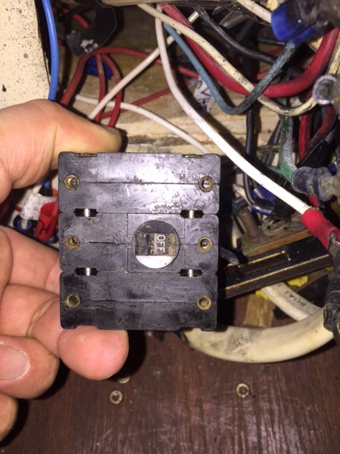

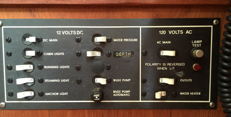

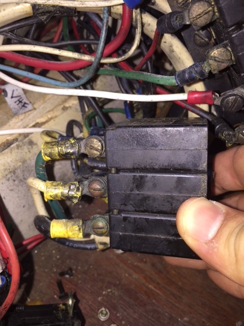

These are images of what Im working with, I've inherited quite a mess. I am unaware of any fuses that exist after the breakers, so I will be using the new breakers for there intended purposes, and not just as a switch. I will do an audit of all the components to determine the appropriate amperage that the breakers should be.

Yes, those are standard marine breakers. The photo you sent is an "A Series" magnetic marine circuit breaker from Carling. This is rated to also be used also as a switch. They have them at our local marina new and West Marine.
You size the breaker based on the smallest wire hooked to it. Generally speaking this type of breaker is used to protect the wire from starting a fire because of overheating because of too much current being drawn through for its size. Smaller the wire smaller the amps, bigger the wire bigger the allowed amps.
You can look it up on a chart but most people use 15 amp with 16 gauge wire. You can use bigger breaker on this size, but, 15 is big enough for most people.
Seems logical that your don't want to be at sea with a boat on fire because something shorted out and the breaker did not snap open before the wire overheated. Then again, it would also seem logical you don't want to be at sea on a boat on fire for any other reason either.. <grin>
But most electronics have a fuse or circuit breaker on the device to protect that device. It is up to you to protect your wiring to the device so it does not smoke..
These are superior and worth the investment for the extra quality they offer.

If i can pose one more question on the subject, as the two of you are a wealth of knowledge. The shore power breaker is three pole, where as most of the literature i come across talks about two pole breakers. In fact i haven't come across any talk of three pole at all. Should I stick with a three pole, and whats the reason for one over the other.
Sep 3, 2012
195
Hunter 285 Grand Rivers Ky
Yes, if a three pole was used before use it again with your new installation.
Why use a three pole for single phase shore power? in short, I believe you use a three pole to totally isolate the ship from all three wires of single phase shore power when turned off. This is for a number of reasons including safety from stray leakage currents on the neutral and ground lines coming from faulty shore power sources. It was explained to me that generally, you only use single pole breakers for your DC equipment on ship/boat between battery and equipment. Another reason most people only use single pole for your DC breakers is that double or triple pole breakers are too wide to fit in the panel.
I have seen double pole breakers on the AC power lines, again AC is a bit different safety wise. It isolates the whole appliance when turned off.
Also Remember, use only marine grade wire throw away old automotive wire previously used.
Good books you have, read them carefully and completely. When in doubt, seek the advice of a marine electrical engineer or experienced marine surveyor.
