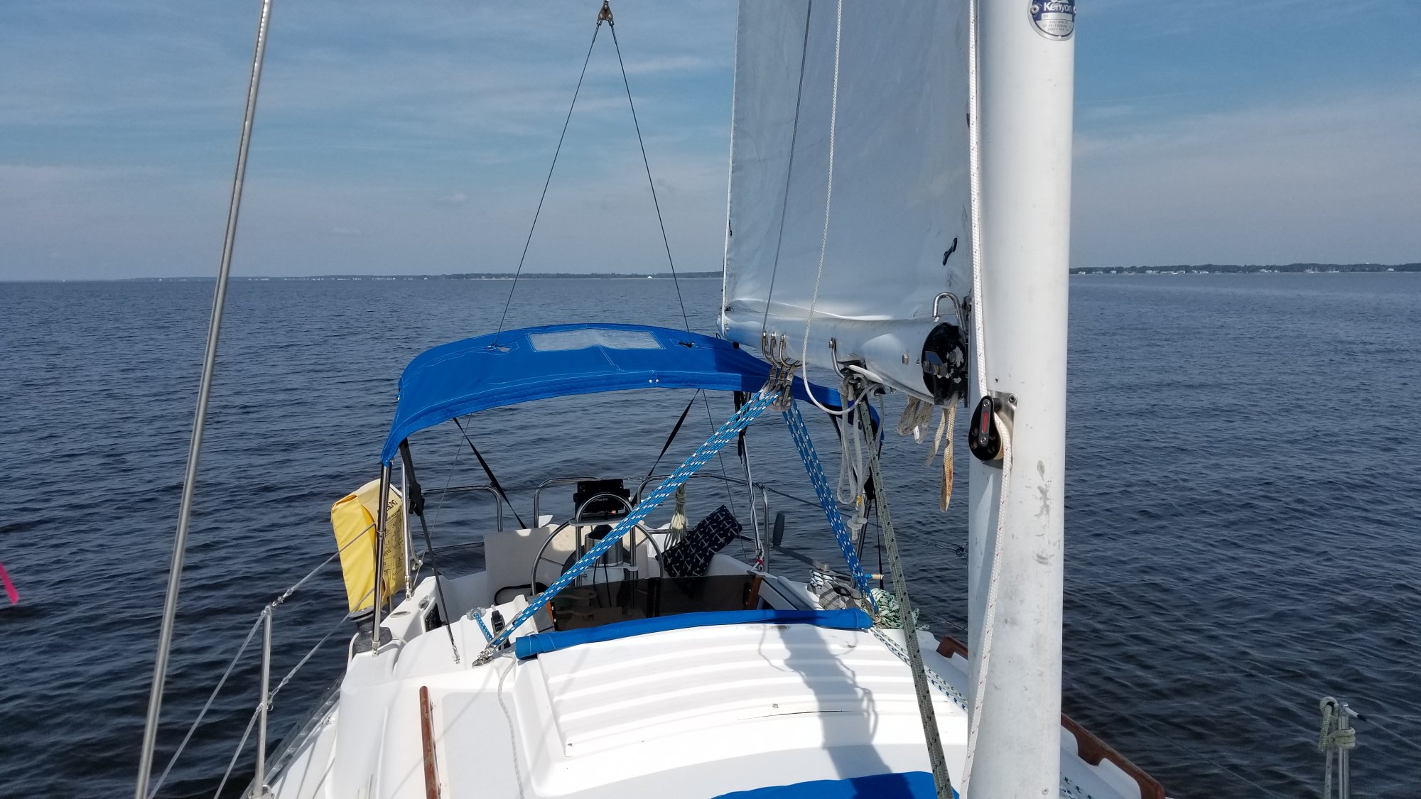

The Bimini was on the boat when I bought it. It is a simple design with few fittings, so a canvas shop should be able make one for you fairly easily. It wont be cheap. One inch stainless steel tubing is about $5 a foot and Sunbrella canvas about $23 a yard. I would suggest having a canvas shop fabricator coming to your boat and getting an estimate.
