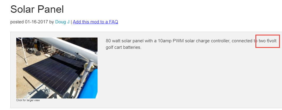

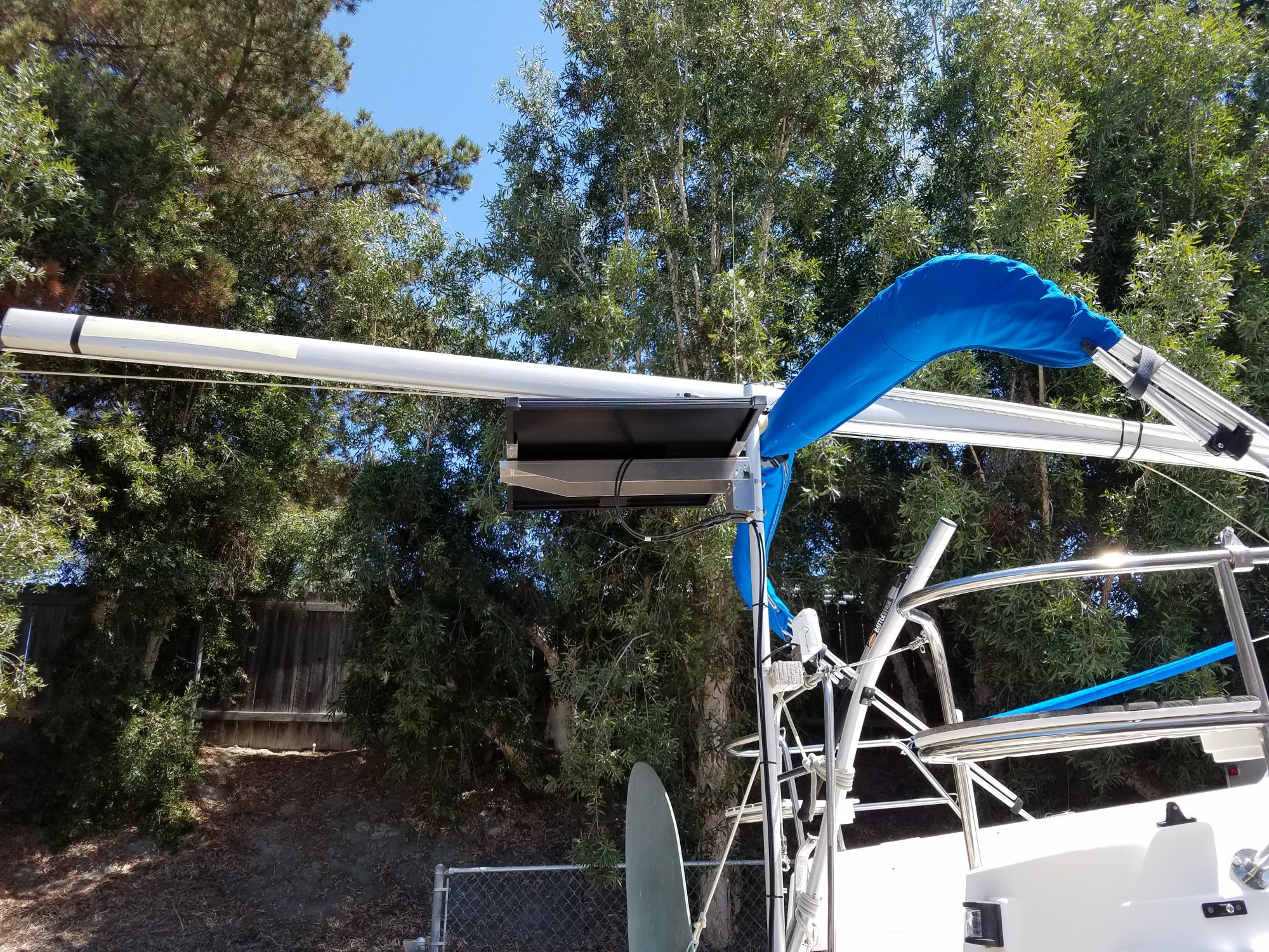

I have a 80 watt panel mounted on the mast crutch pole. It is easily removed, but I leave it on while sailing.
Here's a link to this mod posted in the mods section. I have since upgraded to a Victron MPPT controller with Bluetooth and Android app to be able to monitor solar on my smartphone. I also installed a Victron BMV 700 with a Bluetooth adapter to monitor the batteries.
Checkout the mod here for more details.
Hunter 26 Owner Modifications and Upgrades

Just what I am looking for. Did this panel, bracket and controller come from Hunter Owners?
Why are you charging Golf Cary Batteries on a Boat?

Good to know, assume they are more , less or the same expense> note your link regarding batteries. You mention 6-Volt batteries, are Sailboat Batteries not 12Volt.
23,168
John, yes, most US sailboat systems are 12V. One puts two 6V batteries in series to make a 12V battery. I suggest you buy Charlie Wing's Boat Electrical Systems book for starters.
Not sure what you mean by Hunter Owners. I sourced the parts myself. Understand that is a mod I did to my boat and posted in the Hunter Owners section of this web site to help others that may be interested in doing something similar to their boat.
Prices vary widely. As Stu mentioned 6v Golf cart batteries are designed to be recharged many more times than a standard deep cycle battery, 6v or 12v. If money was not an issue I would like lithium Ion batteries - even better, which can be discharge to almost zero and recharged many many times. Lead acid batteries can only be discharged to about 50% or damage can result, shortening the life of the batteries. Lithium Ion batteries are about 1/3 of the weight of a lead acid battery. The cost though is much higher. Bottom line, you get what you pay for.
