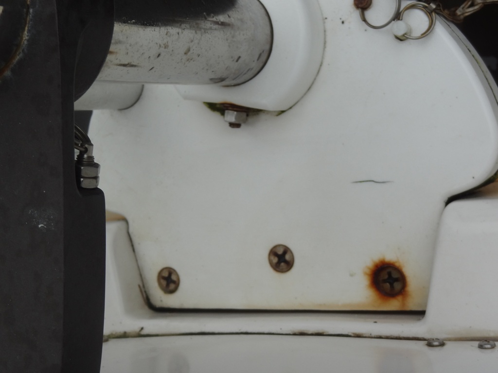

I had a problem with getting water in the boat through one of the bracket screws and had to reseal. The screws go all the way through and can, in the case you describe, be secured by washers and nuts on the other end when the aluminium thread is damaged.

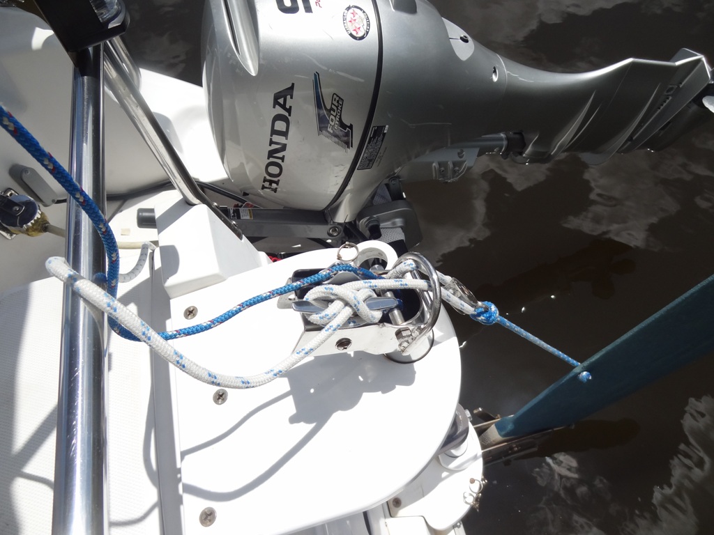

Hope the pictures are good enough. The first picture shows the outside of the upper bracket and the last picture the outside of the upper and lower rudder post brackets.

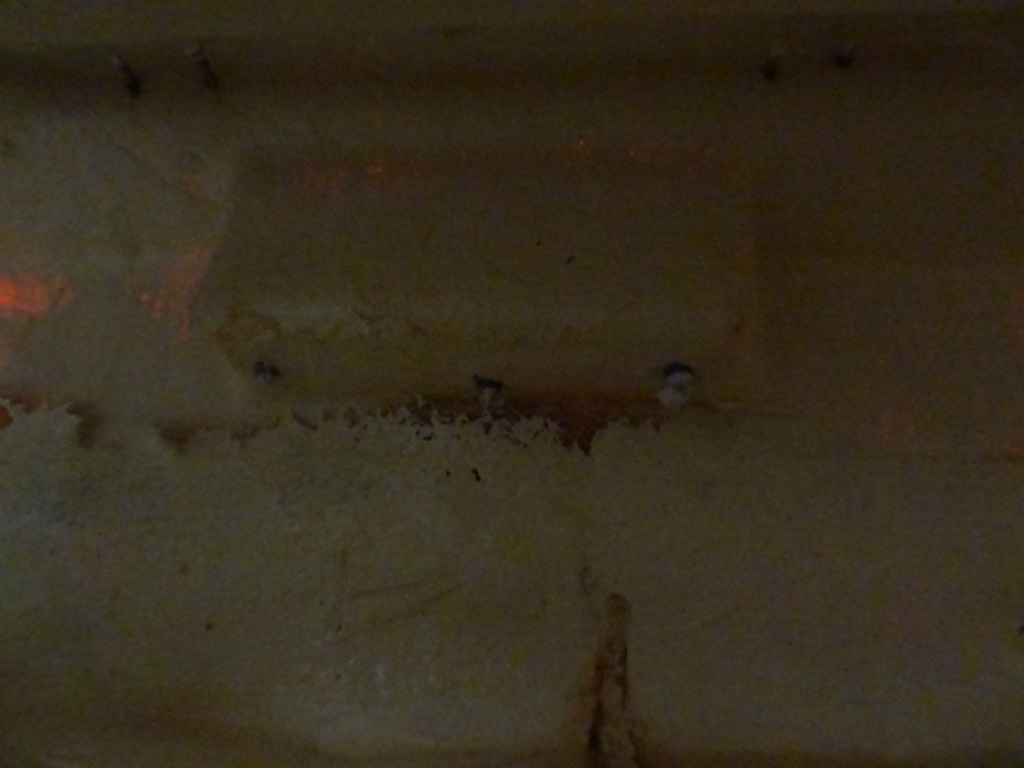

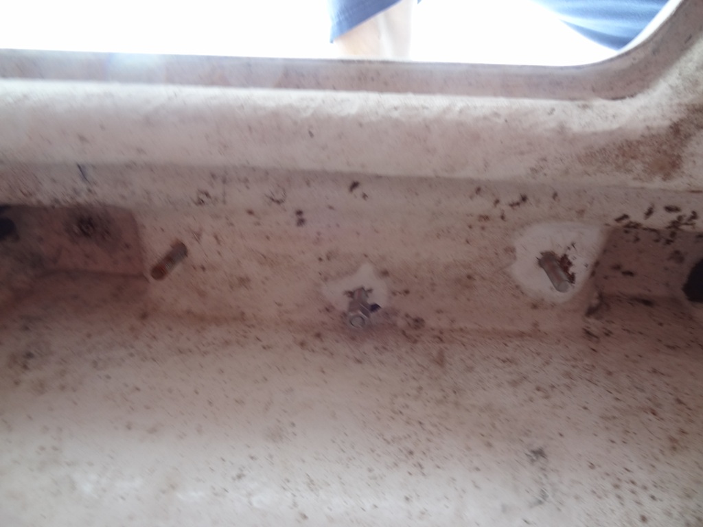

The second picture shows the screws of the upper brake ending in the gasoline cabinet. The third picture is the one you are most interested in, it shows the ends of the screws of the lower bracket, coming out under the cockpit, behind the berth wall.

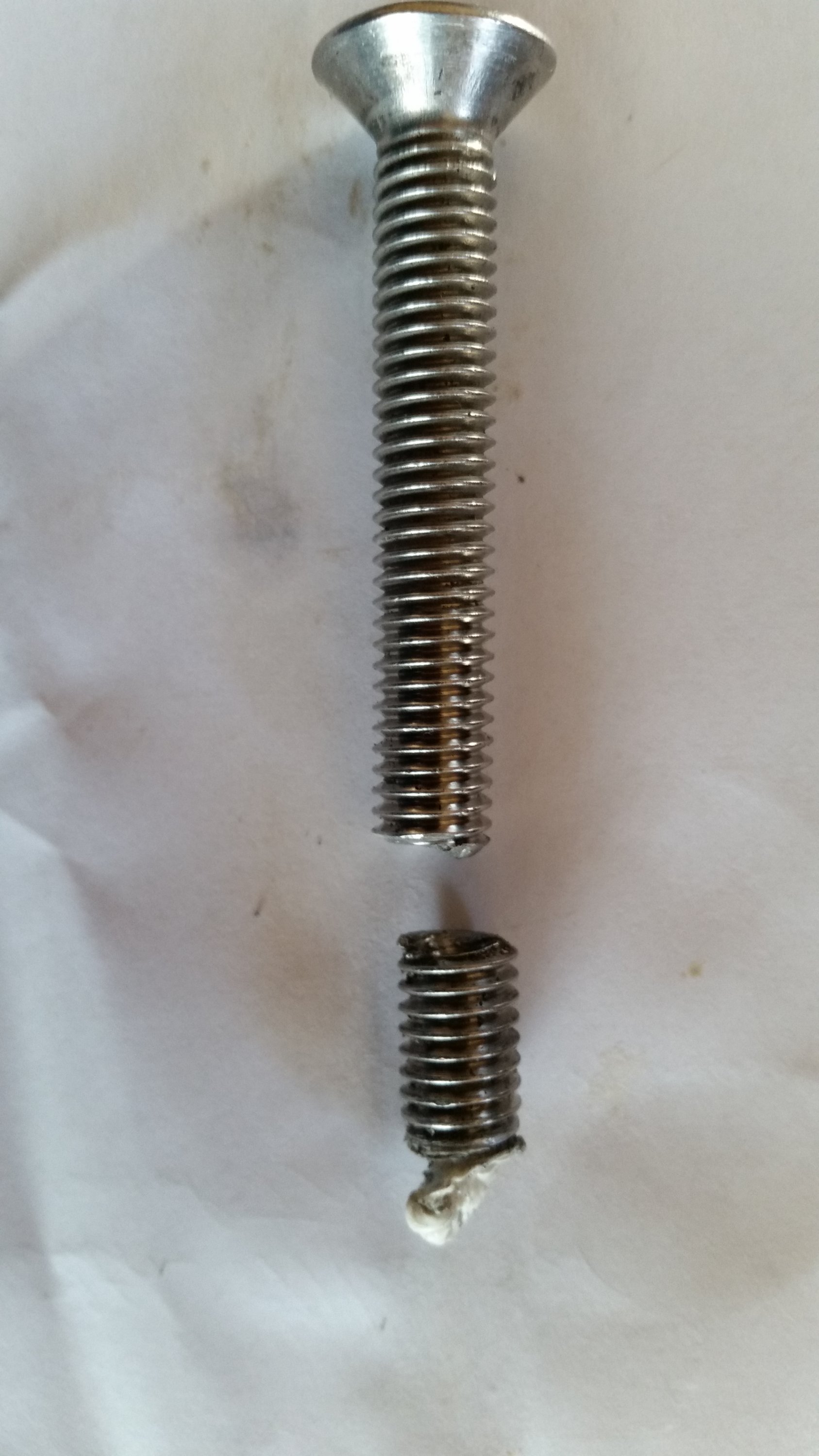

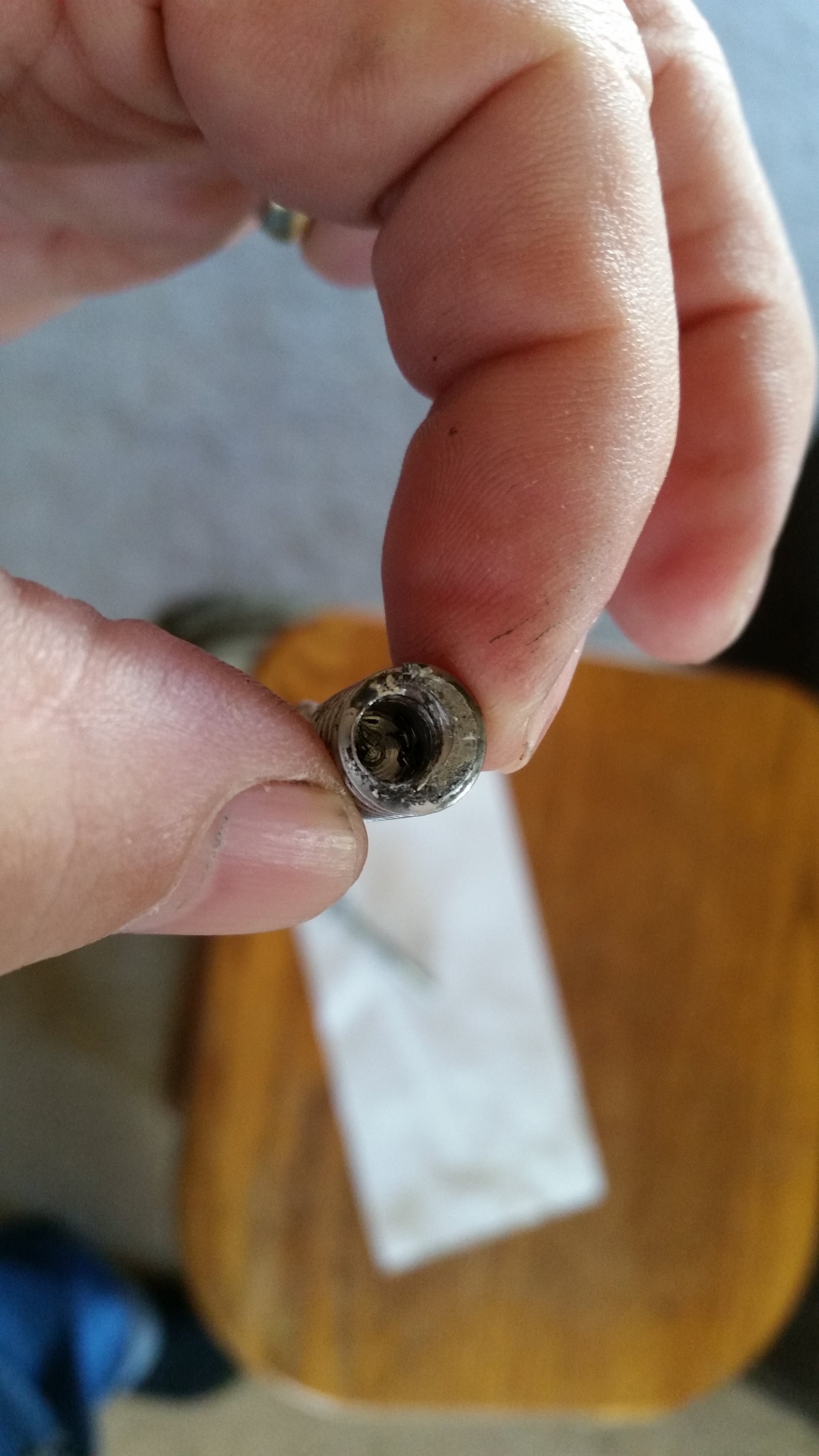

Turned out the bolt (port side on the lower rudder post bracket) was not stripped but broken off 1/2" into the hull below the lower bracket . After taking the rudder post bracket off I used the "Alden 7017P 7pc Extractor Kit" 5/16 bit to remove the end of the bolt which was broken off right at the top of the aluminum plate embedded in the fiberglass.
